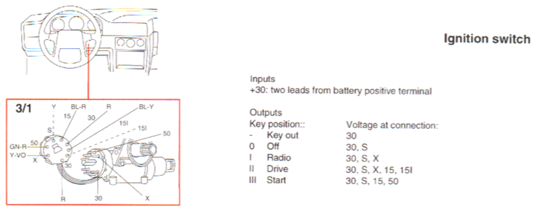

Sounds like you were trying to fix the shifter.
FWIW, the shift lock is connected to the mechanical
portion of the ignition switch, not the electrical.
That's a whole different issue that's covered by
numerous posts in this forum.
But -
When you unplugged the ignition switch,
did you leave the plastic contact retainer
cap on the electrical connector, or did all
of the contacts fall out and come loose?
And if they did get loose, is it possible that
not all of them made it back onto the
right pins? That could cause your
current No Start problem.
Just a thought.

januwan
- Posts: 208
- Joined: 23 May 2006, 22:32
- Year and Model: 97 850 NA 209 K
- Location: SF Bay Area
- Has thanked: 7 times
- Been thanked: 3 times
I think your thought is good. I unplugged the black plastic retainer (on the left side of your diagram) and then unscrewed two screws. When I was removing the ignition switch (the part with pins) it fell apart. The black portion of the switch was separated from the silver housing.
It is too late to check now but tomorrow I will check if there is anything foreign in the retainer cavities.
