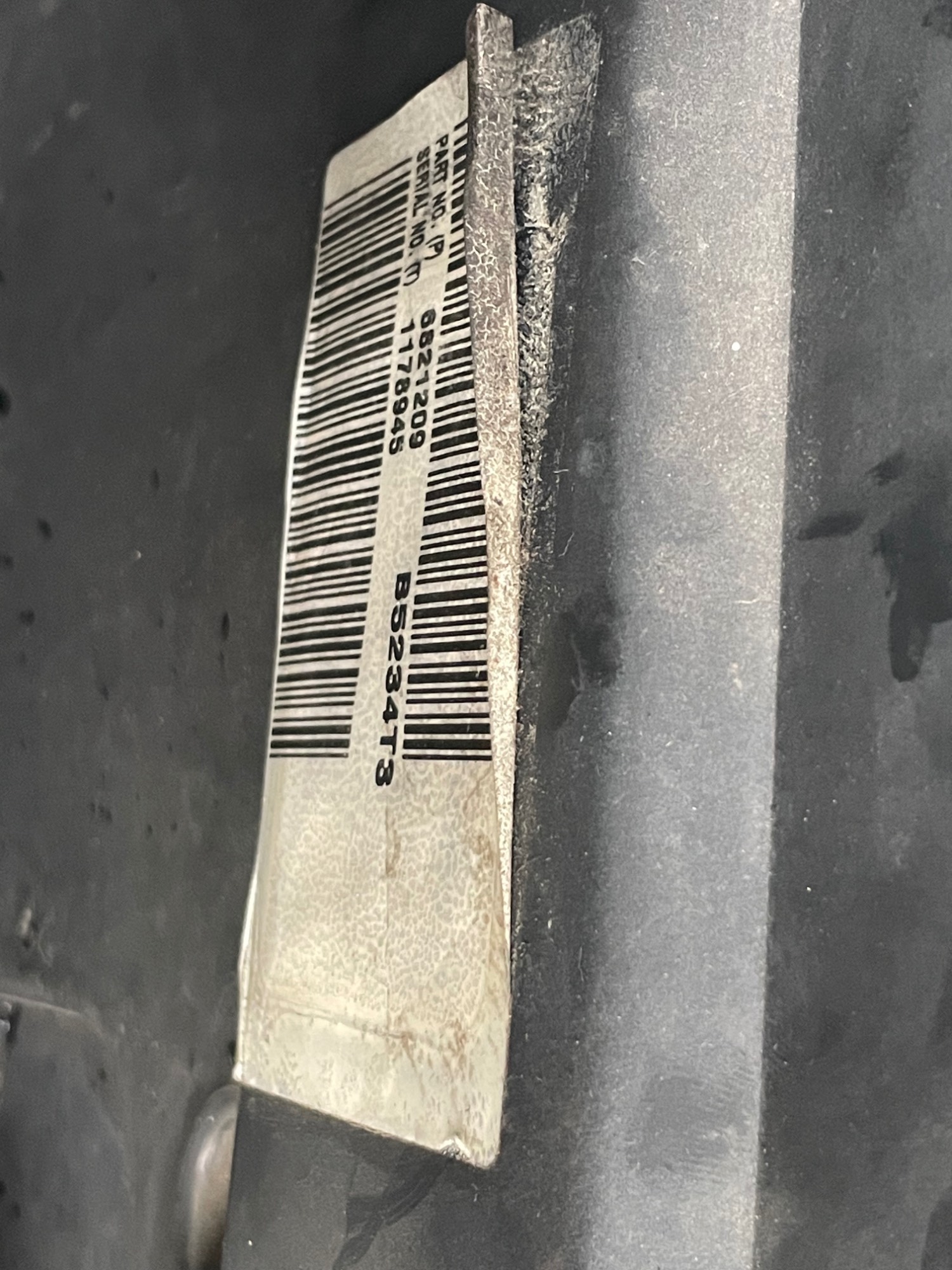

I bought a 1998 T5 SE. it’s automatic 2.3l 176kw.
There are many kits and shops say they don’t have suitable one for my car. So do you know which one should I go? I’m all lost. I live in europe I’m open recommendations from anywhere.
Production date is 10.06.1997
Hydraulic tensioner
Which timing belt to buy for t5 SE B5234T3 ?

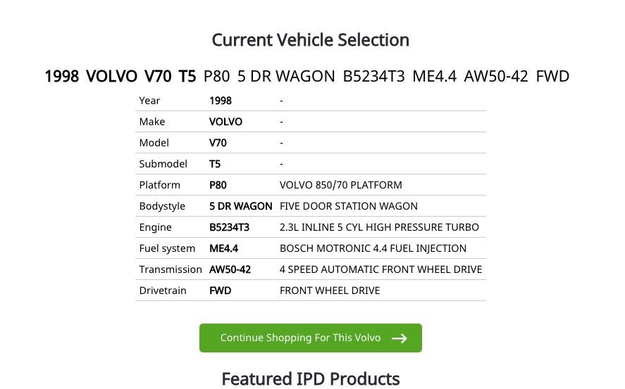

Does this show a page with several options?
https://www.ipdusa.com/Catalog/Index?categorycrumbs=
Or, individual pages...
https://www.ipdusa.com/products/11726/T ... vo-8627484
https://www.ipdusa.com/products/13875/T ... vo-8627484
Get all the bits changed while you're in there...
https://www.ipdusa.com/products/5661/Ti ... arious-Kit
That's showing a 1998 T5 V70.

Yes, Germany to Poland seems like a way better idea, simpler shipping.

Some retailers here show 9180954 to be the part number up to an engine serial number above yours.
