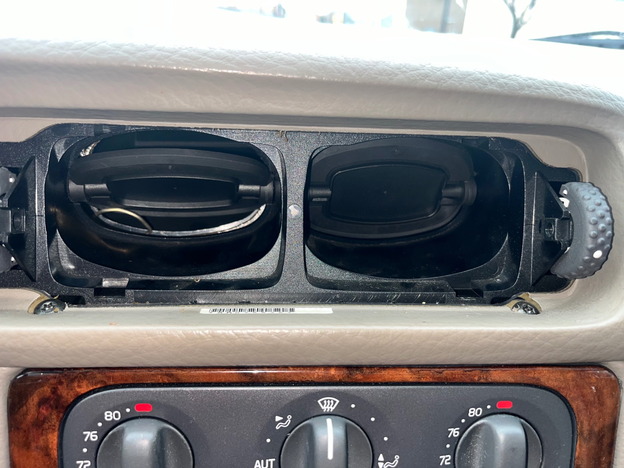

When taking the vents off I noticed there’s this piece of metal sticking up and not allowing the damper to close. Is this also normal and related to the actuator?
1998 s70 exc issues. What’s this metal piece in the duct?

Um, no. I think there is a wire rod that works on the roller wheel to the left of those 2 air vents. Thinking again I think that is plastic not wire. So no, should not be in there. Maybe someone has tried to use a coat hanger or piece of wire to fish something out that vent? That should not affect the operation of the system.
