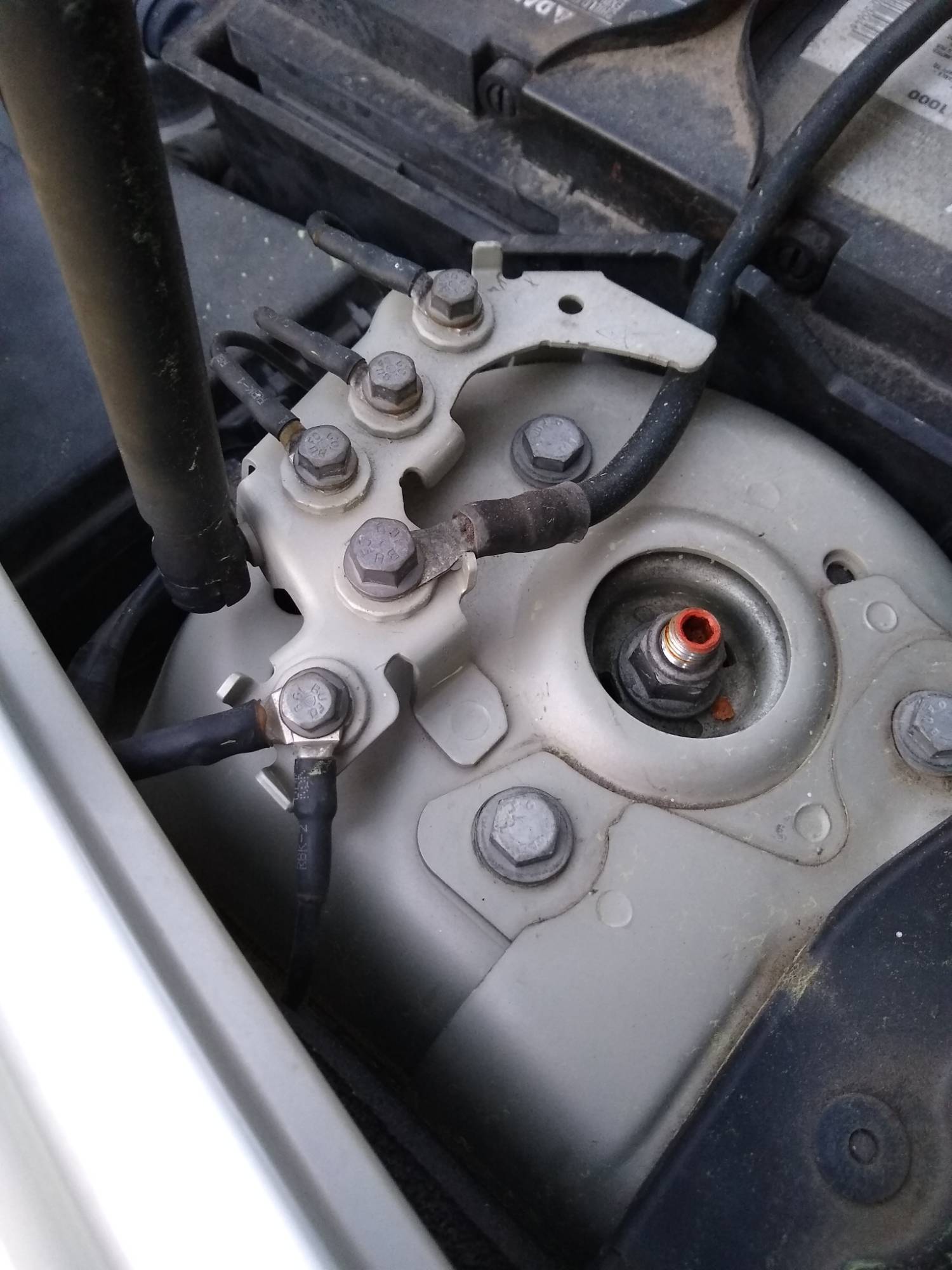

I have been trying to find where on a P1 the engine grounds are. Normally there is one at the back of the block somewhere, but does anyone know where else they should be? I can follow the battery cable but and see where the grounds are on there, the starter motor and anywhere else?

Post by MoVolvos »
There should be a grounds on both strut towers if they're the ones you are referring to?
P1 08 C30 (1).jpg (460.55 KiB) Viewed 2113 times
P1 08 C30 (2).jpg (414.21 KiB) Viewed 2113 times

Wow, those are quite the grounds! I saw something about copper contacts but has no idea the grounds were so large and why on earth (no pun intended) are there so many!?
I think a good check of these and cleaning them would not go amiss.
