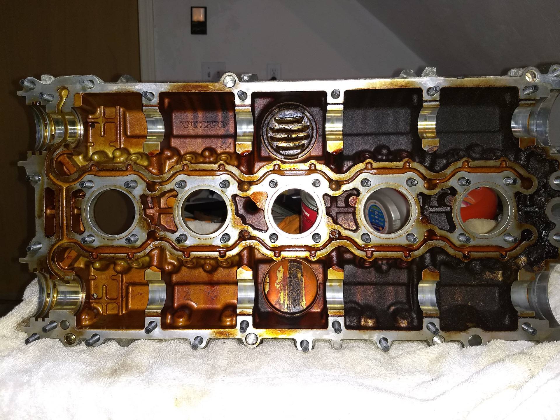

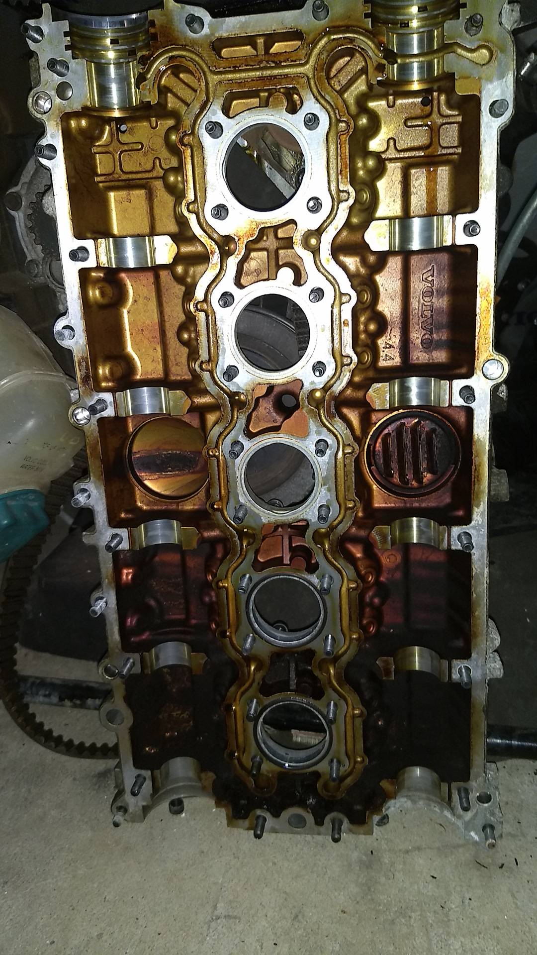

Yes, oil flow lowers from cylinder 1 to 5, oil temp raises from 1 to 5. That's expected, because oil pump is on the crank pulley side. Both engines I took apart had the same cooked oil gradient. About 220k miles both.
5 cylinder turbo runs super hot. Engine compartment is cramped, ventilation is bad. 10k OCI and unregulated oil quality also does add to the problem.
