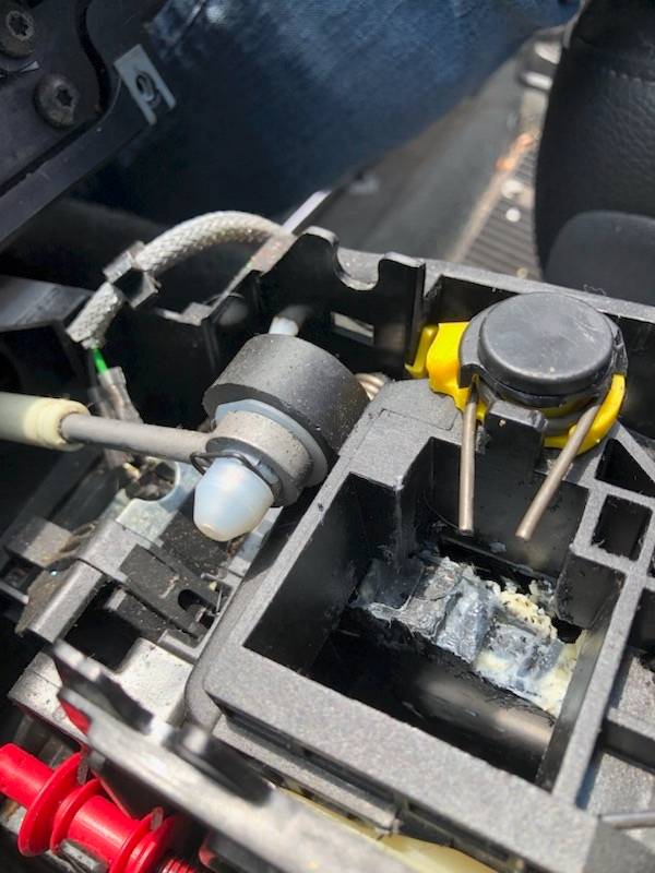

Removed the center console to extract the shift lever assembly. The claw was already broken and shift lever had snapped off and out during shift knob removal. Video showing detail of console removal but for brake cable replacement. Second video shows shift lever assembly removal. Just four bolts and two cable removal.
2012 XC90 Shift Lever Assembly Replacement
