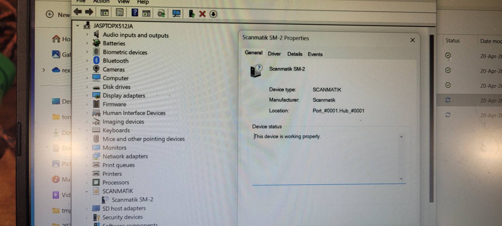

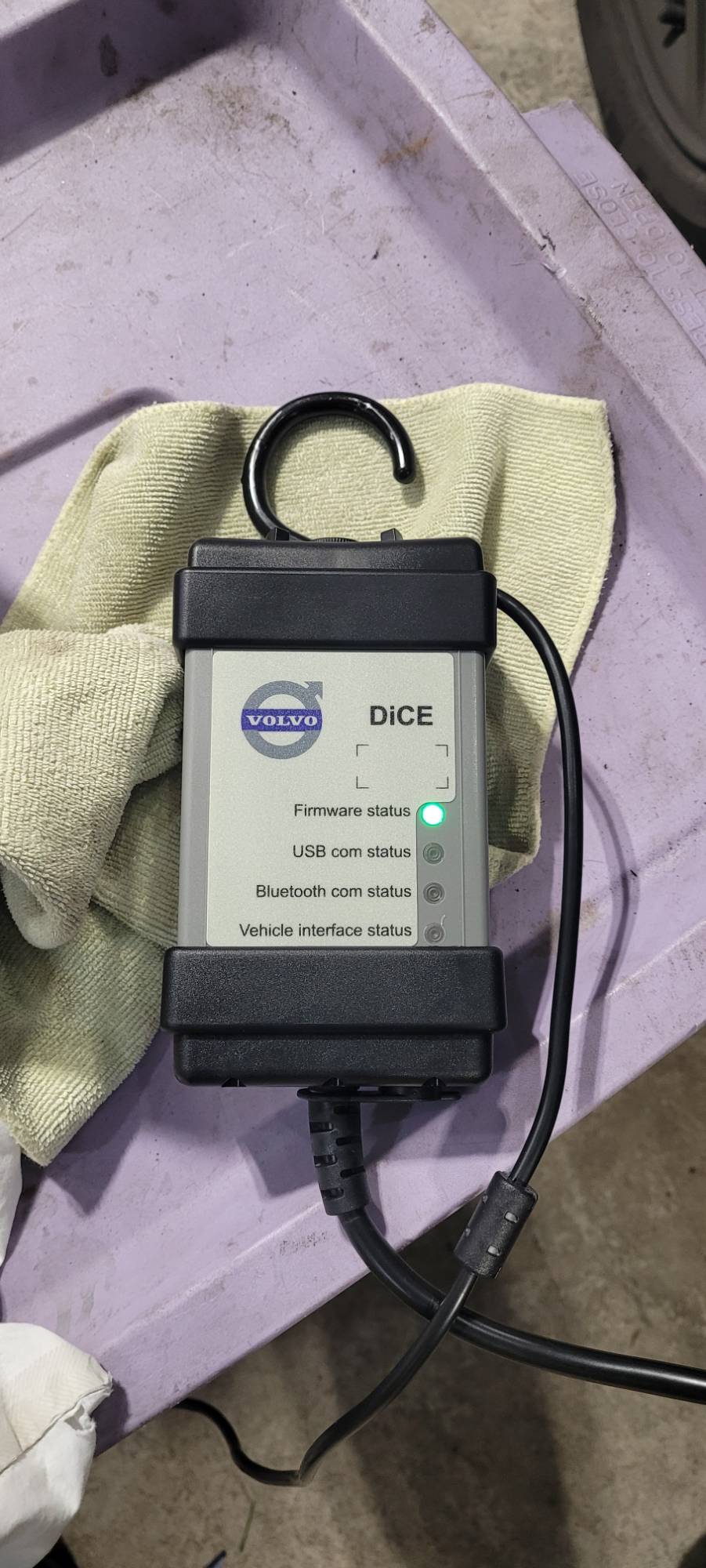

3) I bought a Chinese DiCE from Walmart partner - after all is said and done it identifies as SCANMATIC SM-2
a) It has Volvo stickers and looks the same as every device I've seen on the internet.
b) I bought an external DVD reader and downloaded the drivers off of the DVD that shipped with the DiCE .
4) My computer sees the DiCE in the Device Manager and it says all is well.

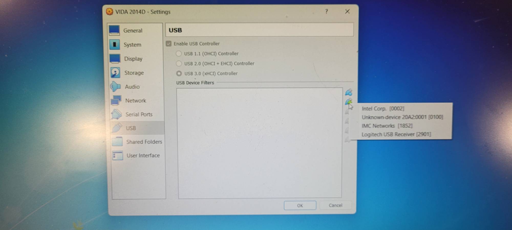

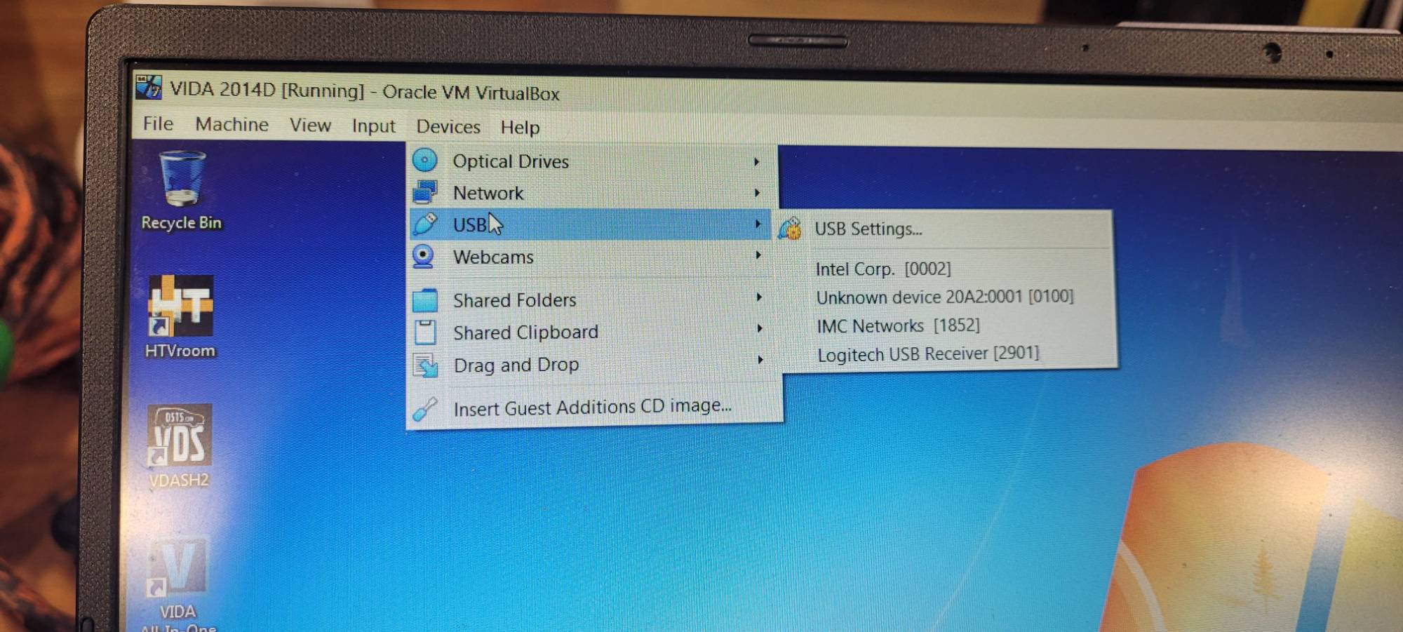

5) The DiCE does not show up when I try to set it up in vbox. All I see when I try to select it in the USB settings is "unknown device".
6) I only get one solid green light on the DiCE itself - Firmware Status. I haven never seen any of the other lights even blink once.

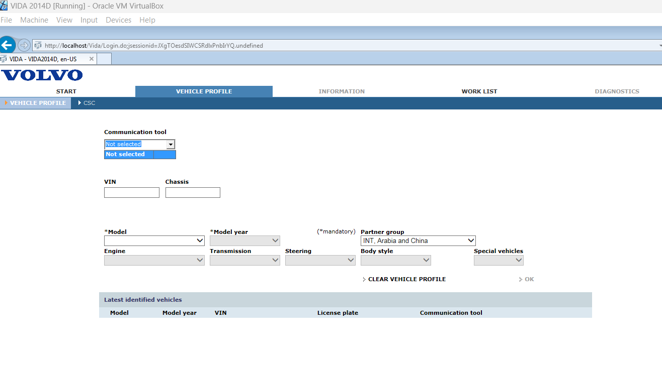

7) Needless to say - when I try to select the DiCE as my communication tool when setting up my vehicle profile in VIDA - which seems to run fine - I don't see my DiCE reader I only see "not selected".
Weirdly - the device was showing up as "Unknown Device" in both my device manager and in vbox - until I bought that external dvd reader and installed the drivers at which point the DiCE showed up as SCANMATIC in my device reader.
I thought I had it beat but I can still only see unknown device when I try to configure vbox.

Enable USB 2.0 in the VM. The DiCE units are 2.0 .

I got it sorted folks.
The first DiCE was a counterfeit. I then ordered a Mongoose JLR2534 cable and - after much fiddling and loading drivers onto the virtual machine - success !
This video was so very helpful...
