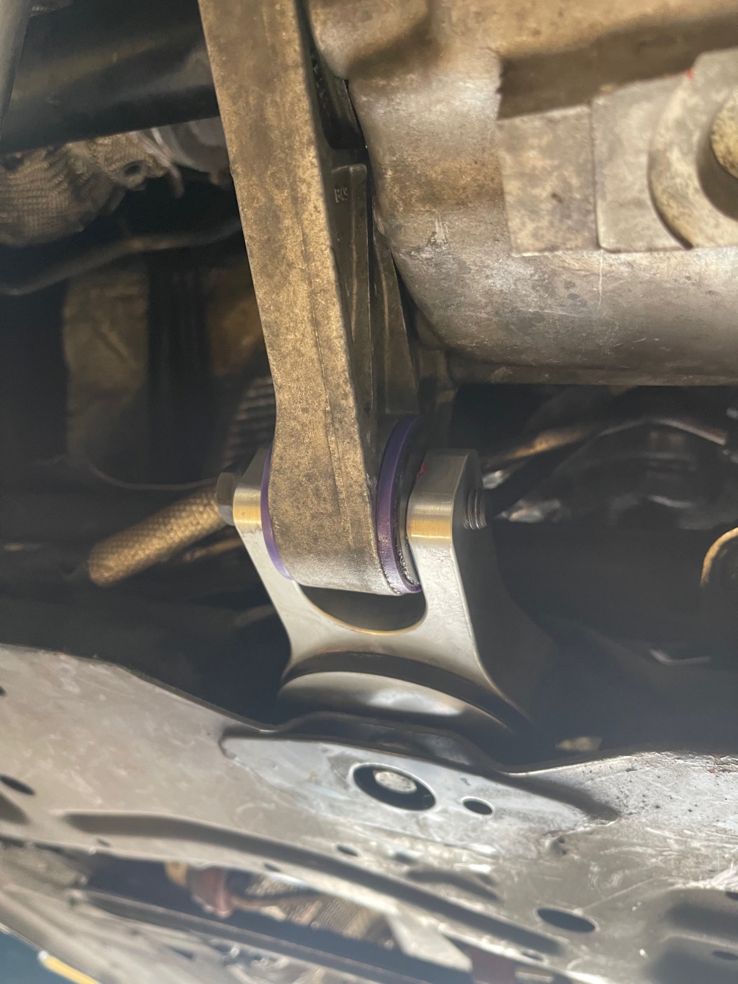

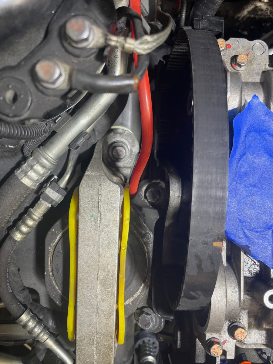

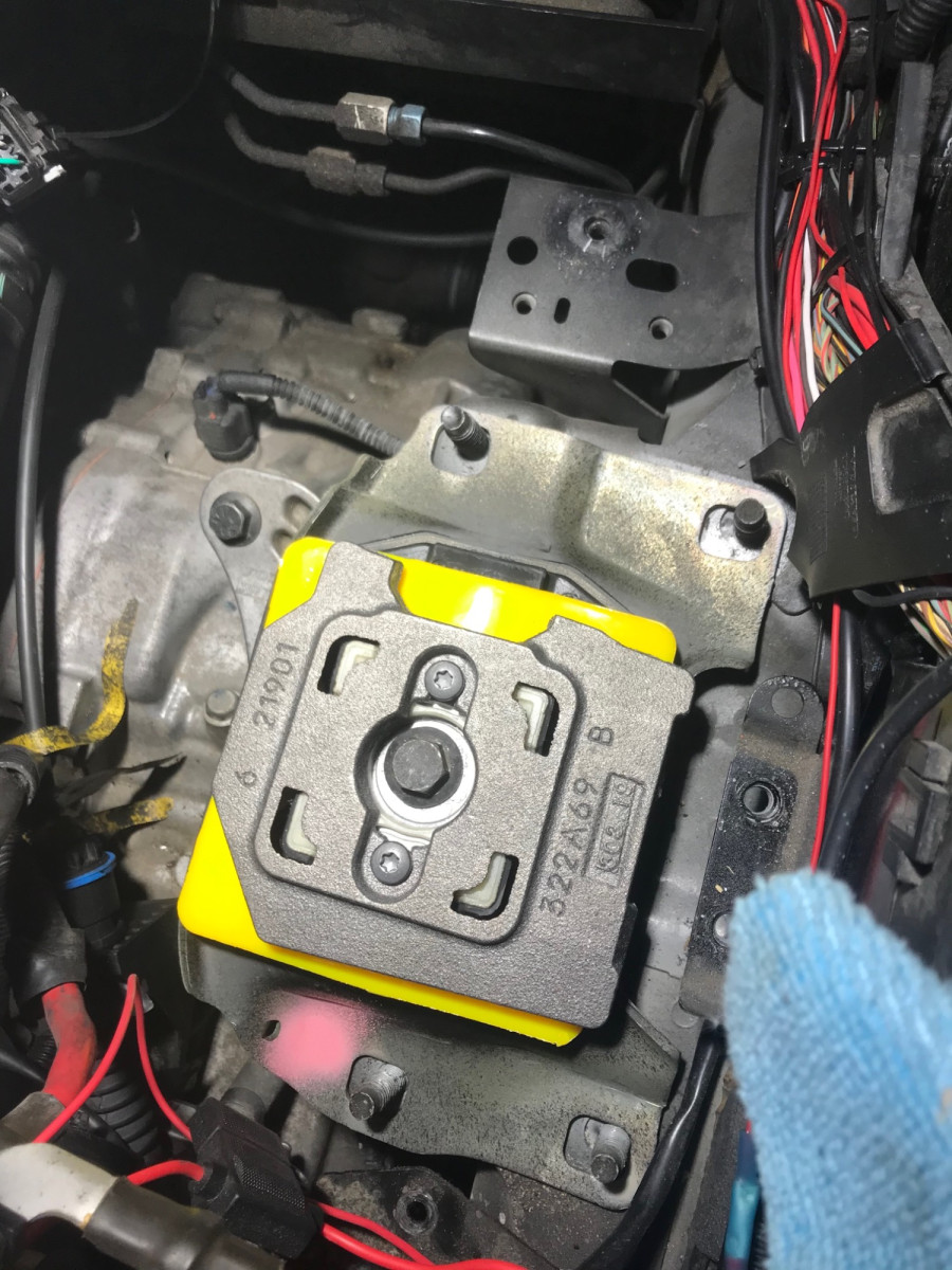

Replace passenger and driver side motor mounts and the lower torque mount.
This is mine with the Powerflex poly insert. 70 duro
It is located directly under the battery. This is my passenger side mount also with Powerflex poly insert 70 duro This is my lower torque mount. It is the Elevate billet mount with their race insert and Powerflex poly on the torque arm. If any of these three are worn, or haven't been replaced you will get drivetrain vibration. Especially the lower torque mount.

I'm getting same problem on my 2012 C30 T5 after changing both CV axles, mechanich told me because not original but i dont believe it, i see the engine shaking a lot when under revs, i wanna start to change the lower mount first hoping the engine mounts are still ok
