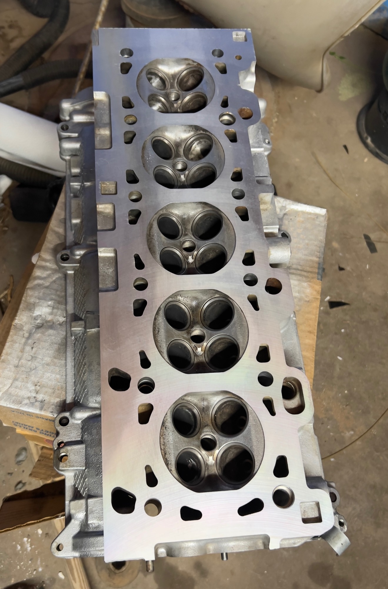

I’m in the process of doing a head gasket repair on a 99 GLT and picked up the head from the machine shop today. The machinist said he had to grind .020” to get the surface flat. Is this excessive? It seems like a lot. I was expecting more like 3-5 thousands. I did see light under a straightedge before machining but didn’t measure it. Your thoughts?

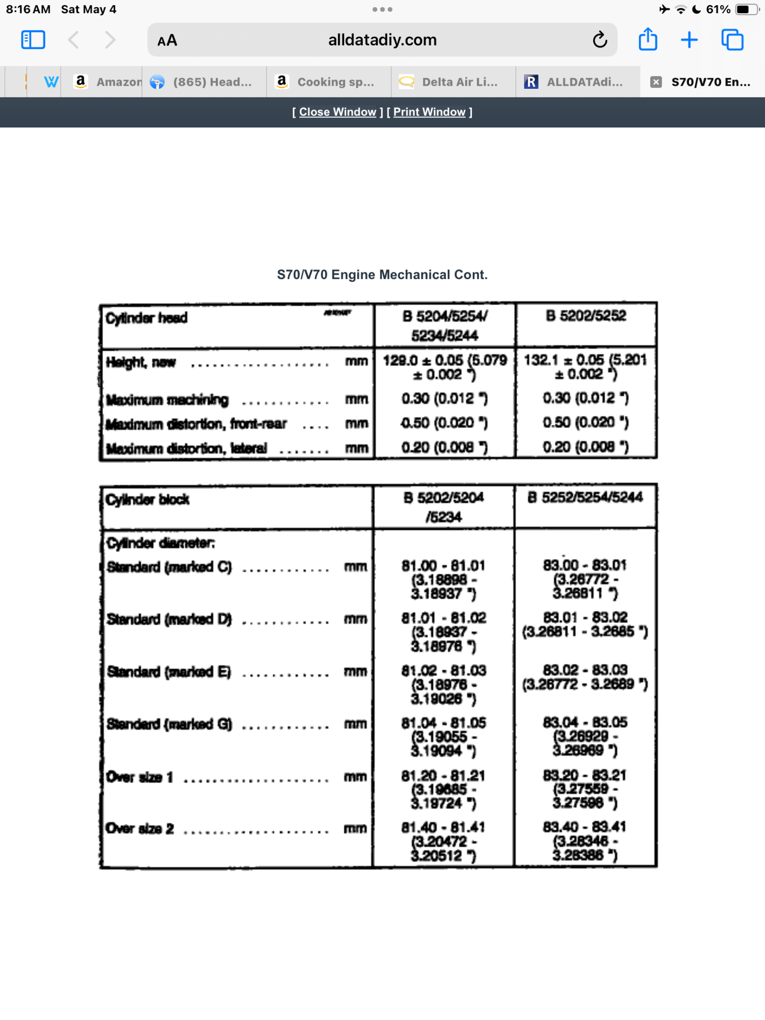

It is indeed a lot. As far as I know the max machining is like half of that according go other engines in Vida.
My 2005 s60 head was machined 0.14mm. Of your head was so warped as to require that much I wonder what happened or like did you hear wrong?

I think 0.020 inch may alter the combustion chamber volume a lot. Smaller combustion chamber will increase compression ratio. That may be a concern for long life of the engine.

- Posts: 36147
0.020 front. To back, 0.008 side to side per Volvo.
Corrected to .oo8 per VIDA

Great! Thank you for the specification.

- Posts: 36147
Corrected lateral spec above.
0.008 inch lateral
0.008 inch lateral

I got the cylinder head back and installed. I just knew I was going to break a head bolt trying to get the 130 degree stretch.
Now waiting on new lifters. When I removed them I had made a mental note that they would “clean up” but on further inspection, they are pretty bad.
Does anyone have experience or thoughts on DNJ lifters vs the original INA?
