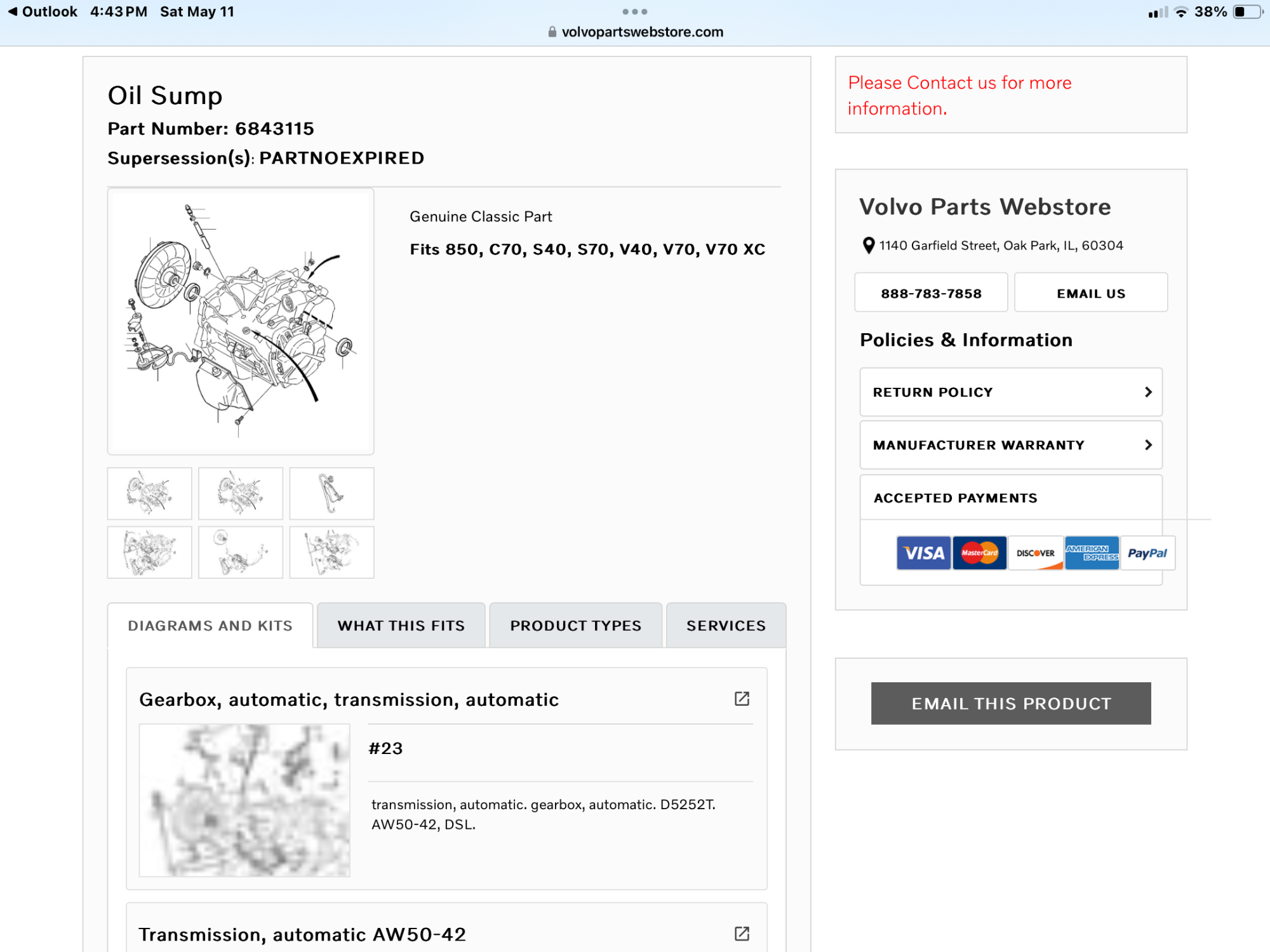

Thanks. Is there a name for that cover?
Posts: 35321
Has thanked: 1507 times
Been thanked: 3825 times
bw711 wrote: 11 May 2024, 10:31 Thanks. Is there a name for that cover?
Oil sump
6843115 , I believe it’s an obsolete part

Clean the dirt off this and dry it off. Then check for where it leaks from. A few owners on the East coast have found the covers pin-holing with rust. Hopefully it is just the gasket failing with age.
