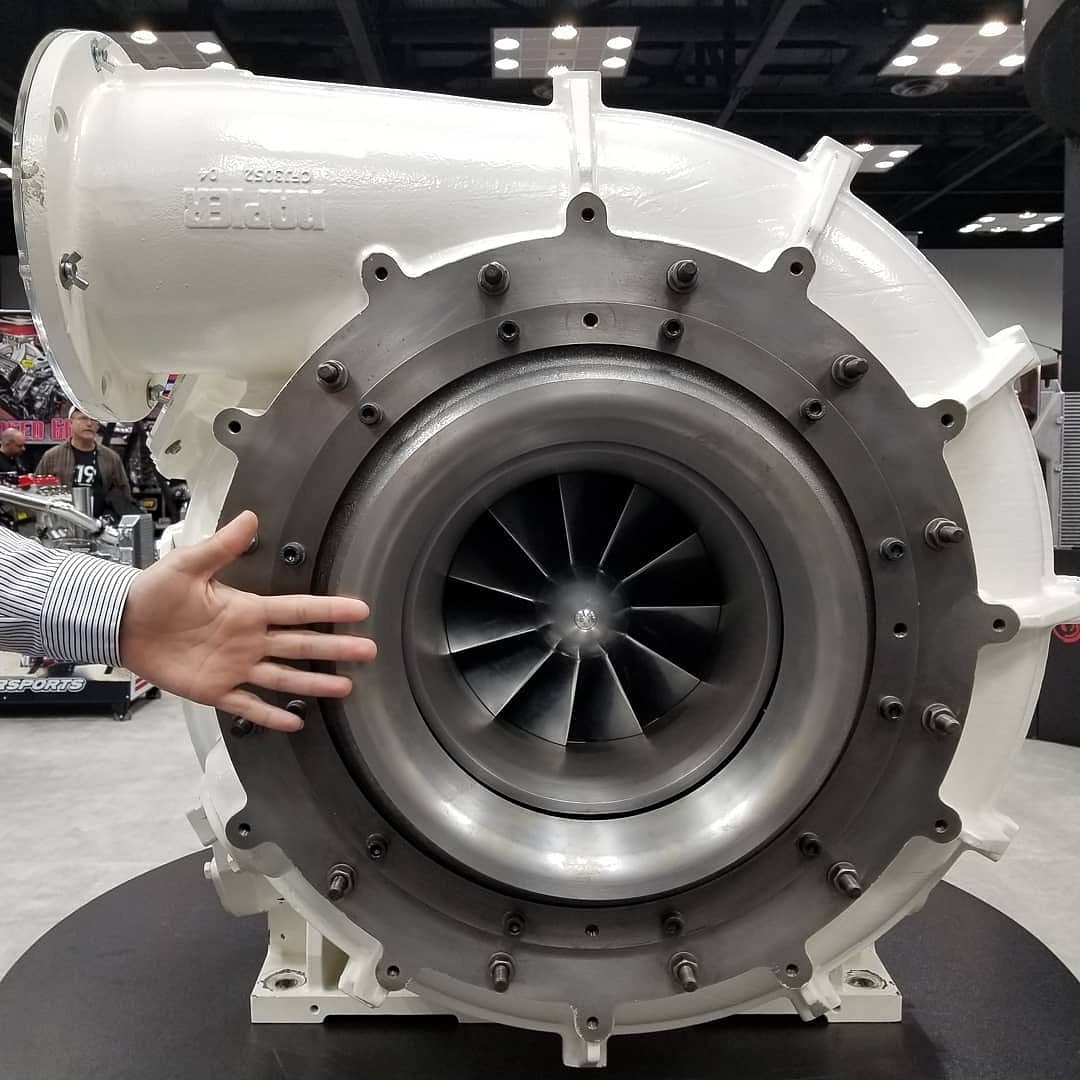

That turbo is big enough to roll on its own down the road xD
