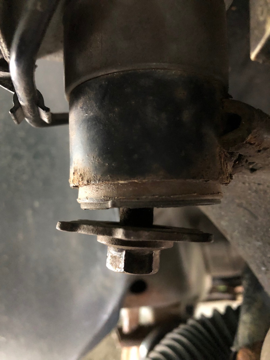

Post by GreenMagicMan »

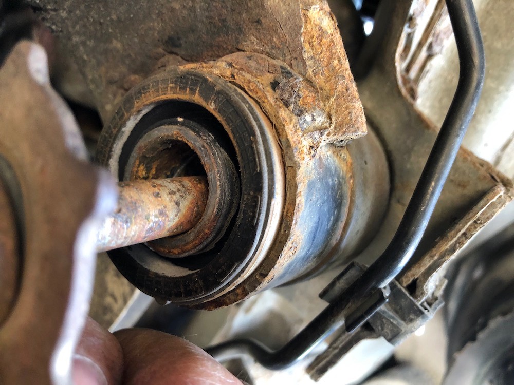

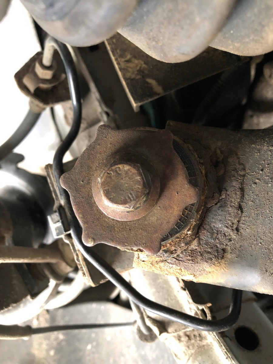

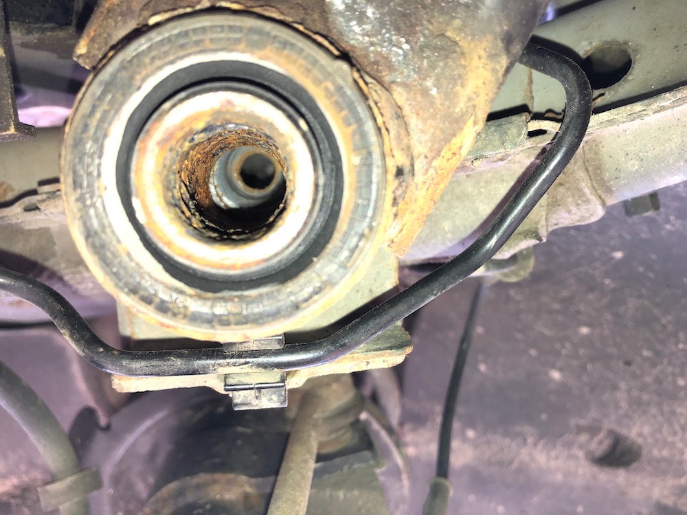

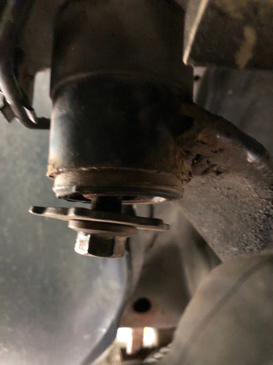

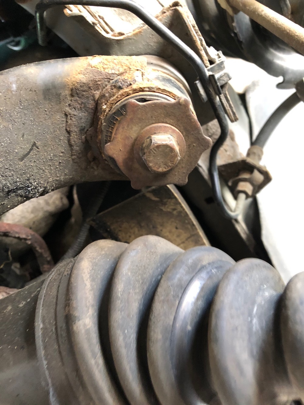

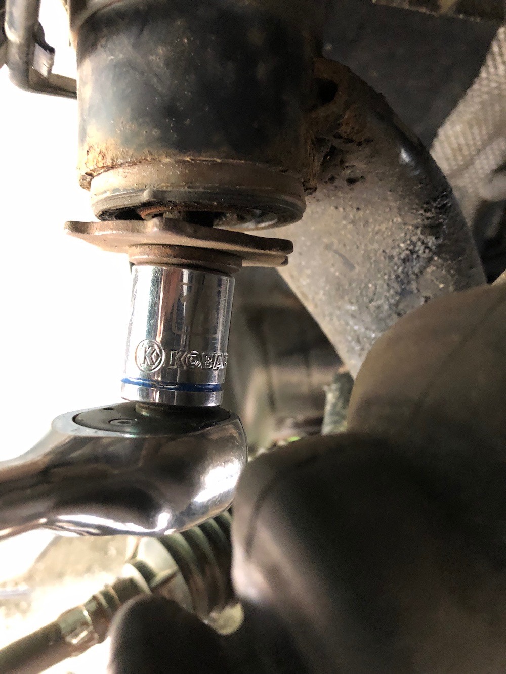

Here's some pictures:
Here's how the subframe sits without pulling it over a bit.
Slop around the bolt - should the bushing be tight(er) here? There's a lot of play as you can see. The bolt had not been started in the bore, just being held by hand at an angle
As bolted in slightly how things want to line up without pulling things hard.
THIS seems to be THE PROBLEM. How the bolt does not bolt in true / flush as it should. Why on earth does it keep going in diagonally?
The bolt will not tighten past a certain spot - it's close to starting to tighten on the subframe bore but not there yet. Major force would be required to try to proceed. Shearing force type of force I am sure.
