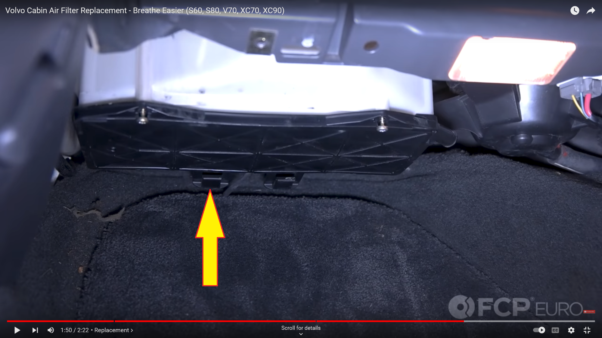

Due to the curve in the lower glove box panel which mates with the center console side cover, I wasn't able to be sure whether the lower panel had fitted into the two slots in the cabin filter cover (yellow arrow). I removed the console side cover and then attached the lower glove box panel to insure fitment into the slots.

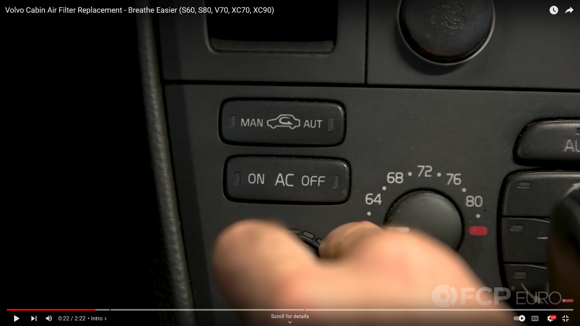

Per FCP: Look at the re-circulation button on your Volvo. If it has "MAN" & AUT" printed on it, you'll need the 1.5" filter. If it doesn't, you'll need the 1" filter.
2002 V70 XC 1.5" Charcoal Cabin Filter For IAQS
