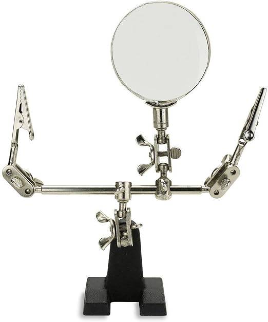

If you have a set of alligator clip "third hands",
break'em out and secure your work to hold it still.
. If not - Don't forget the MVS Amazon link: https://amzn.to/3GKkXeo
https://www.amazon.com/Neiko-01902-Adju ... 1_7?sr=8-7
