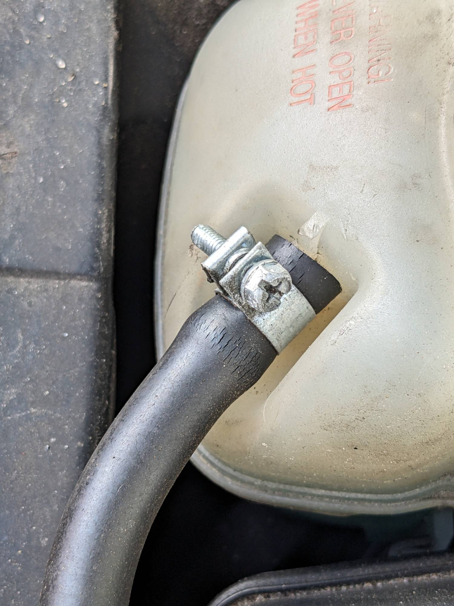

What do you think about a new Volvo brand coolant return hose becoming hard and cracked after only three months of use? The cracks are evident at the coolant tank nipple which makes the hose bulge out a bit. The hardness is felt when trying to bend the hose. The car has a notable coolant leak (0.4 L per 2-3k miles) so I will check this hose.
I replaced this hose on a different car with a Volvo part in 2021. That hose is still soft, flexible, and shows no cracks. I believe that 2021 hose had paint marks on its ends and Volvo branding on its length. I don't think this new one has either. This may be a case of Volvo using cheaper materials for their branded parts.

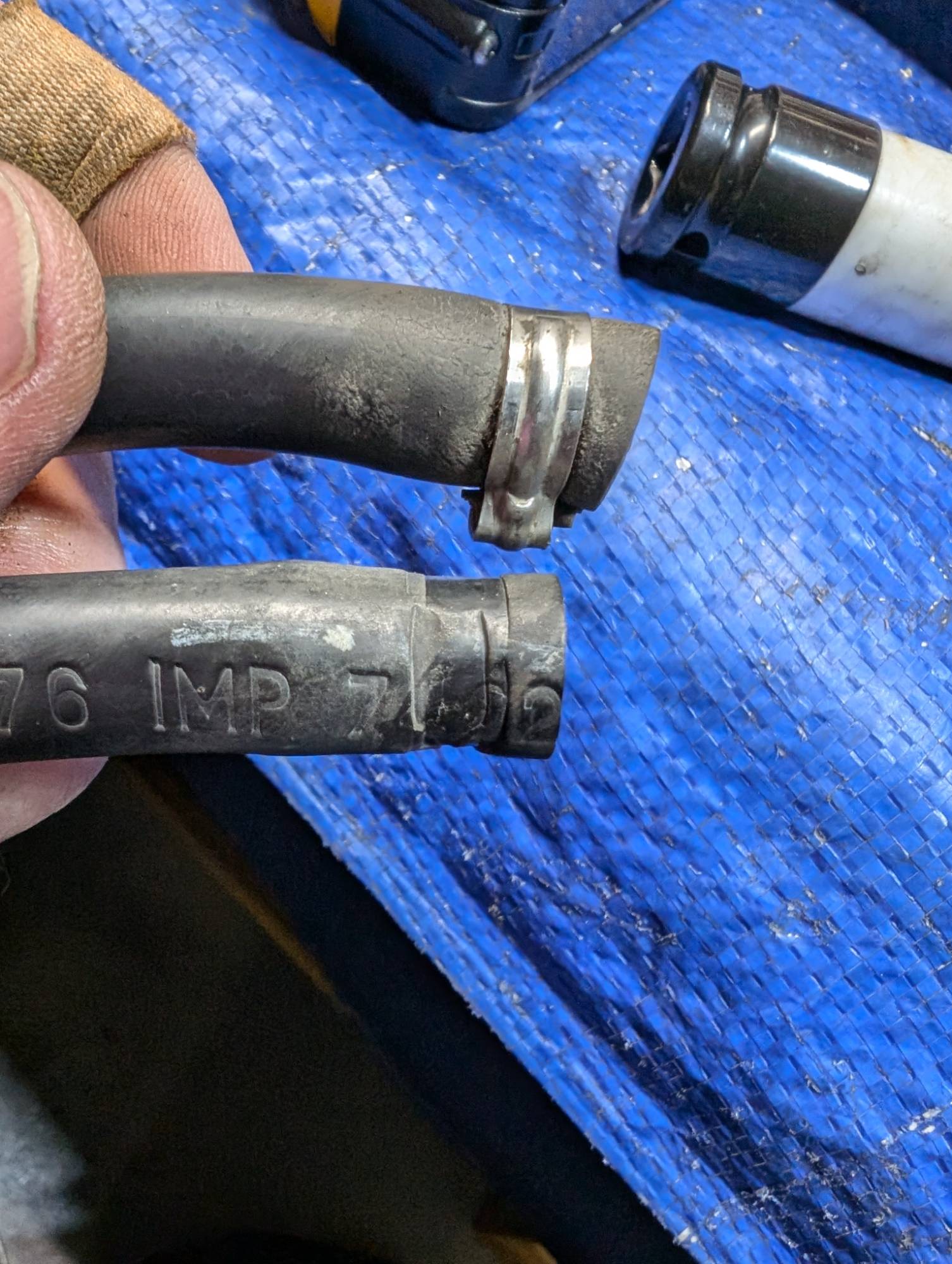

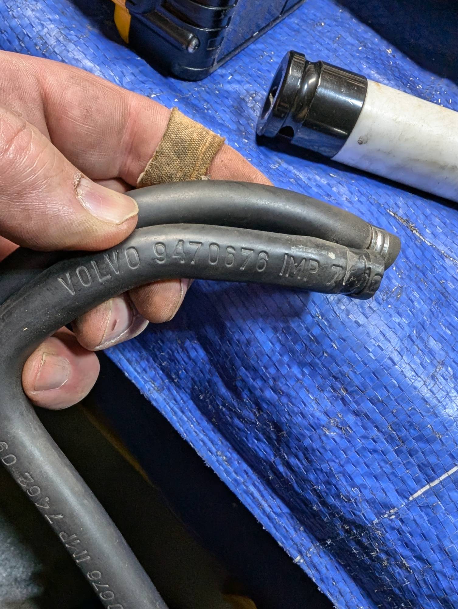

For comparison, this hose is likely an original. Today while my mechanic friend was swapping the timing belt for me on the R, when he removed the coolant bottle we found it had been leaking from the bottom from a crack at the outlet. Anyway I pulled this one from the spares pile and we installed the bottle and the hose. This hose is off that bottle as we reused the original to the replacement bottle. This is likely the original and it is showing signs of age, but is not showing any sign of cracking. I think the part you bought is likely some really, really ancient NOS pipe. This is my concern now with many OE rubber parts, how old are they actually? At least the timing belt has a date stamp on it so you know it is original. Also it is a wear part shared with other models so stock may be newer.
Gus did cut the end off the original hose, not because it was bad but just to use some un-stretched hose for better sealing.

It’s a wierd thing with rubber, the degradation is a bit unpredictable. I had some trailer tires from 1976 that had no cracking on them, while a boat next to it , In full shade, had one tire like new with the other completely dry rotted.
