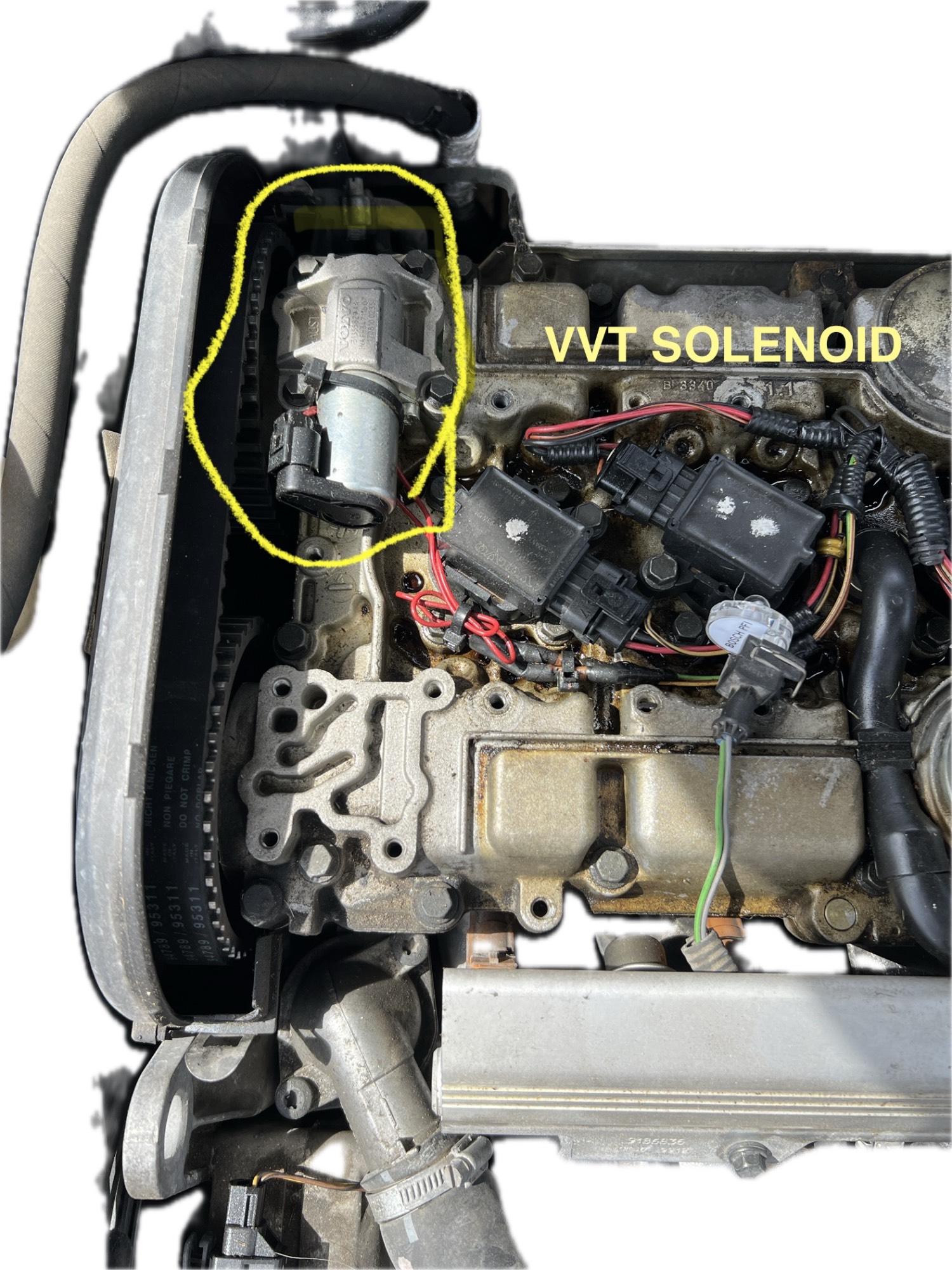

- First, I'm not sure if my car has VVT, how do I check and my understanding is that even if it is a VVT, the procedure doesn't change if I don't move anything and get the car out of 'timing'. How true is this?, and how do I check if my S70 is a VVT one.

When you take off the front cover you will either be looking at one or 2 variable hubs shown in that first vid, or bare naked sprockets.

Ideally you would install a camshaft locking tool before removing the old belt but not critical as long as you mark where the cams should be. If it does have VVT there is a step where you rotate the engine backwards. This is what I have in my notes: "unload VVT by rotating crank 90 degrees past timing marks and then back, this will keep the VVT hub from springing back and having to fight it back when reinstalling belt". If you don't do this you will notice that the camshaft with the VVT is off it's mark when you go to put the new belt on.

I didn’t watch it but the splash screen in the first video shows VVT on both the intake (right or ‘front’ side) and exhaust (left or aft side).
Your 2000 will almost certainly have it on at least the exhaust side.

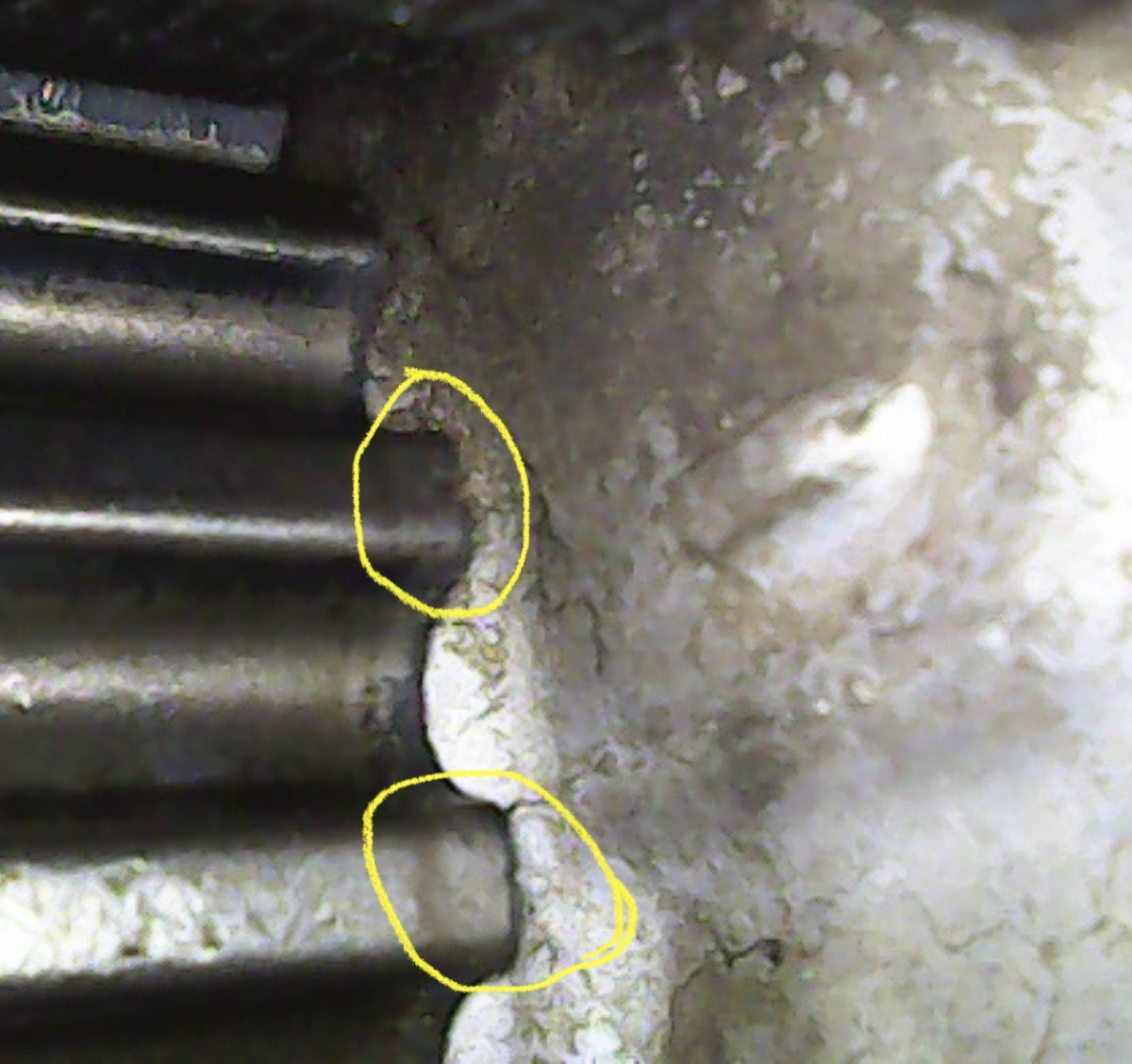

The marks on the crankshaft pulley are almost microscopic- tiny notches in the end of 2 teeth/cogs

Thanks all for your reply. Twarr those links and pictures were super helpful, it's very much appreciated. I will be tackling this tomorrow at the crack of dawn.
