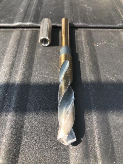

1) Enlarge hole with Uxcell Reduced Shank Twist Drill Bits 14mm High Speed Steel 4341 with 10mm (3/8") Shank
https://www.amazon.com/dp/B082CXCFD1?re ... tails&th=1

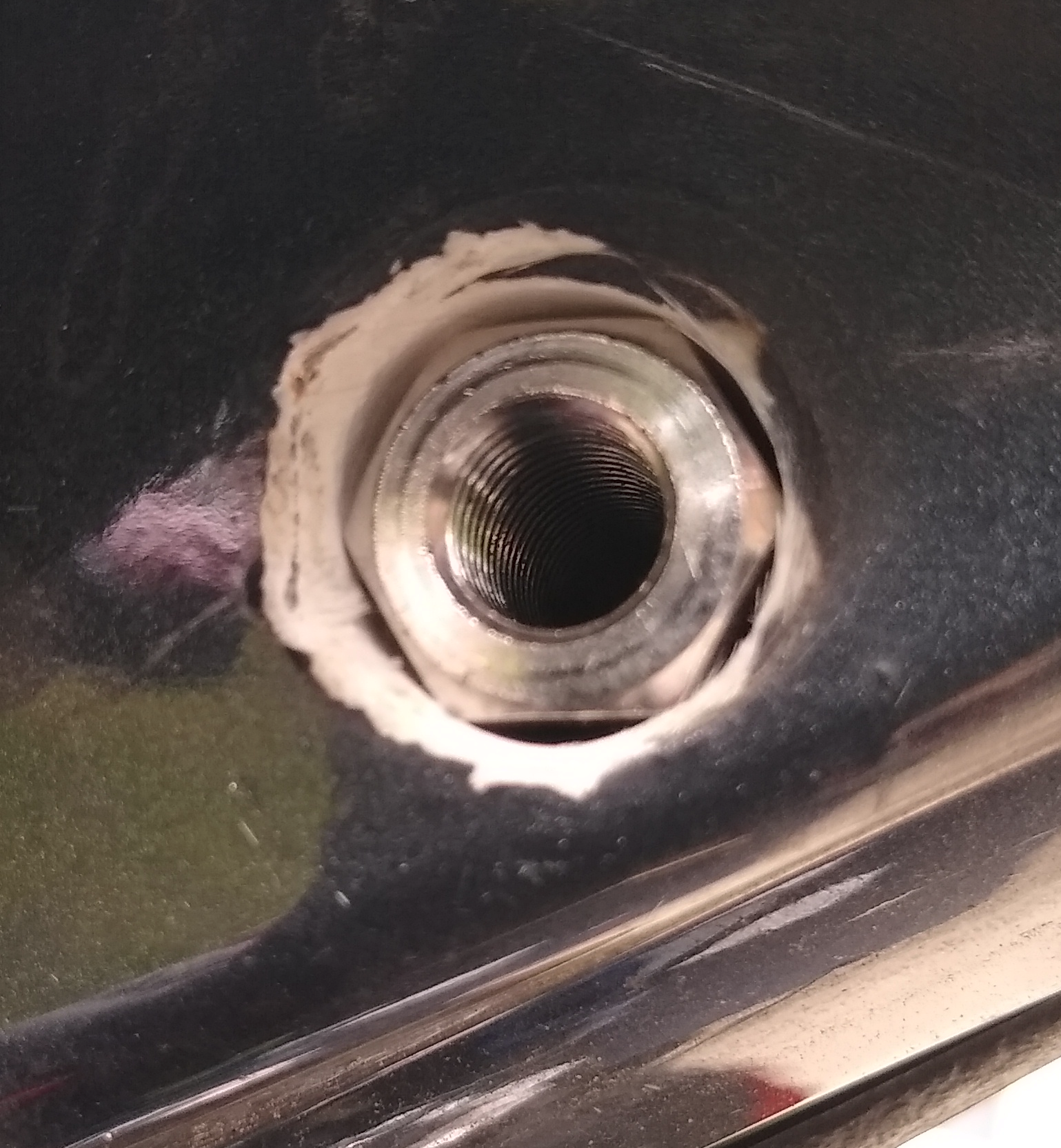

2) M8 X 1.25-Pitch 40 mm Length Metric Hex Coupling Nut 304 Stainless Steel Rod Coupling Nuts. Used this coupling so I can drill through to the other side of the hatch in case it ever remotely starts to come loose. Would use long 12" bit slightly smaller than the hole of the coupler to drill through the other side of the hatch. Once through will enlarge the hole on the other end of the hatch and secure with a hex M8 X 1.25-Pitch bolt. Will add a fender washer to the Pivot Ball end so the coupler can be pulled tight, sandwiched between the frame of the hatch. Very solid at this point but will practice holding the hatch as it goes up so it doesn't jolt as it reaches the top.
https://www.amazon.com/dp/B095J5XTNG?ps ... ct_details
Although it's wedged in there tight, had to hammer in, could have used some Epoxy to fill the slight gaps. Regardless should hold for quite some time.

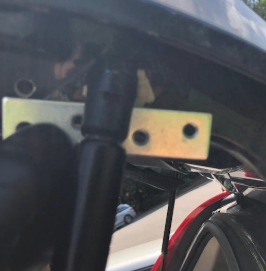

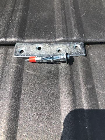

Originally was thinking of using a bracket. Already drilled a hole when I saw the Hex Coupling method. Drill holes on the ends of the bracket and use a drywall anchor to expand and secure. The Pivot Ball would have a M8 X 1.25-Pitch bolt behind the bracket. At this juncture I could just add the bracket to the existing insert / hex coupling and it would outlast the XC.
