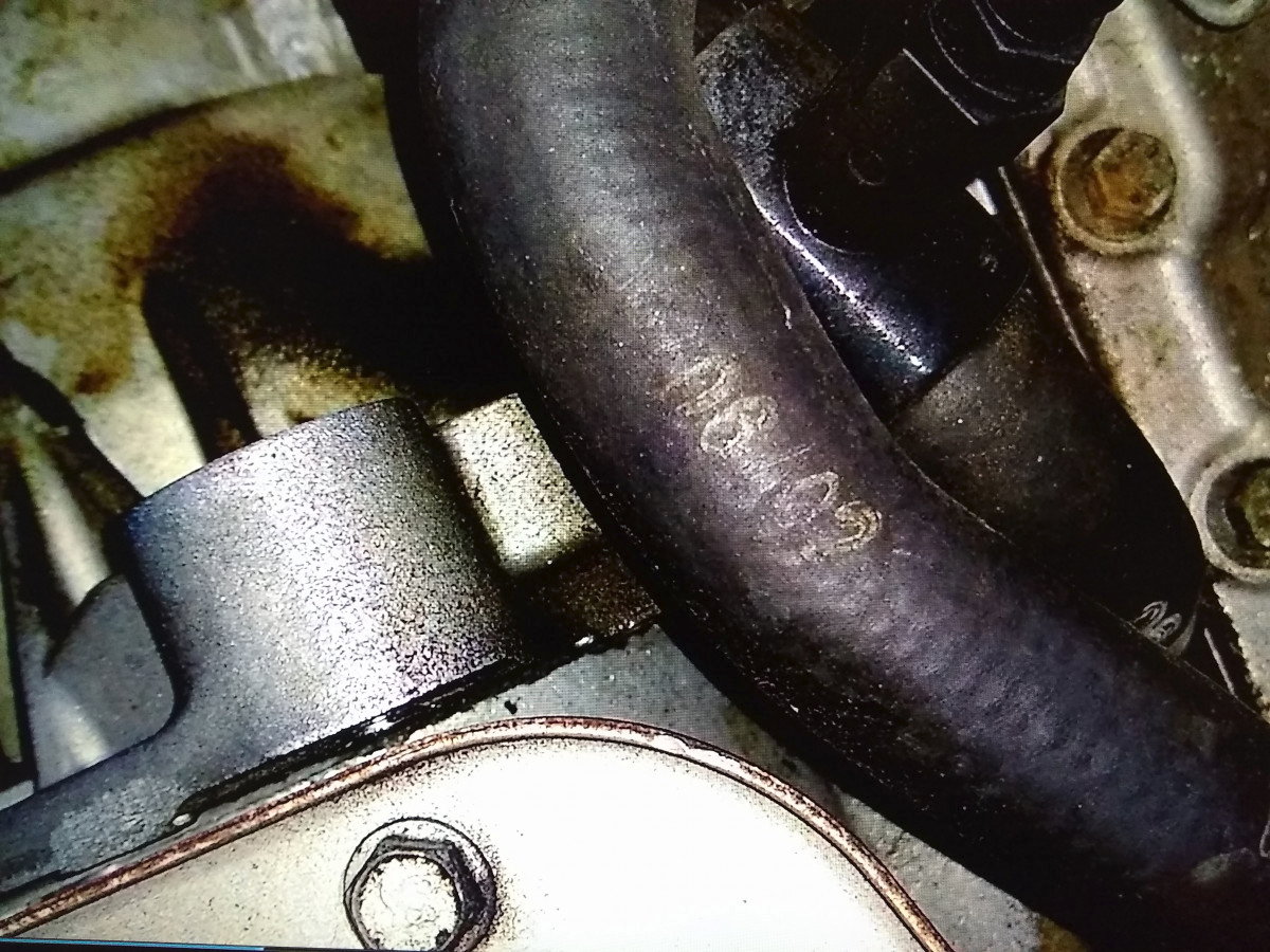

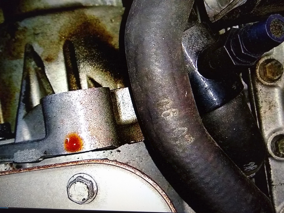

Photo example of what ATP AT205 can do on a mystery drip that never left a drop on the driveway. Caveat, from many who have used this in the past, supposedly during the pandemic due to supply chain issues the formulation was changed. Others speculated to be environmental regulations and/or PC pressures on corporations to conform. The leak stopped sometime between an oil change interval.
https://www.amazon.com/ATP-AT-205-Re-Se ... B000NVW1LM

I have used Blue devil and ATP-205 seal conditioners and they have worked on several RMS leaks and a few others.
The only time it failed me was on a friends RMS which was pushed out as we discovered later!
