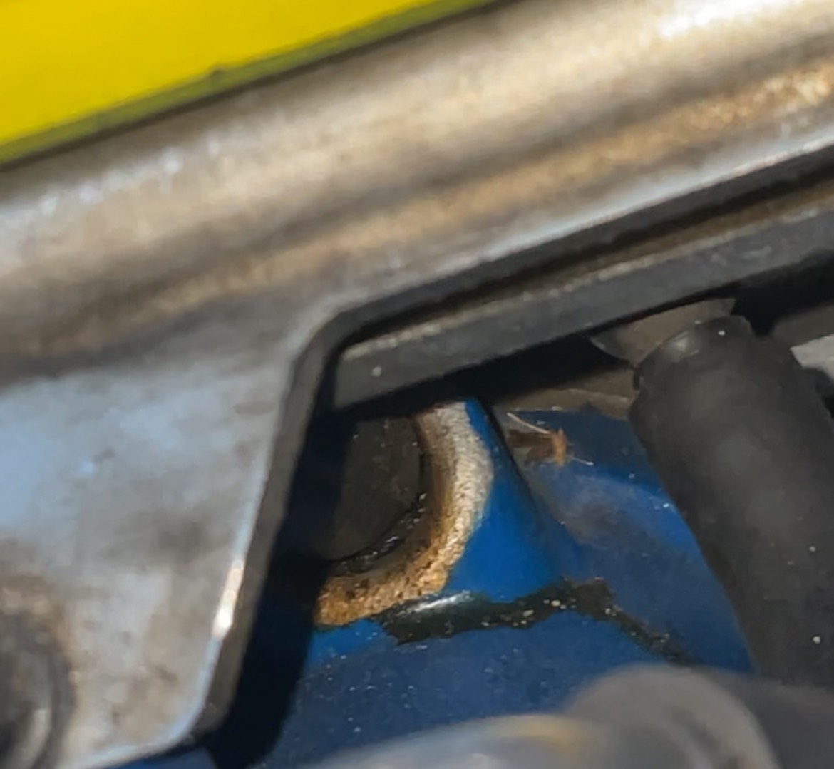

This look like a leaking injector?

i was thinking an injector leaking into a hot intake, it can cause vapor lock.
leaking externally would ber vacuum loss, you can check by spraying a BIT of brake fluid or carb cleaner where you suspect a leak.
listen for idle rpm going up.
