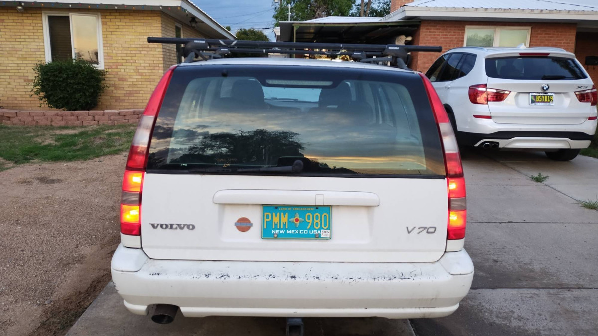

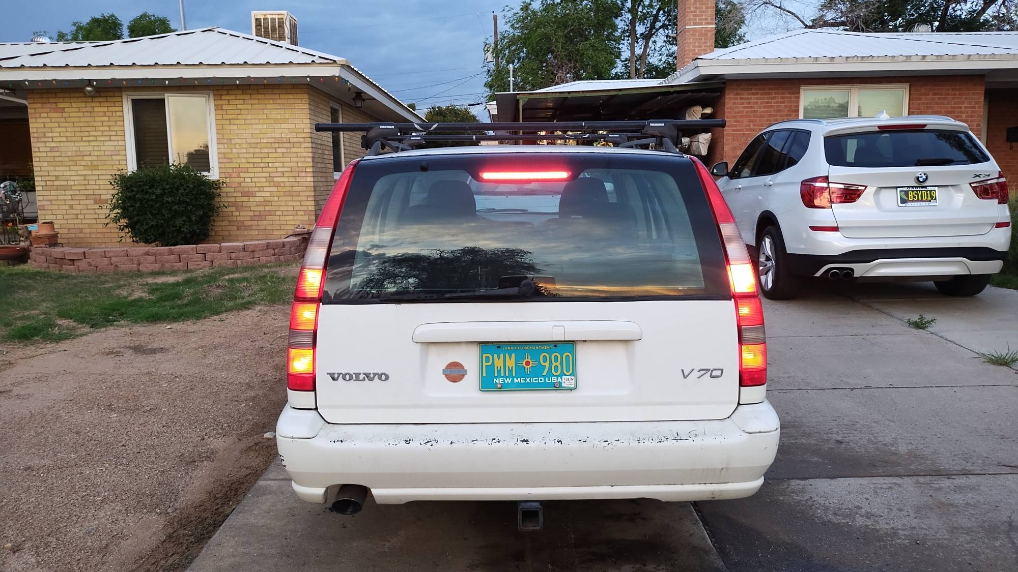

When first started the car after singing for years, it showed the bulb light in the instrument cluster when ever either lights were on or the brakes were applied.
Now the bulb indicator comes on only when brakes are applied (doesn't matter if lights are on or off)
Since it fixed the lights on issue, I'd be tempted to let it self-fix the brake issue too but I got to deliver this to my kid in a few days so would like to fix it.
Here is what it looks like from the back. Top pic is with lights and brake on, bottom is with just lights.

Maybe it the the angle, or the lighting, but the right upper light in the last photo looks dim. The test system measures for the current passing and if it is not sufficient (dim) it may be throwing a code.
Again maybe the lighting but the lower left light looks like it has a double light reflection and the one on the right a single. Is the correct bulb in there?
It may be worth going through all the bulbs and checking the correct ones are fitted and the bulb seats are not corroded.

Another set of eyes is always helpful. I'll check the relatively dimmer bulbs. May be insightful to use the DC amp meter and see what is drawn.
