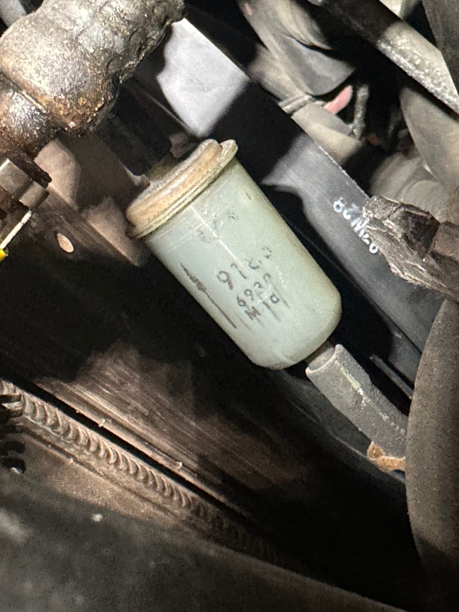

Hi, all. I’m gradually replacing components in the engine bay. I believe this is an SAS check valve according to this diagram: https://www.volvocarsoempartsdirect.com ... NS1nYXM%3D
Part 9135666
However I can’t find anything on the internet that looks the same — and the markings are all smudged. (See attached.)
Thanks!
Help me identity this — SAS component?

This looks like what you are asking for:
https://www.volvocarstorontoparts.ca/p/ ... 86744.html
This is a filter not a valve. The valve you are listing the part number for looks totally different:
https://www.volvocarstorontoparts.ca/p/ ... 35666.html
Hope this helps.

- Posts: 36145
Carbon filter on the evap line
I think?
