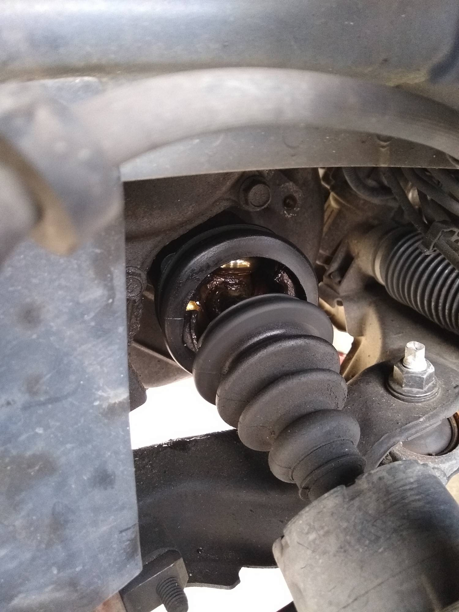

Further update. The right axle is looking like the source of the problem, but I can't say for sure as I haven't replaced it yet.
Right inner boot has a small hole. The car is 12 years old and axles look original, with the "Volvo" label still visible. Since the car is lifted and the tires are "drooping" the CV joints are at a high angle. When I rotate the tire by hand the required torque gets noticeably higher at a specific tire rotation angle. I marked the tire and then turned it by hand without looking. When I felt the torque increase, the mark was back in the same spot. This could definitely drive a resonance at certain speeds.

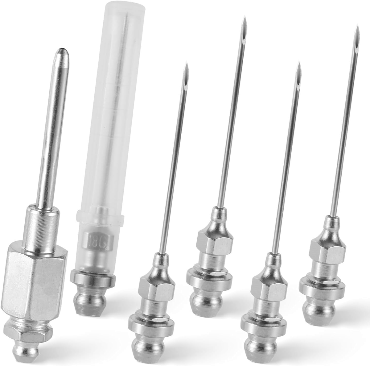

After dropping a bag of CV grease from the Inner & Outer boot kit from FCP, the vibration and noise lessened. When trying the car yesterday I noticed a very slight vibration and noise but both were greatly, greatly reduced on the stretches of freeway that were newly paved. Unless it's newly paved roads I have the exact same symptoms as yours with more noise than the death wobble vibration. I didn't see a drop of grease from the temp mending. Probably broken for sometime before I acquired the car in mid Dec 23.
You might want to consider using a grease gun with a needle and injecting some grease directly into the bearing to see if the symptoms lessen? I used the needle to rejuvenate unbroken but old tie rod ends, sway bar links and ball joints. The suspension feels very quick and smooth afterward. Inject the CV boot at 12, 3, 6 and 9 o'clock and massage outside of boot to push in grease. Some will leak out with use but just wrap the hole with the wire loom double sided self sticking tape per Temp Mending link.
5pcs Grease Needle Nozzle, Bearing Grease Injector Needle with NPT Threaded Narrow Needle Adapter Grease Gun Tip Dispenser Fitting Tool for Injecting Grease into Small and Confined Spaces
https://www.amazon.com/XIHIRCD-Injector ... ive&sr=1-8

Epilogue
Replaced the right front CV axle today. PROBLEM FIXED!!!!!
Inner CV joint on old axle definitely has issues. I can not angle it freely with my hand. Seems to jam at certain positions.

Epilogue, part 2.
As I mentioned previously, the boot on the bad joint had a small, 1cm long split near the bottom of the wide section of the boot. I cut off the boot today and examined the joint. It was essentially dry. The metal had a film of grease on it, but there was no bulk grease in the joint. Looks like it had all been flung out over time through the little hole.
