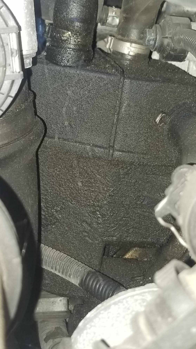

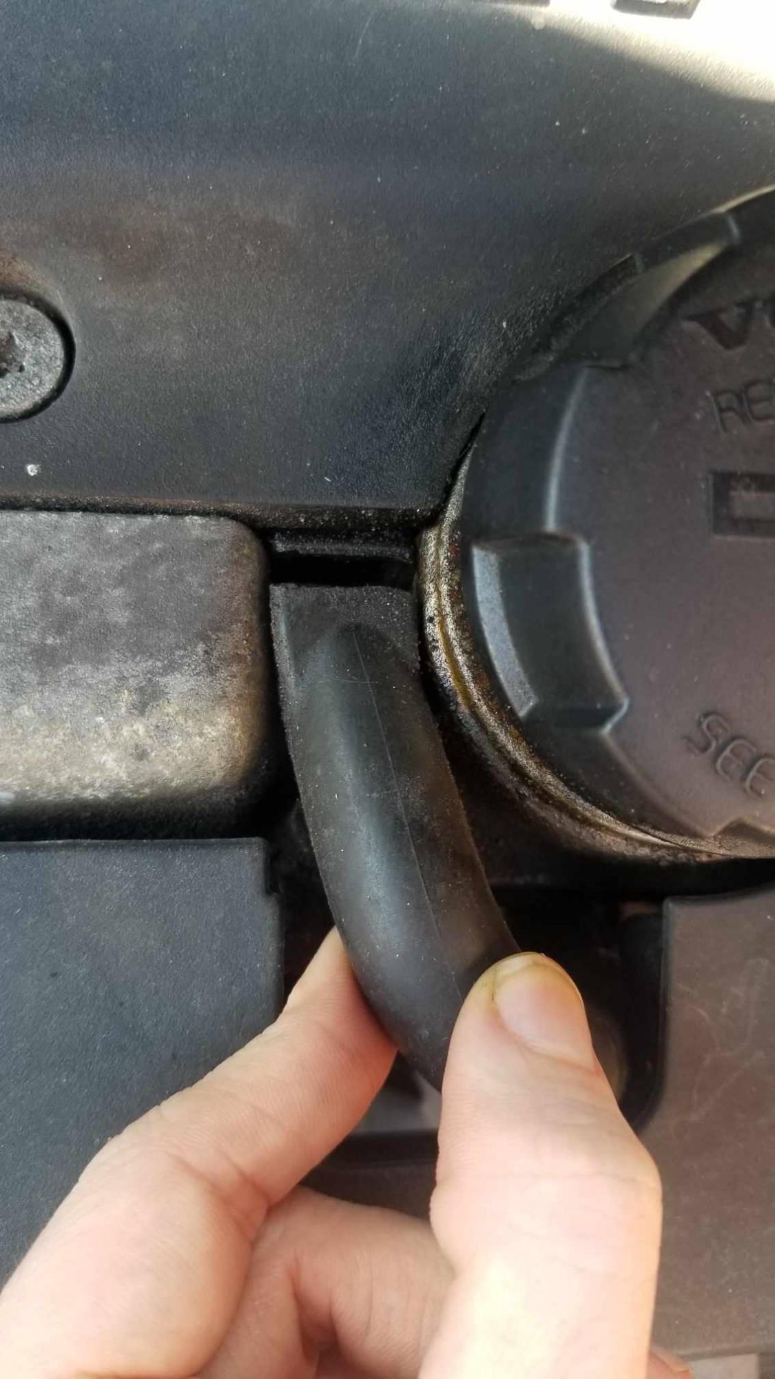

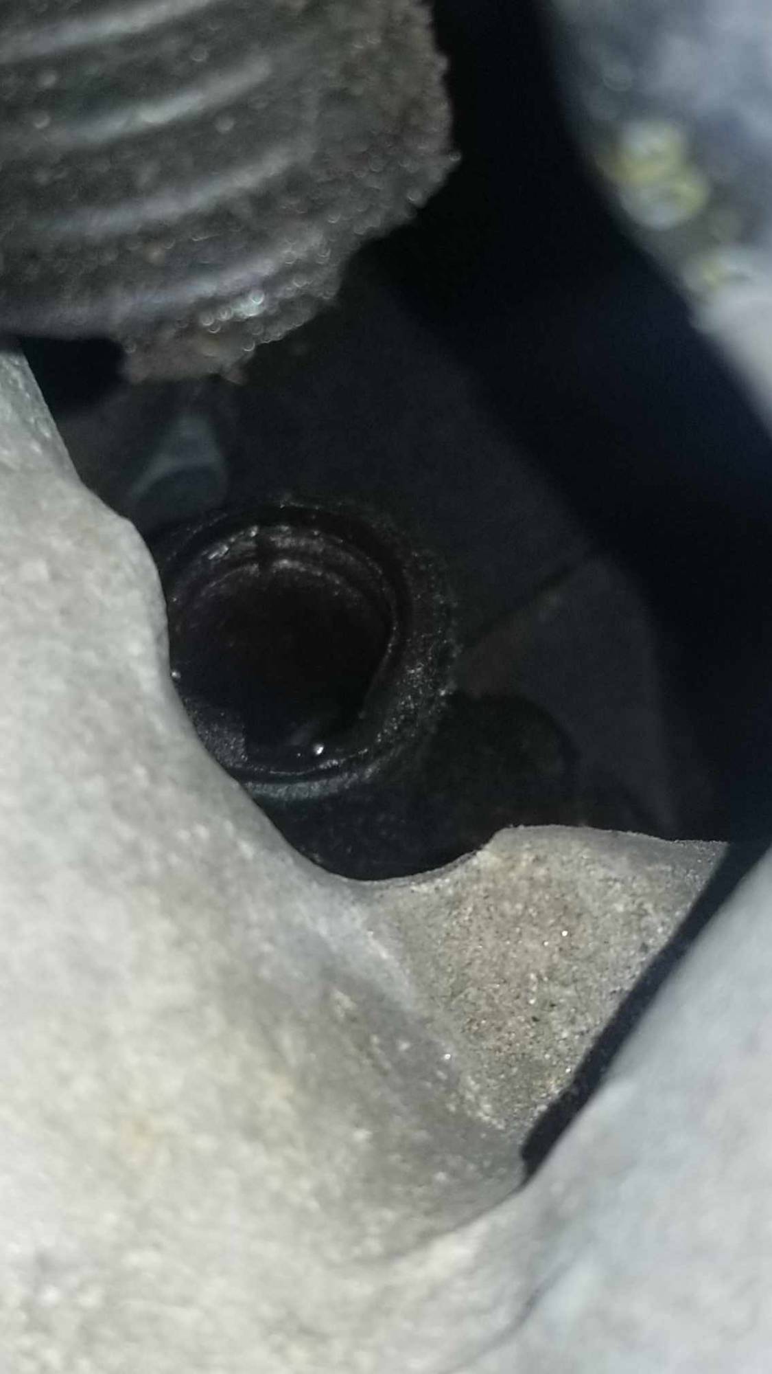

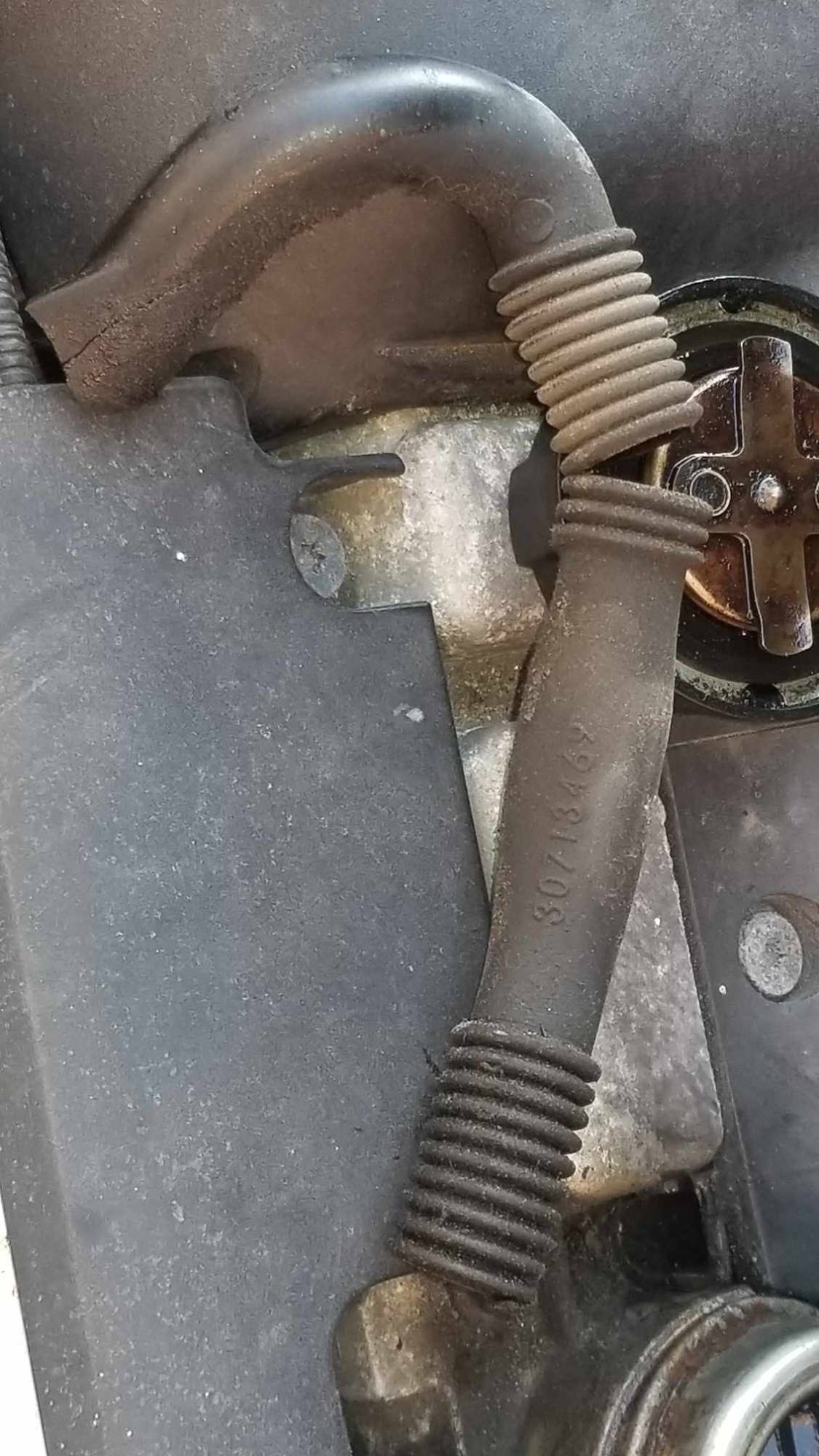

Couldn't get my XC70 (07, 211k miles) to start after stopping by the gas station this morning; found the upper PCV hose to the crankcase (plastic instead of the older rubber, of course) snapped off. Taped it together enough to get it back home but managed to catch on camera it completely disintegrating while taking photos to post on here. [Pictures are in the next post below]
Is it safe to drive the car without it attached while I wait for the parts to come? (It's my only means of transportation)

Classic upper PCV breather hose disintegration in real time

It may suck in air and dirt or it may blow out gases and oil. Definitely not emissions legal. But not likely to hurt much on the car for a while.

I would run it as is for now, i don't believe it would stop the engine from running, something else might be going on.

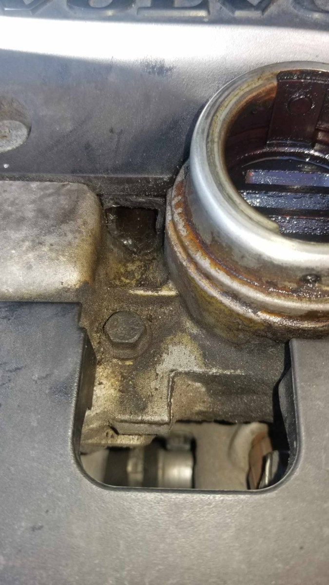

from the looks of the baffle in the oil fill port its gunked up, oil and filter change ? 5-30 full synth oil.

Actually you can remove the hose in situ.
I posted the trick somewhere in the XC90 forum...
Basically a long flat screwdriver going in from the driver's side.
Also, use an appropriate socket and enlarge the lower end of the hose, this way, it simply slides into the nipple connection on the box. A little oil will make slide in smoothly.
Put a hose clamp on it before sliding it down.

As cn90 says, that one hose can be fitted in place if yo know someone with bendy slim arms. I helped a friend's son with his S60 AWD replace the terrible corrugated pipe that had crumbled to nothing without disassembling anything other than the pipe and the sparkplug cover. Also check the condition of the oil fill cap seal and replace if hard as the oil will lessen the life of that hose.
Just don't use URO branded hoses unless you like regular do-overs. This may be one case where if cheap enough it may be worth a try at least to seal the system enough to test the PCV system to see if it is blocked. If it is, it may be the reason the pipe cracked where it did.
