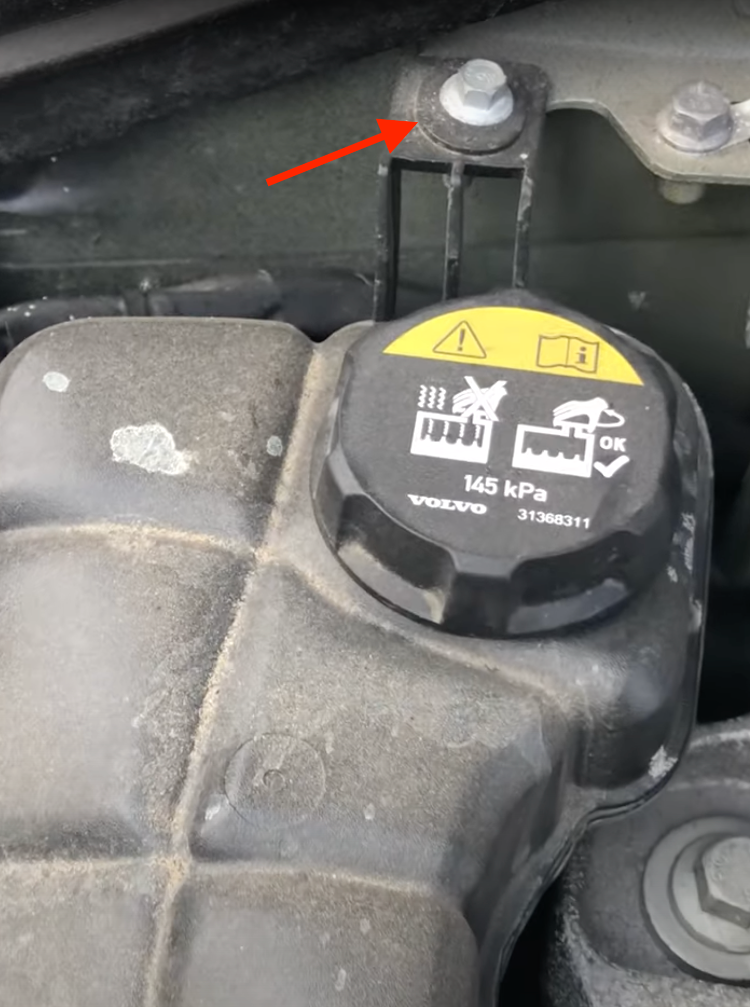

Hi, I've just noticed that the screw/bolt that holds the coolant reservoir in place on my 2016 XC60 is gone and am trying to figure out the part I need to replace it with (assume it's something I can just fix). Can anyone point me in the right direction? Is there also a nut that would go with it? Photo attached (not of my car).

Glad you got sorted. It is part #22 on this link part drawing:
https://www.volvocarstorontoparts.ca/a/ ... 04552.html

They actually had me order these two parts, which are now installed. I had the flange screw in my cart then talked to them and for some reason they had me change.
https://parts.volvocarsmanhattan.com/p/ ... 82757.html
https://parts.volvocarsmanhattan.com/p/ ... 86499.html

Interesting. They may have changed it up to a bolt and washer. Strange, but typical Volvo.
Glad you got it sorted though.
