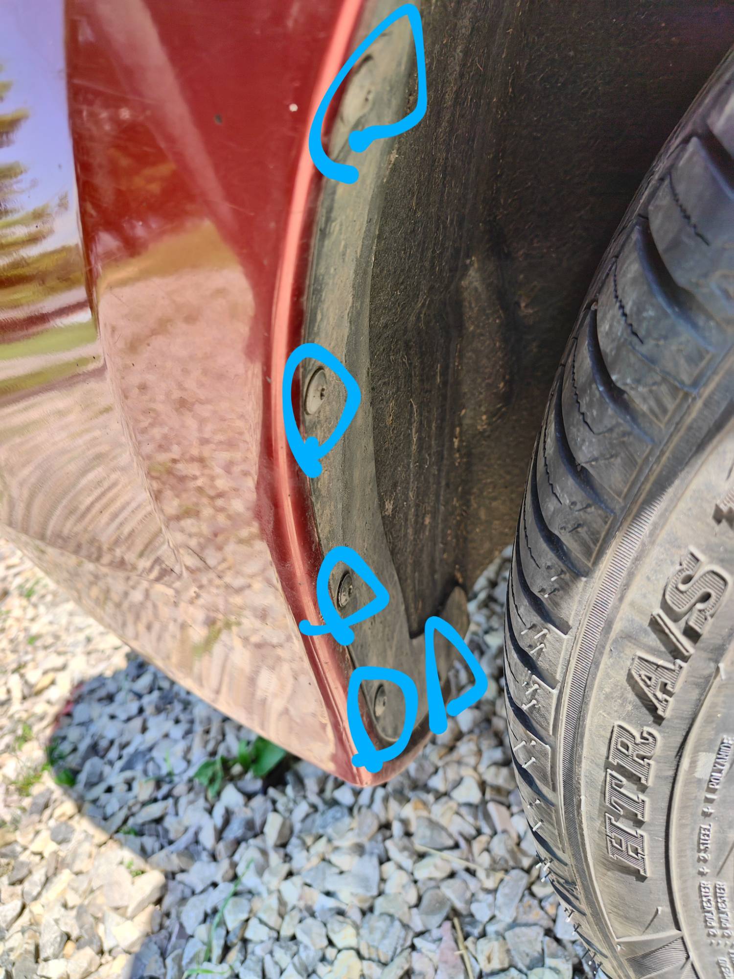

There will be 5 T20 in each wheel well, 4 down the outside edge and 1 on the bottom, see the blue circles below. Remove from both sides of car. The were only about finger tight.
Wheel well bolts
Wheel well bolts

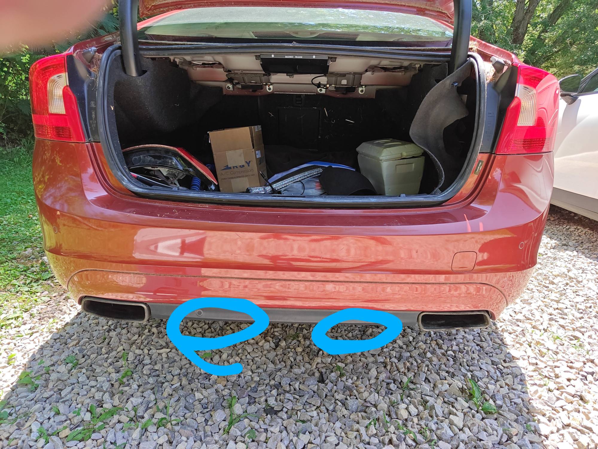

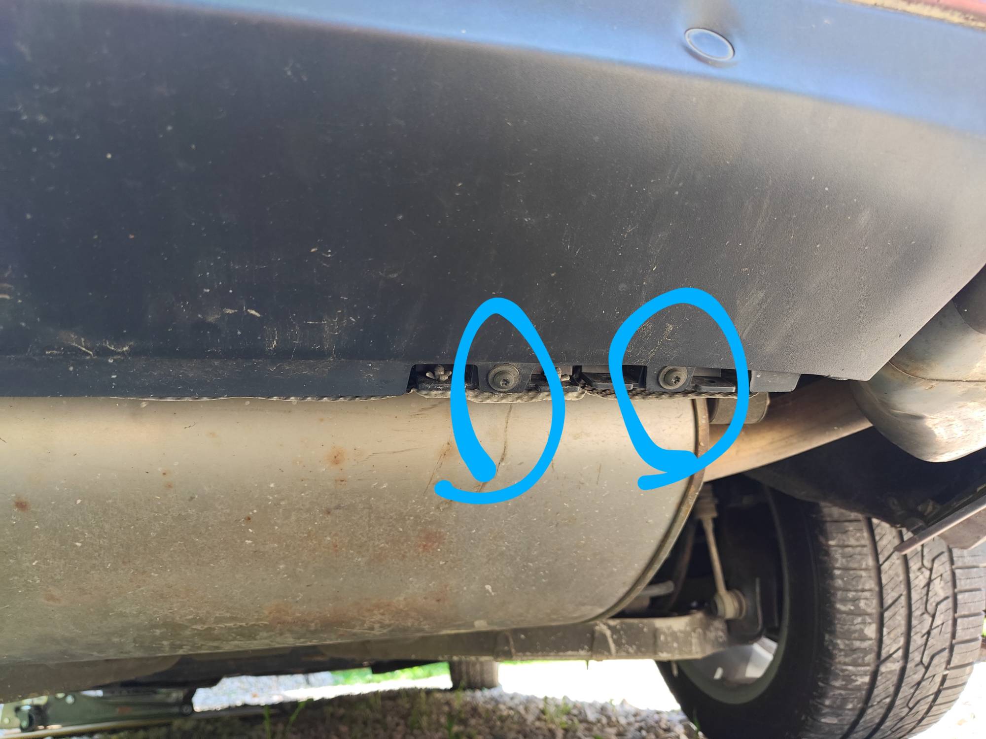

There are also 4 8mm bolts along the bottom approximately under the parking sensors if equipped.
Under bumper bolts locations
Under bumper bolts
Under bumper bolts

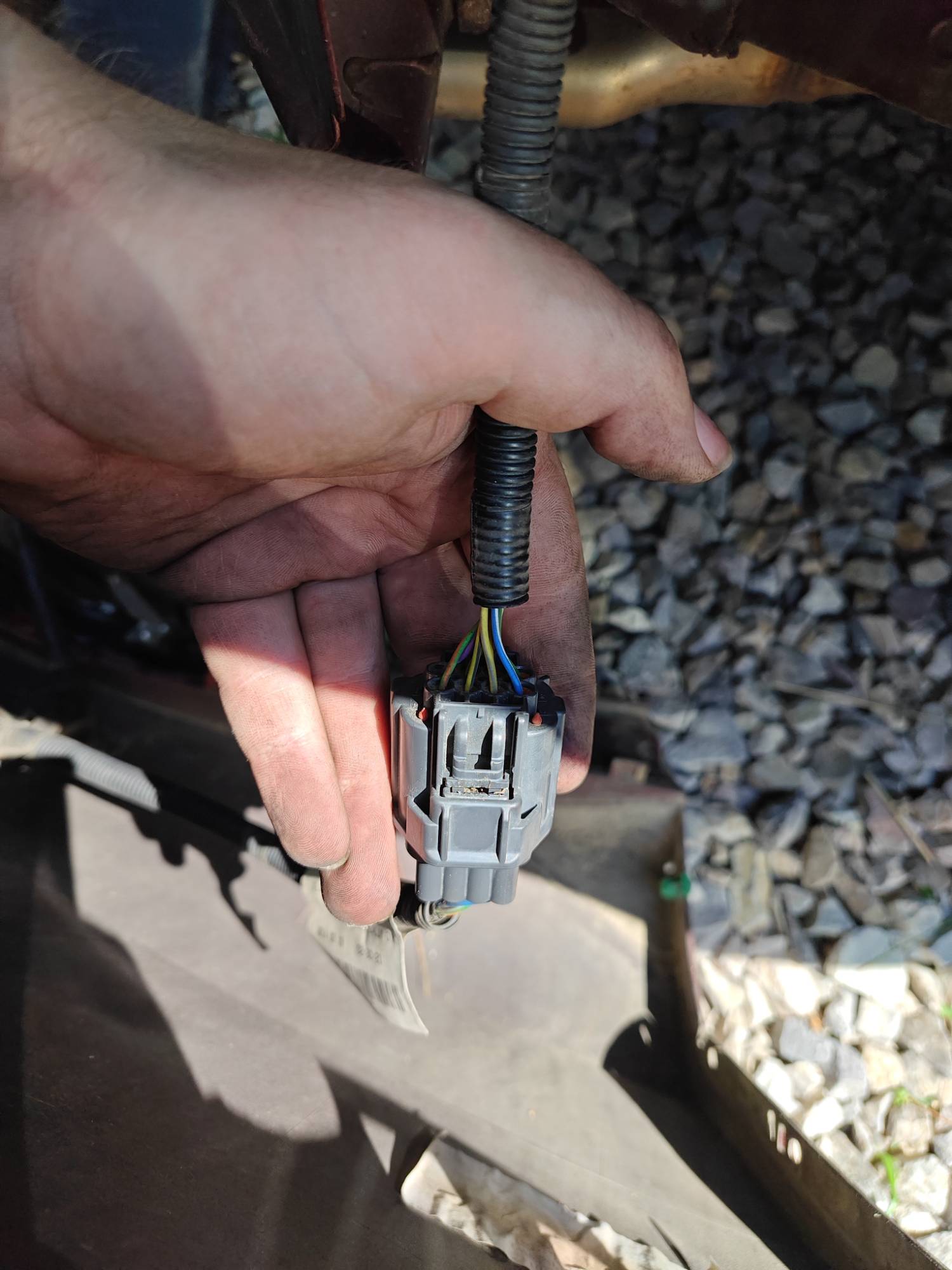

:!: There is an electrical connector for parking sensors(if equipped) in the bumper below the right taillight :!:
Once you have the right side of the bumper pulled out, remove the electrical connector for the parking sensors. Use the flat bladed screw driver to press in the release tab and wriggle the mating connector to release. The connector may be slid toward the wheel well to free it from its mount and give some more room to work.
Sensor connector
Sensor connector
Sensor connector 2
Sensor connector 2

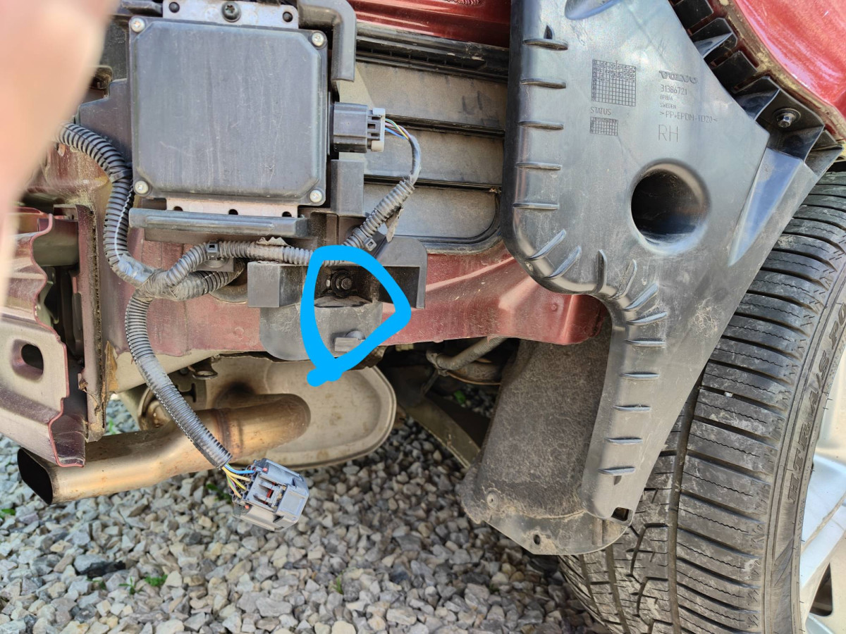

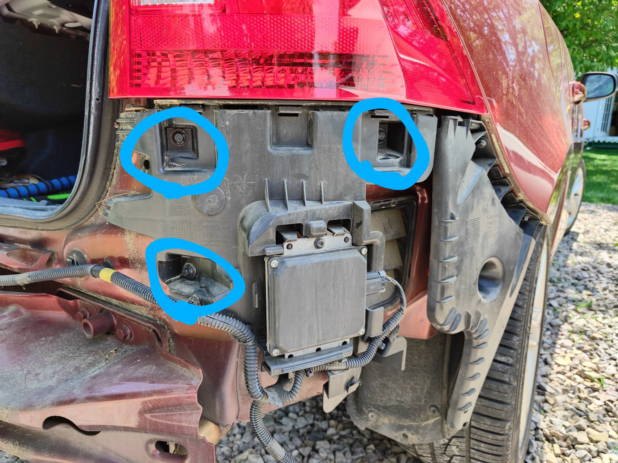

Remove the 4 8mm bolts holding the moulding in place. The moulding should now be able to be moved out of the way. I just flipped it down and let it hang from the harness. Be careful to not hit the radar unit (large box in center of moulding) when removing bolts.
Radar mount bolts 1
Radar mount bolts 1
Radar mount bolts 2
Radar mount bolts 2

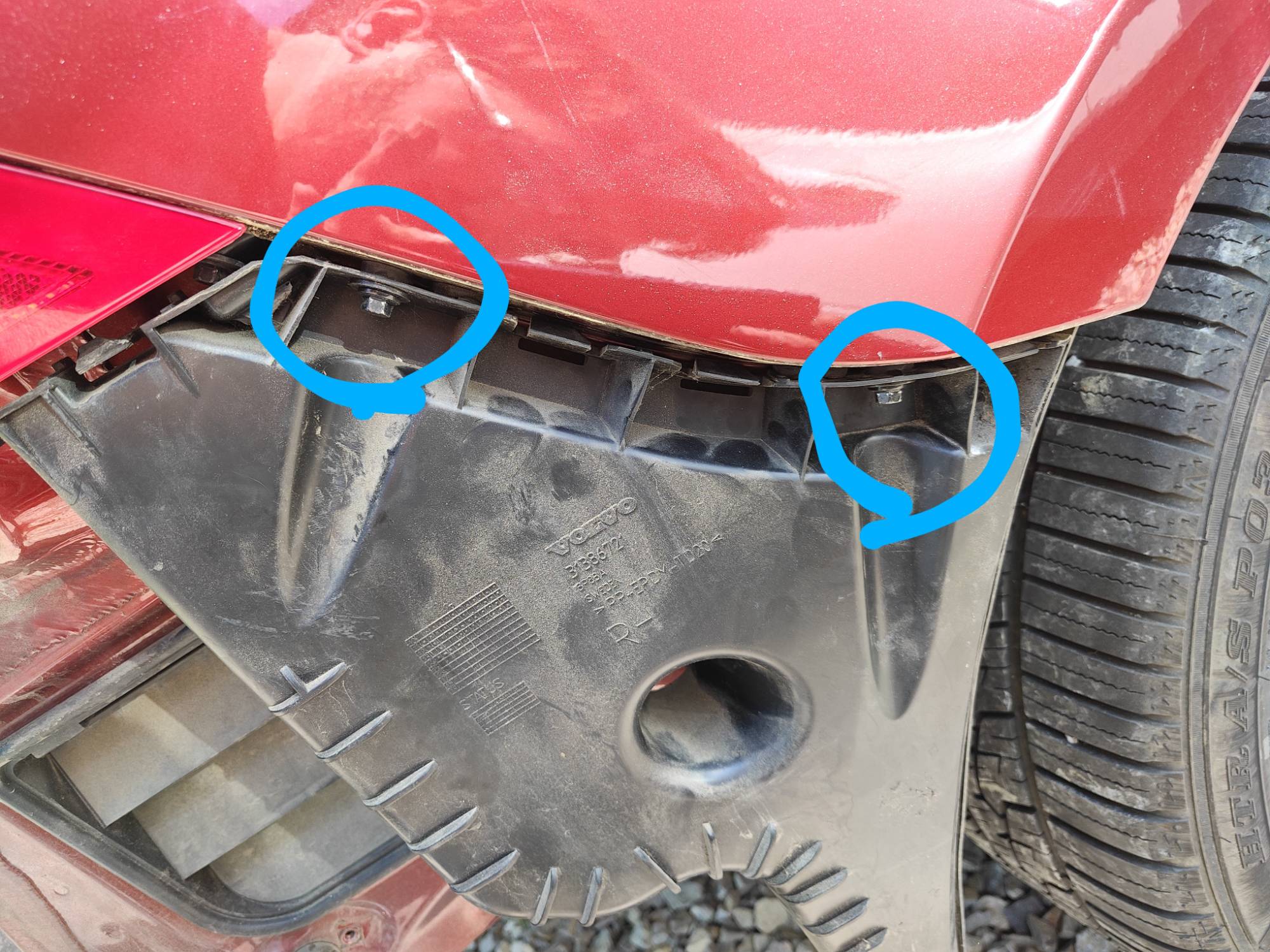

This one is a bit trickier. Remove the 2 8mm bolts along the top edge. You will then need to pull straight down on the top edge to release the pins from the holes in the body, then while pins are out pull top edge toward you, away from the vehicle until clear of the body. This will take a bit of force to do. You can then lift straight up on the moulding to remove from the center retaining post.
Wheel well bolts
Wheel well bolts

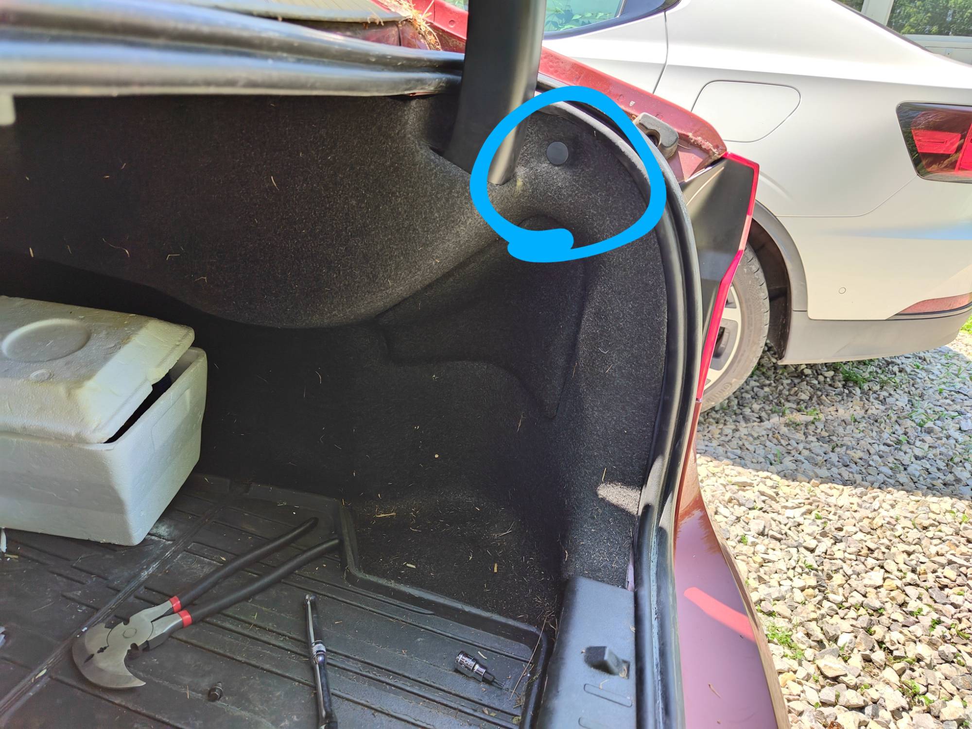

Step 4: Get access to tail light inside trunk
Remove the panel used when changing bulbs. It should just pull out.
Light change panel
Light change panel

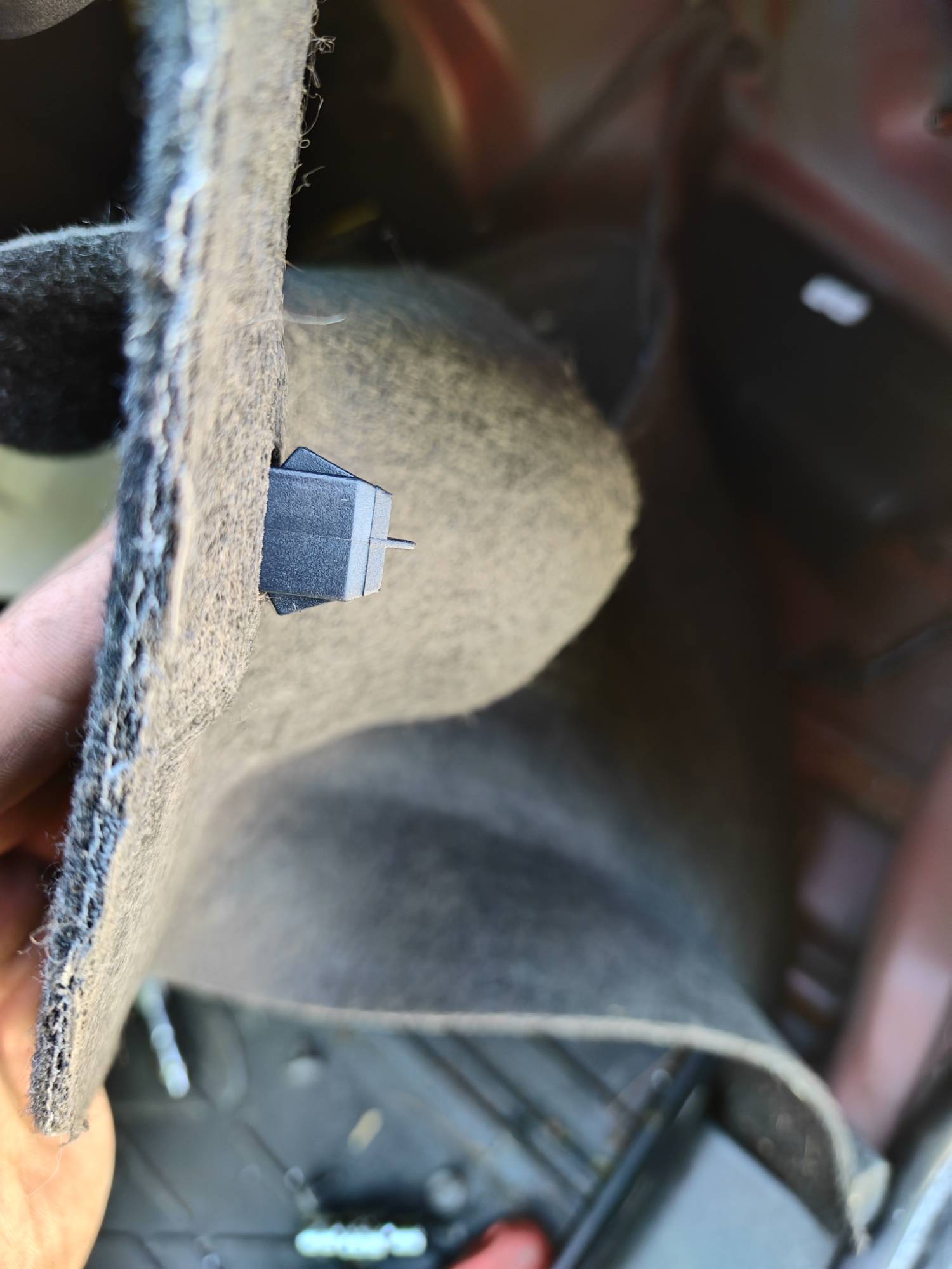

Reach around to back side of the plastic panel clip and squeeze in tabs to release.
Pin to remove
Pin to remove
Pin release tabs
Pin release tabs

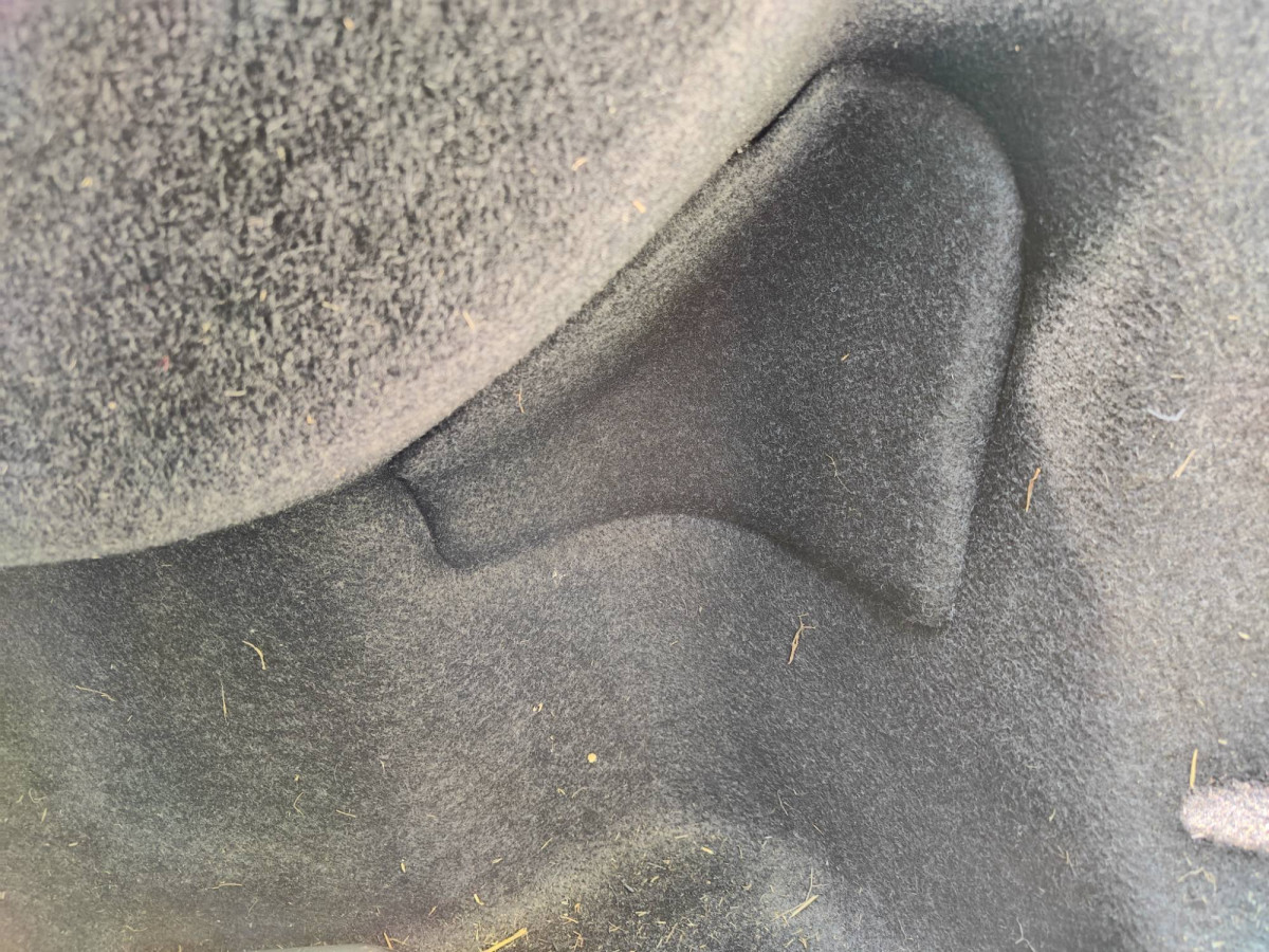

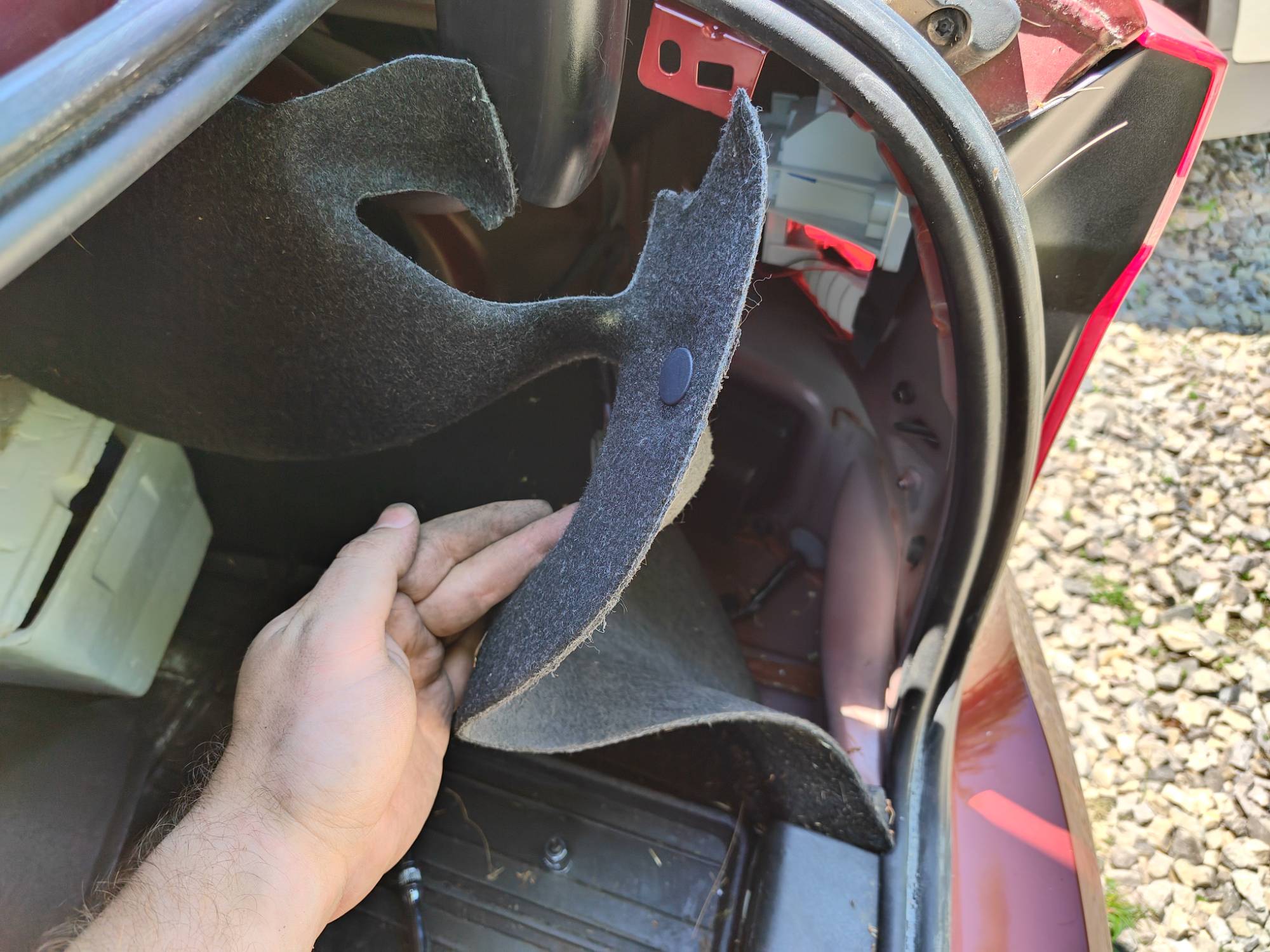

Pull carpeting straight out. Mine was split around the back side of the trunk hinge so it could just be pulled out and around it. If yours isn't you may need to make a cut.
Carpet pulled back
Carpet pulled back
Pull carpeting back, you should have enough room to work without needing to remove it further.

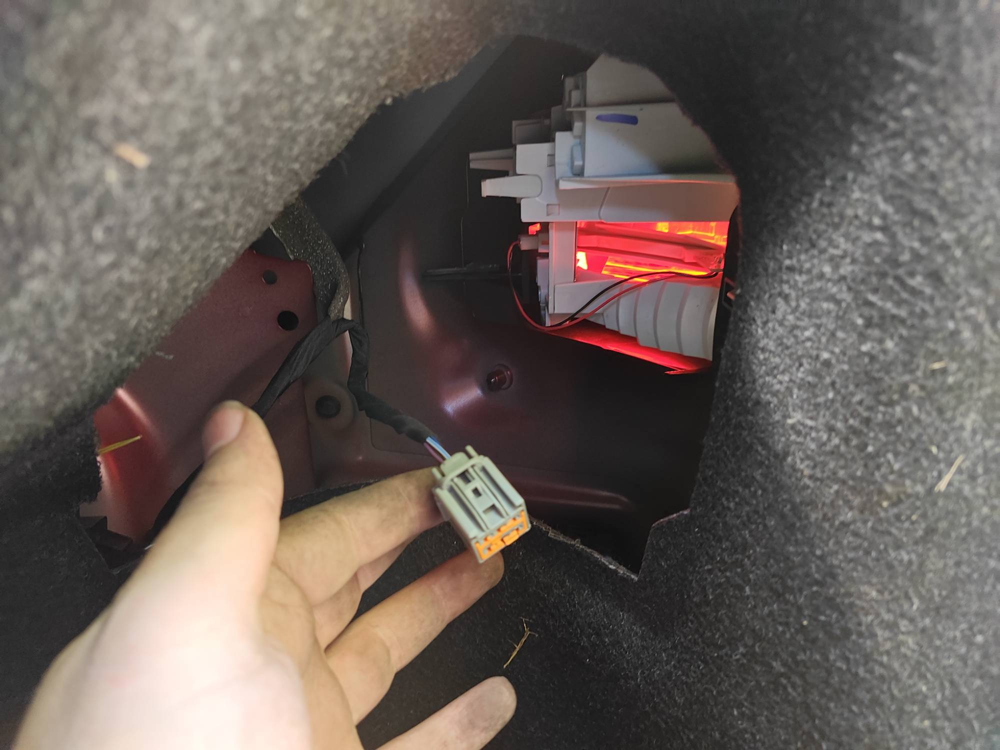

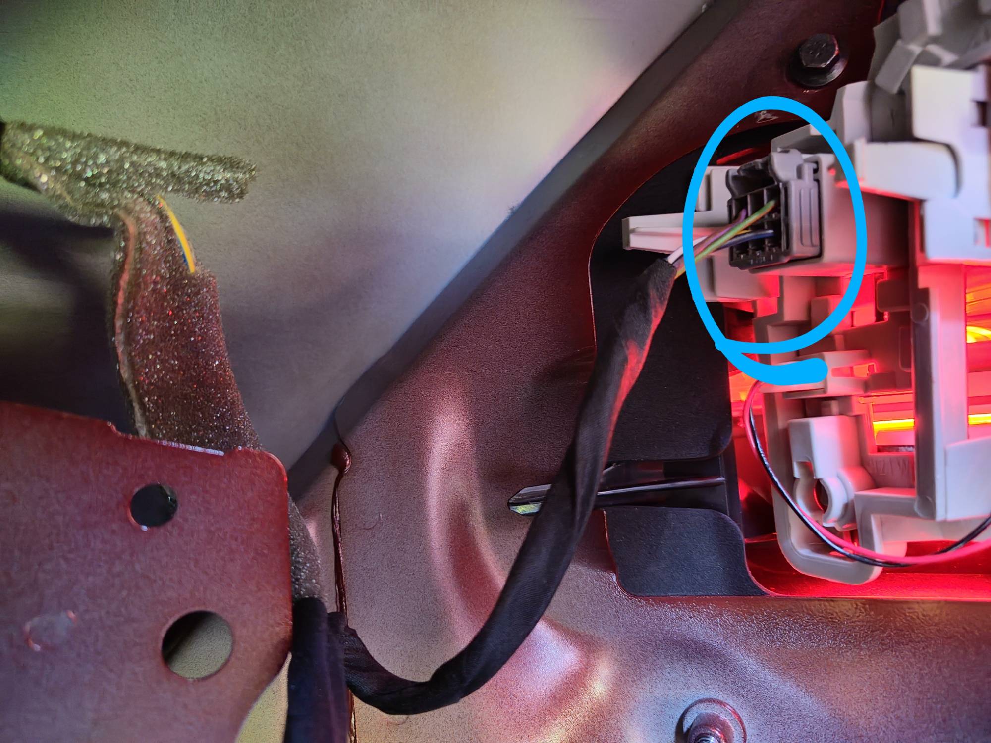

Remove the electrical connector from the back of the tail light.
Tail light connector
Tail light Connector disconnected

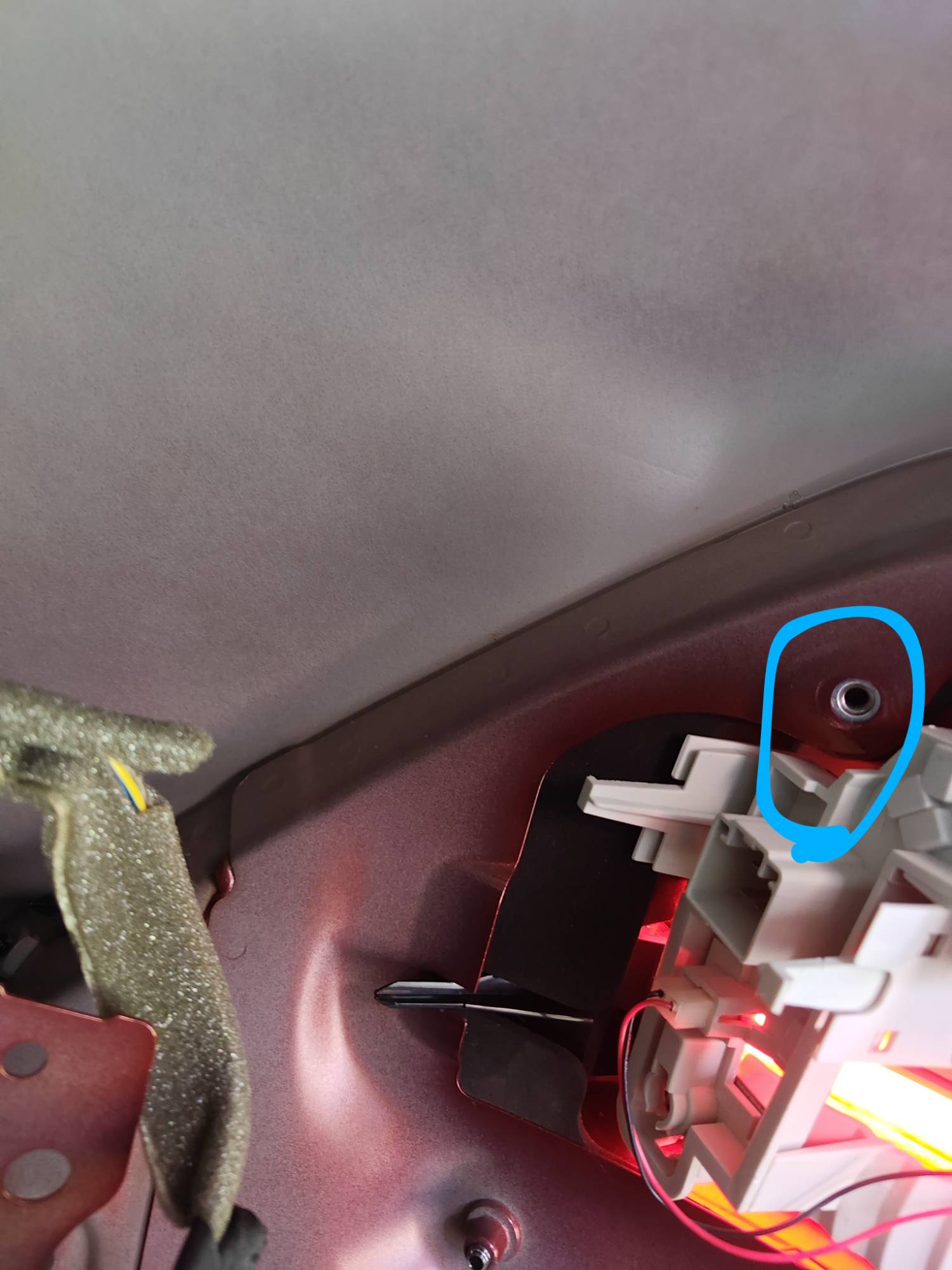

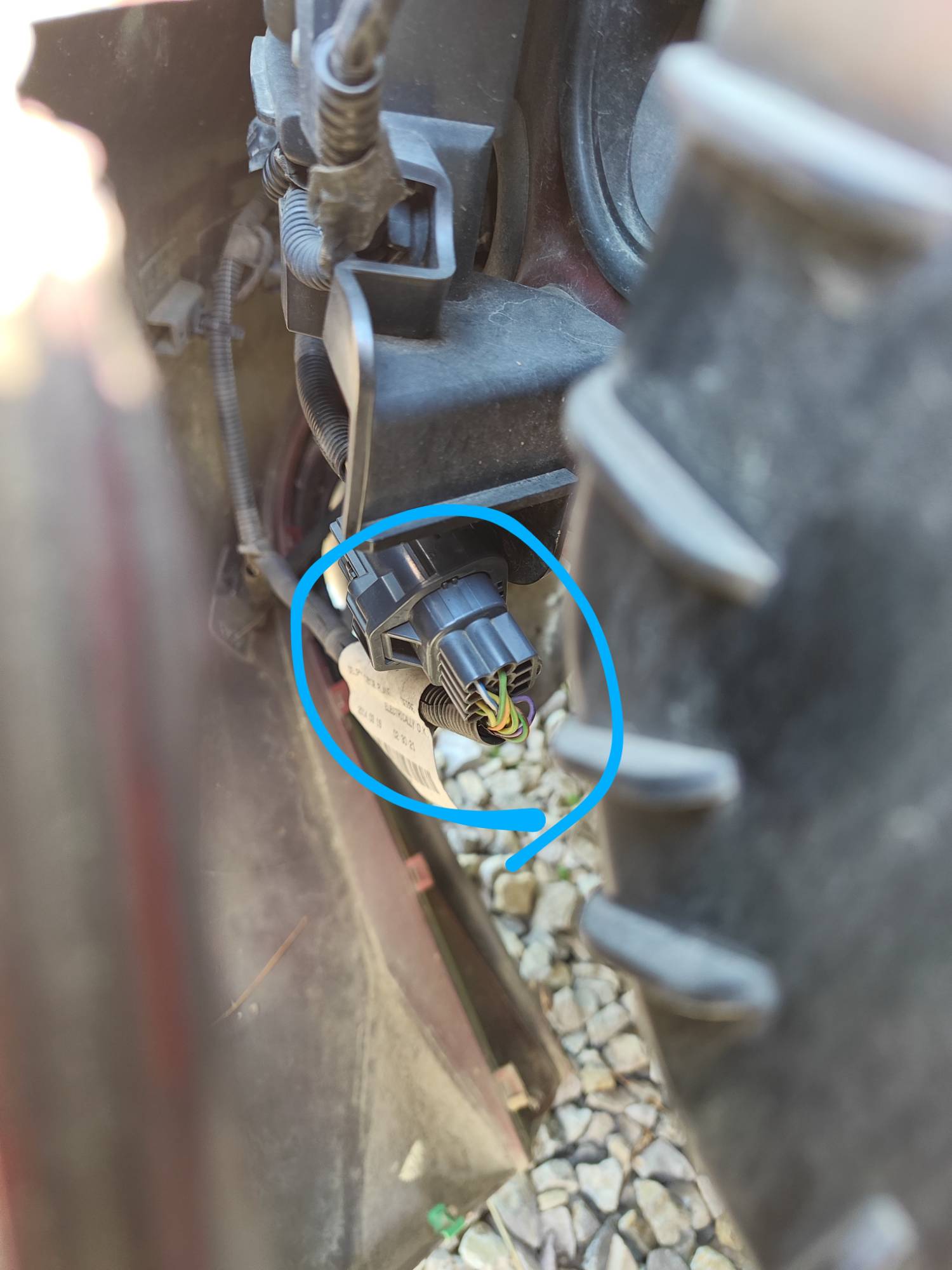

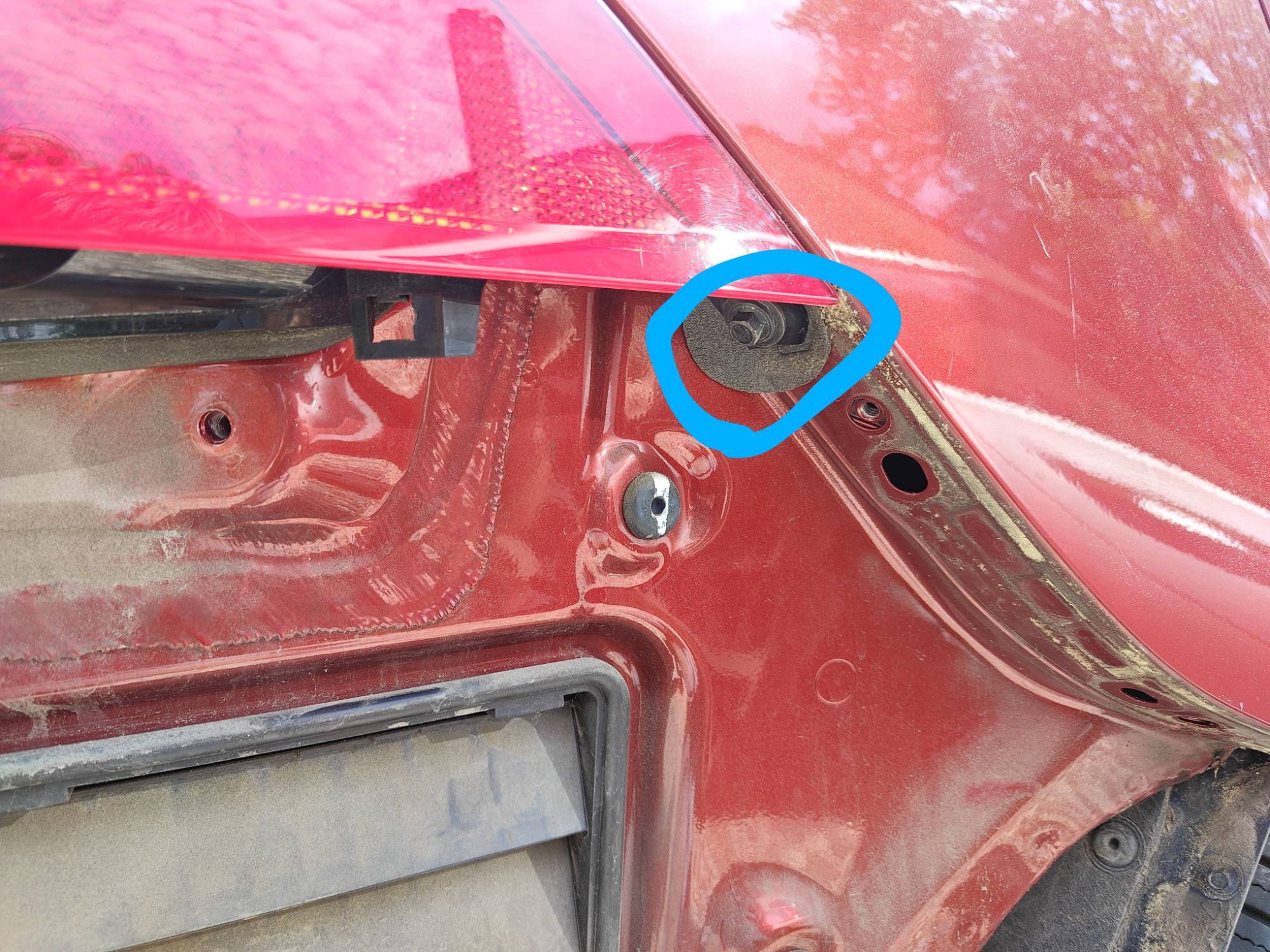

Remove 1 8mm bolt from outside edge of tail light near wheel well. This is the reason we needed to remove the 2nd moulding piece.
External tail light bolt

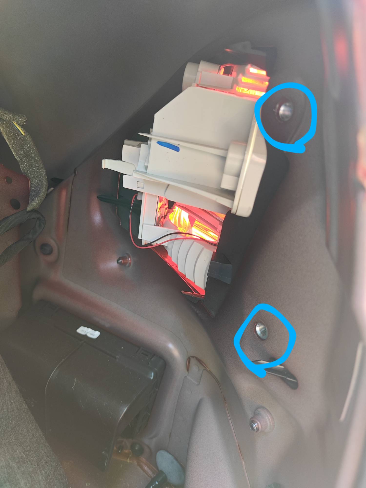

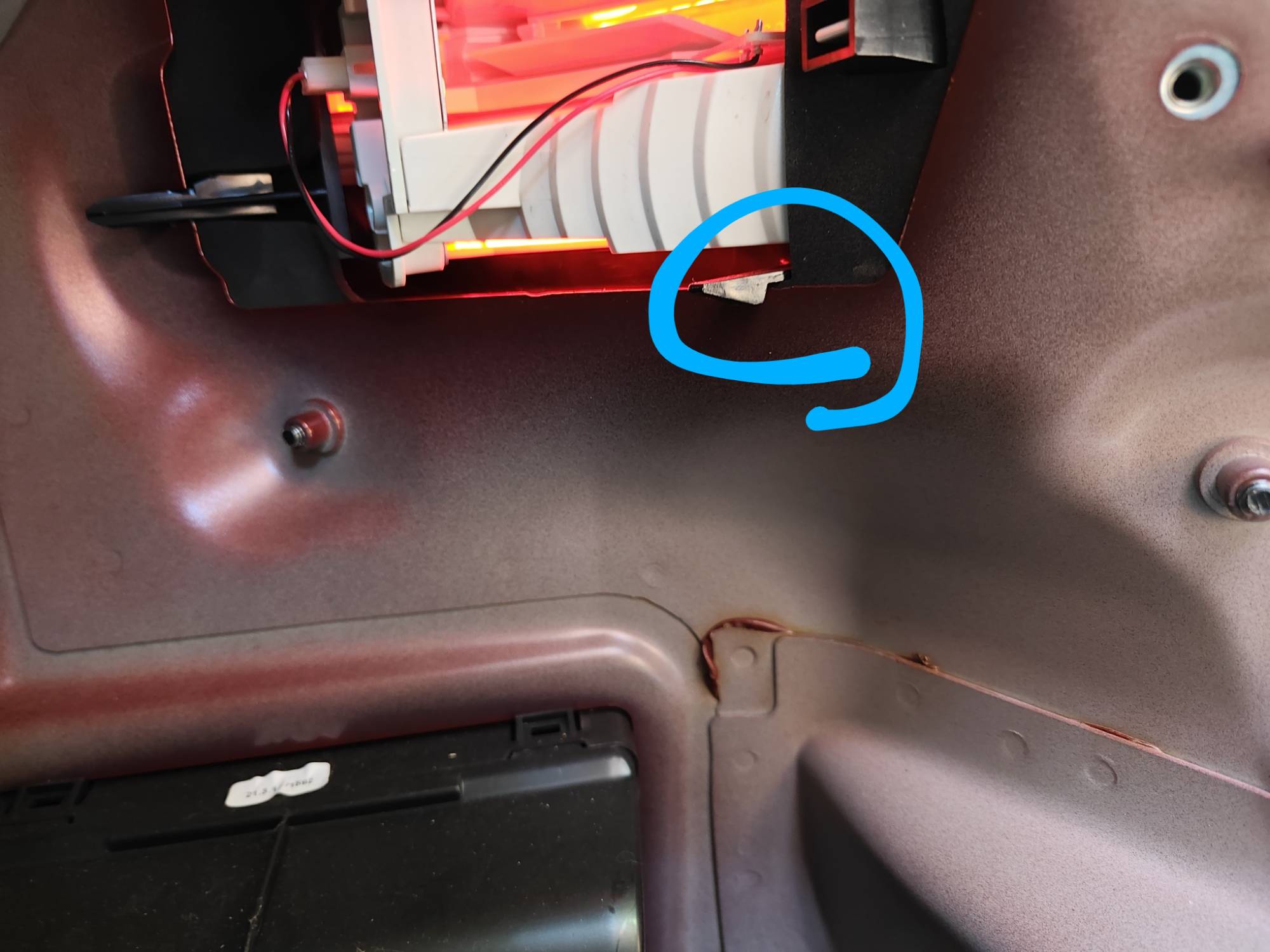

Remove 3 bolts from inside of trunk holding the assembly. You can use you new assembly to get an idea of their positioning.
Tail light bolts 1
Tail light bolts 1
Tail light bolt 2
Tail light bolt 2

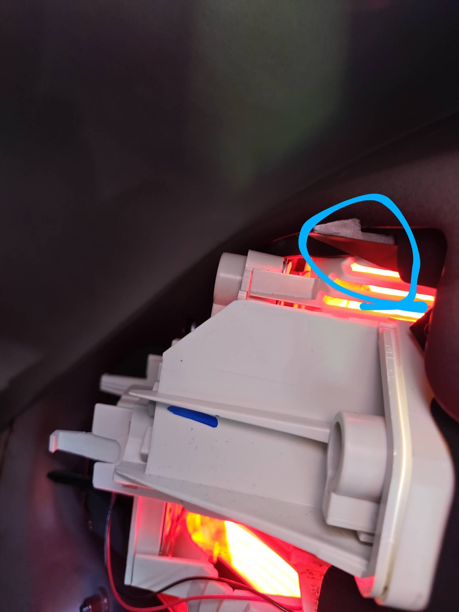

Release the 2 clips holding the assembly in
Pull assembly straight back to remove.
Tail light clip 1
Tail light clip 1
Tail light clip 2
Tail light clip 2

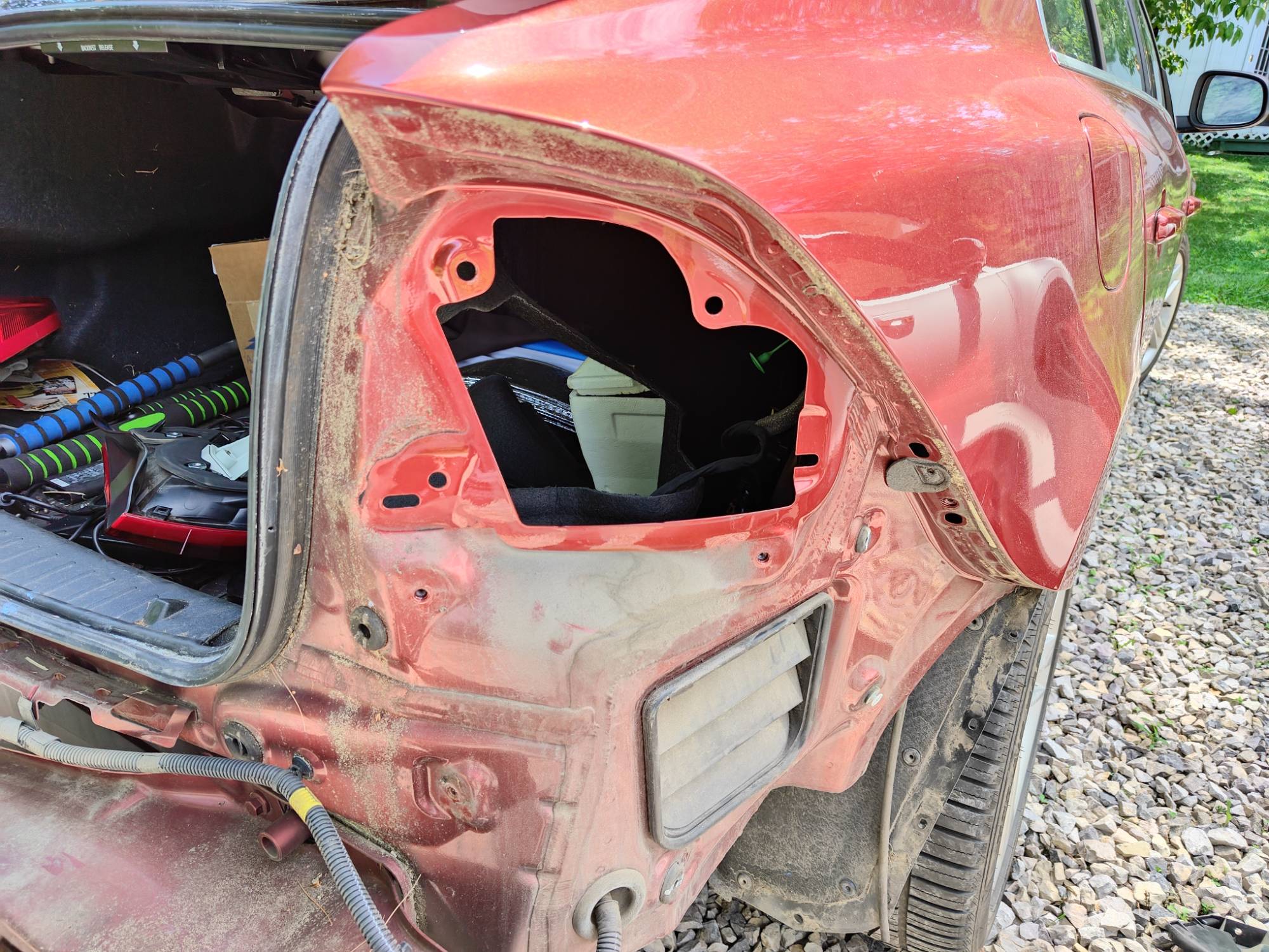

Removed light
Removed light
