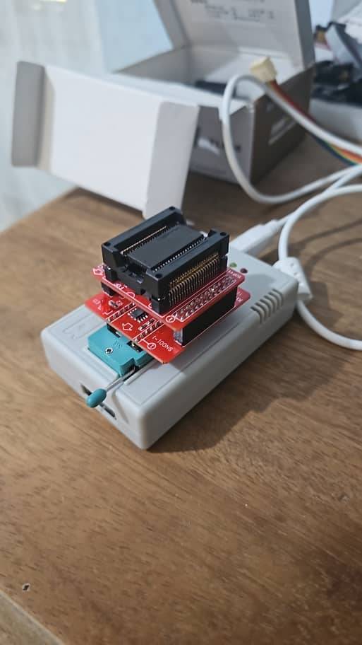

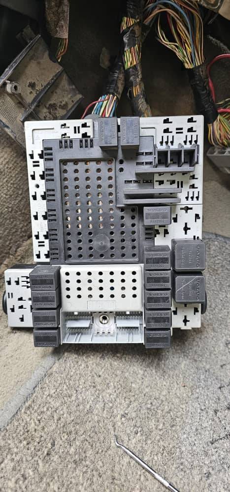

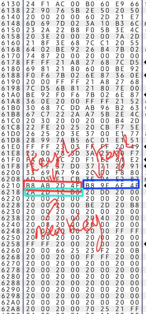

After read the eeprom MT28F400 and add a new key (new ID48 transponder) and install the cem in the car I had this problems:
The car don't start
All lights in dashboard off
After make searches I think I need dump file for cem 8688513 flash memorie MT28F400.

I need the dump CEM P2. My file is corrupted.
Or I have to send my CEM to professional to fix my CEM and add a new key
Does anyone know how can do this work ? specially in Europe
