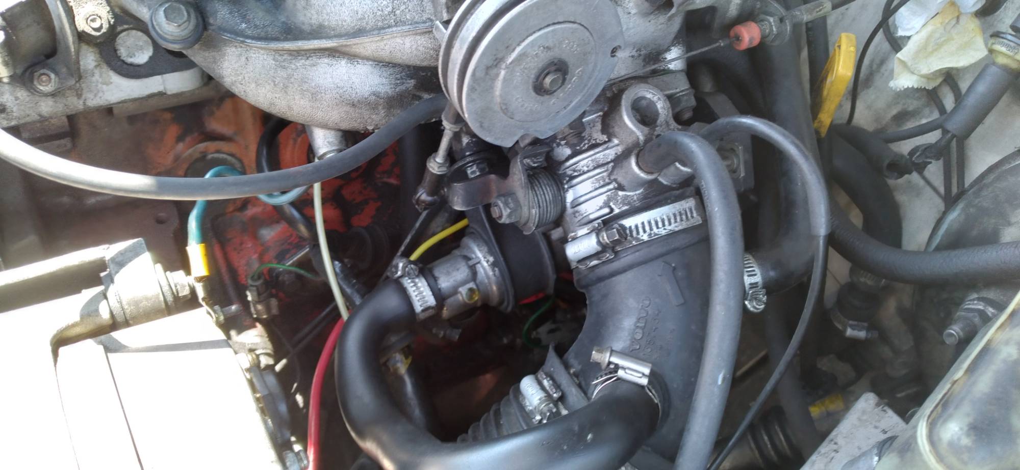

Someone have a diagram for the location of the Air Fuel mixture screw?

It is the plastic knob in a plastic valve body on the front of the throttle body. If you plan to adjust it, mark it so you can return to the original setting if you find you have made things worse.
You may just have a vacuum leak somewhere.

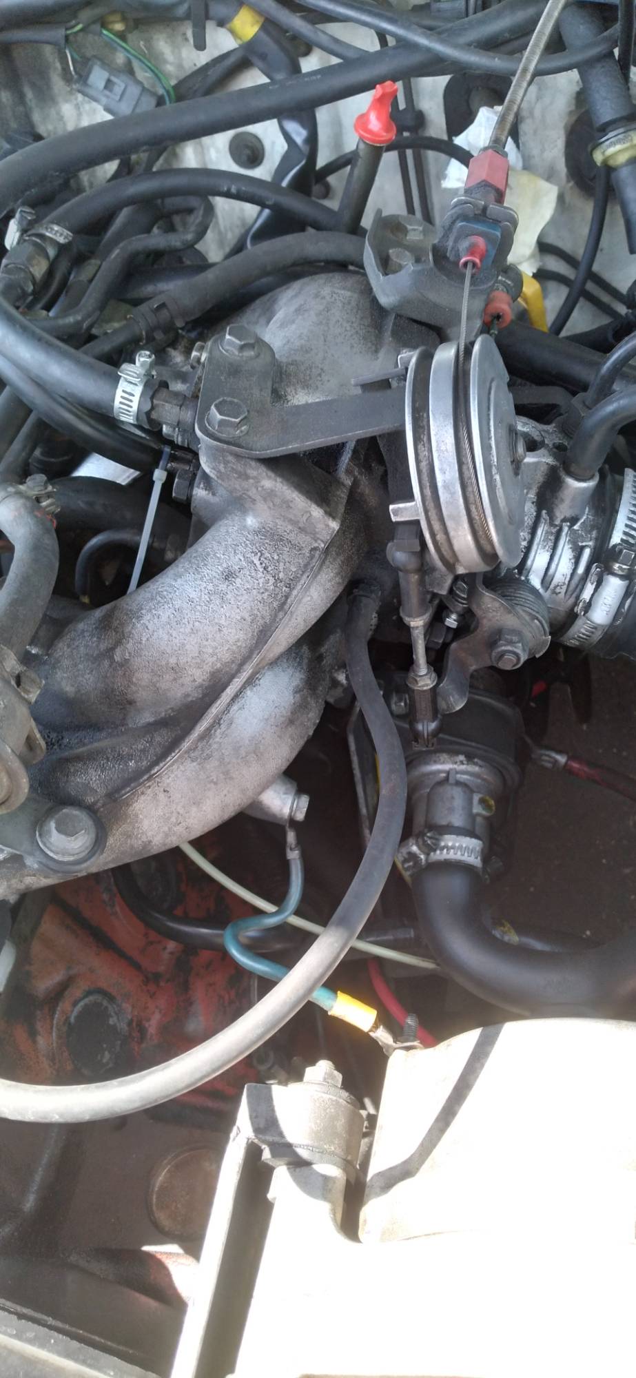

There's nothing there.volvolugnut wrote: 16 Aug 2024, 17:13 It is the plastic knob in a plastic valve body on the front of the throttle body. If you plan to adjust it, mark it so you can return to the original setting if you find you have made things worse.

Yes, no knob there. 740 is different. I will try to find something about A/F adjustment.
Turbobricks forum posting:
https://turbobricks.com/index.php?threa ... ix.375543/
No pictures, but discussion and note that there is no adjustment possible.
