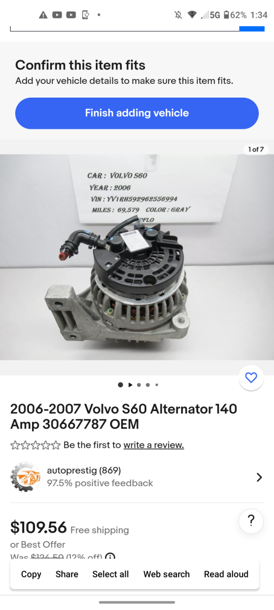

Most Bosch alternators are rebuilt (X), a few are new (N).
The rebuilt quality is inconsistent.
If you can find a Bosch AL0854N, then go for it.
Otherwise search eBay for Genuine Volvo alternator with low mileage (< 100K miles).
I only buy from eBay seller with proper VIN tag and clearly states the mileage.
This is a good example of alternator with only 70K miles.
PS: sometimes one can replace just the VR...

P2 is CCW rotation.
Alternator lifepsan is 150K-200K, so 185K is about right.
Likely just the VR but at that odo reading, get a good used alternator.
AL0854N = 140A type
AL0832N = 160A type
Just find out what is in the car and replace with the same amperage.
AL0854N = 140A type
AL0832N = 160A type
