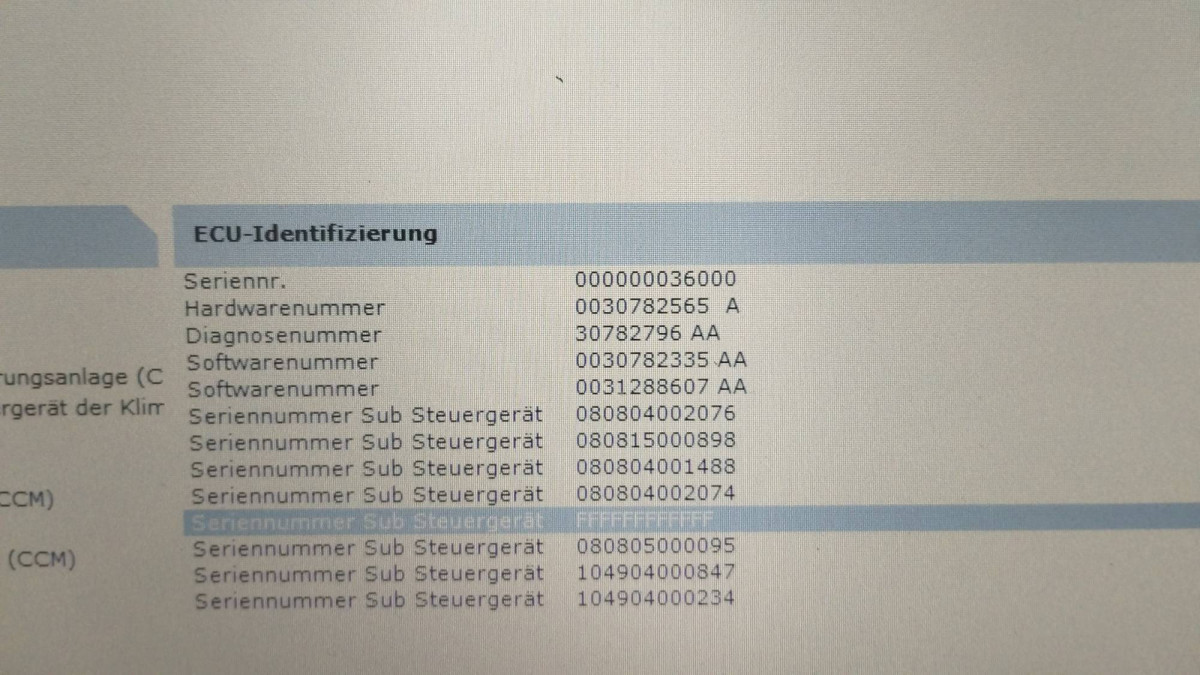

Hi there. Got from one day to another following problem.
Driver side hot air and right side cool air. And the upper vents not working. Made read out with vida and found in ccm following config.... Seems that one modul ist not corresponding with ccm. Is it possible to check with vida which one that is?
Fault codes CCM 70,71 and D16
Some tips?
