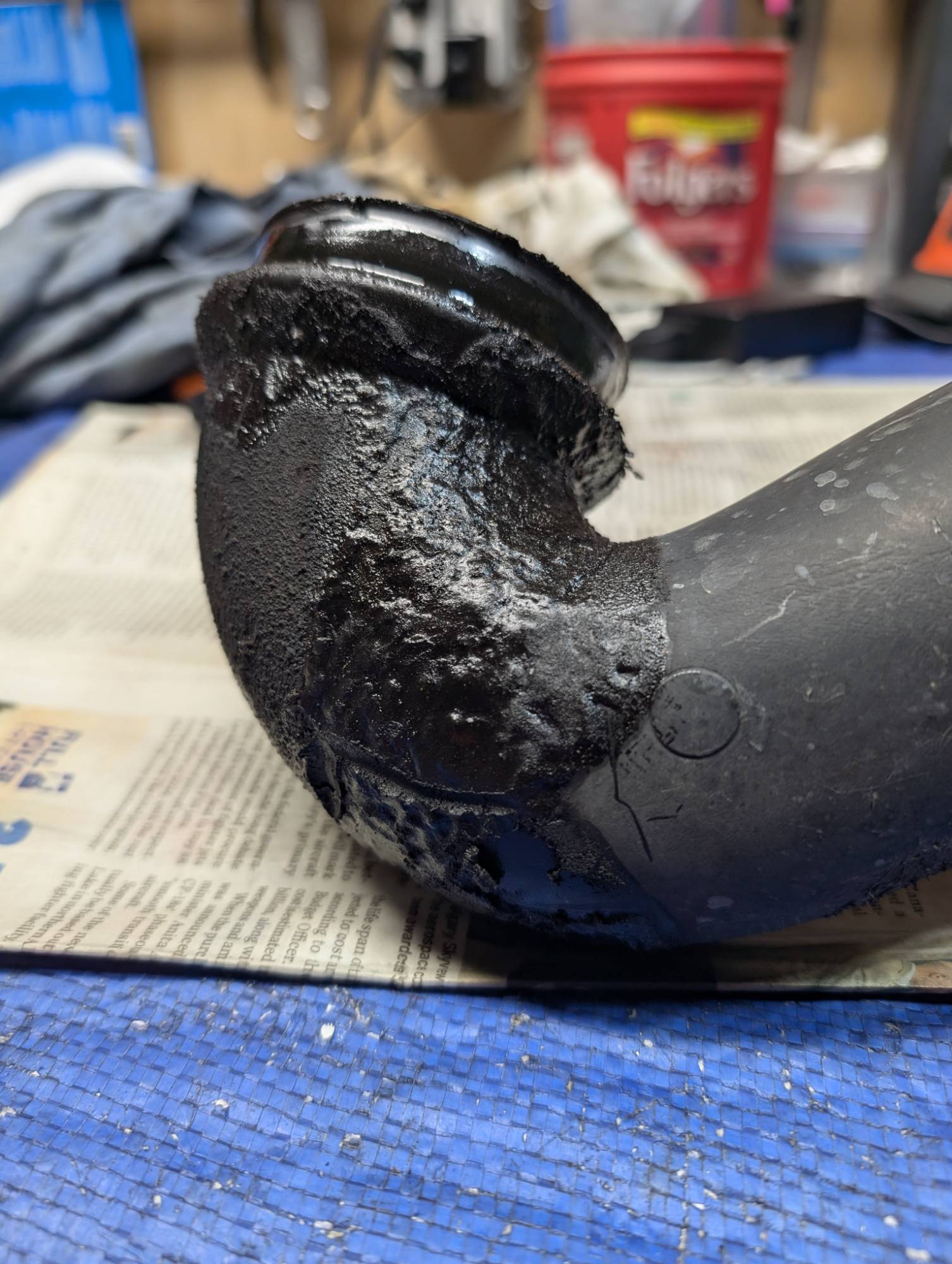

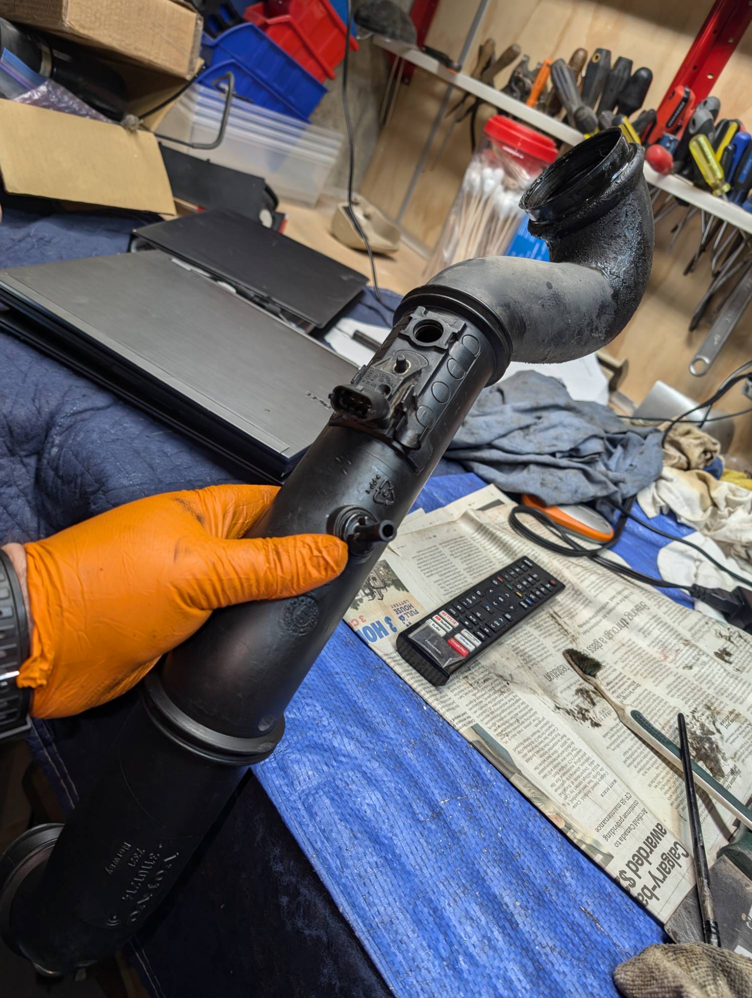

At the top of the picture you can see all the oil sprayed from the split turbo to intercooler inlet rubber hose. This is from an 01-02/03/04? turbo engine car. I believe this is only fitted to 01-02 turbo cars, but I found one on an 04 S60 turbo, but an 04 XC70 had the newer version without the MAP sensor and the inlet temp sensor (already removed from pipe)

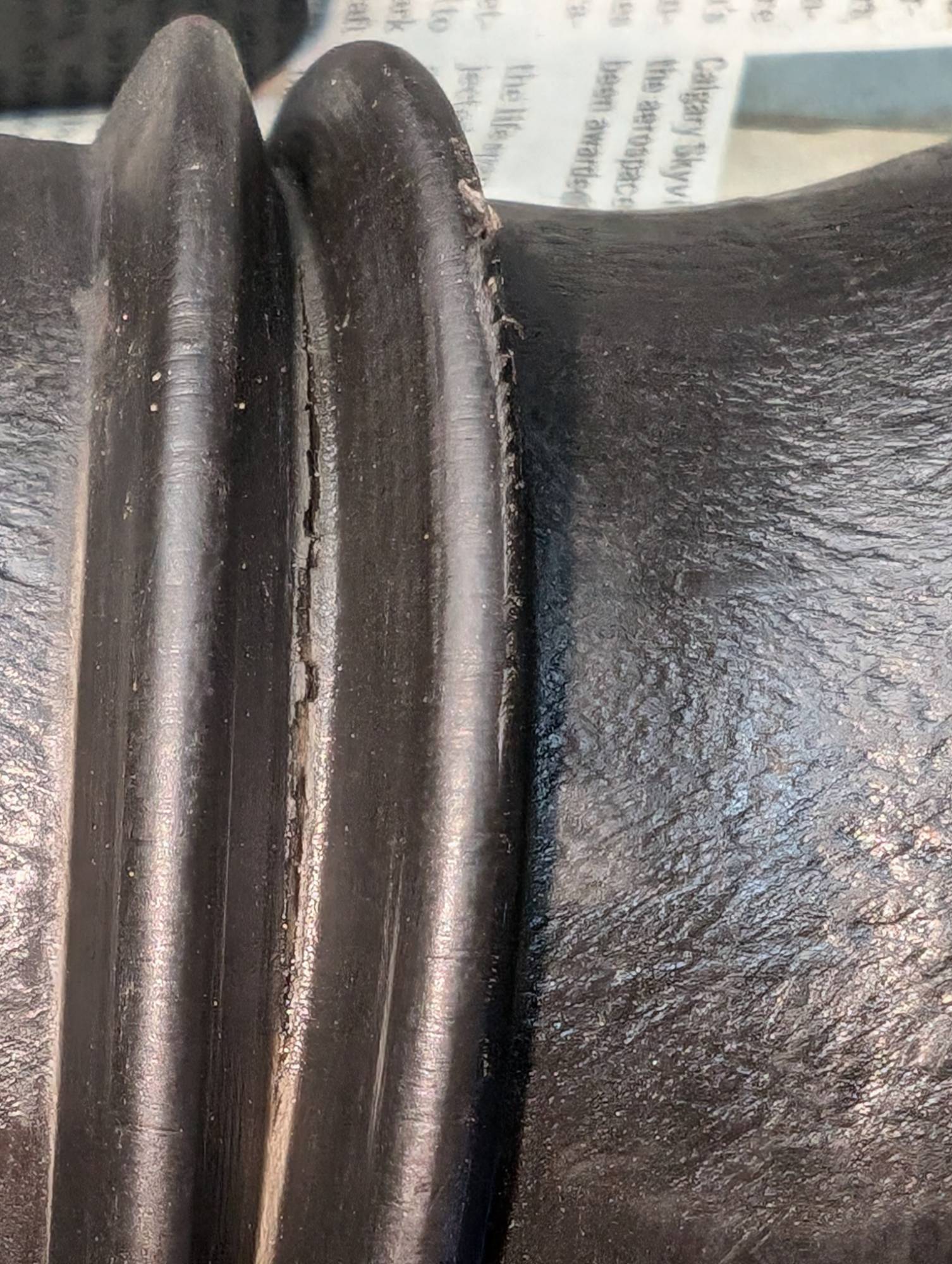

Below the crack in the intercooler to TB pipe at the middle flex joint of the original pipe

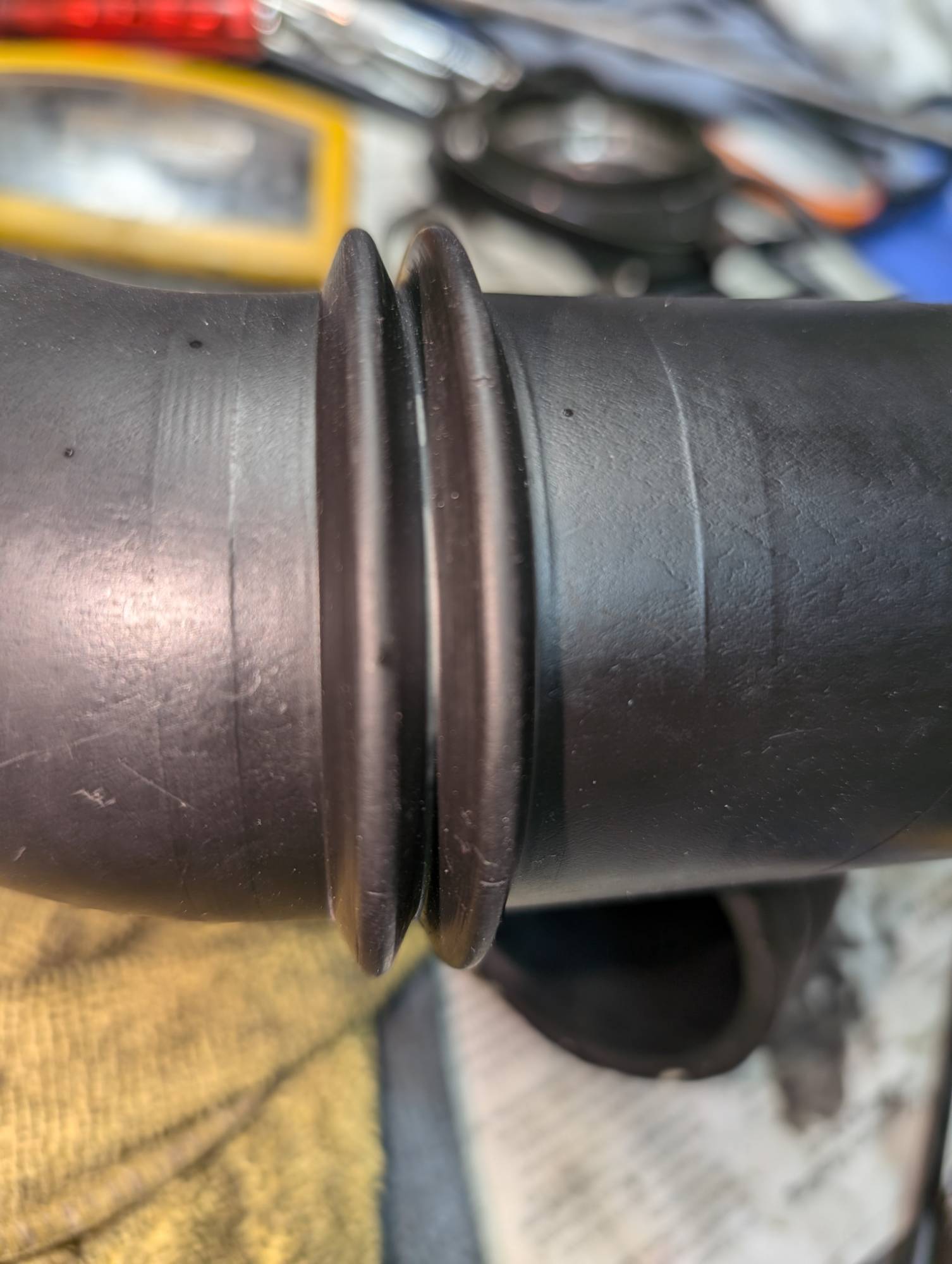

Below is the stress point on the 'new' pipe:
