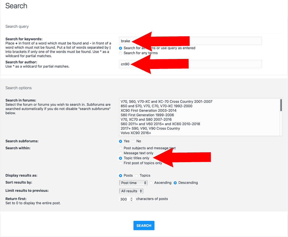

search.php?keywords=brake&terms=all&aut ... mit=Search
Here's how I got there. Go to search search.php then:
