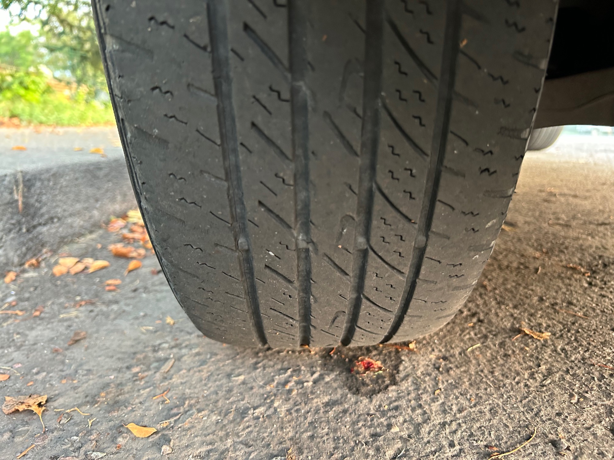

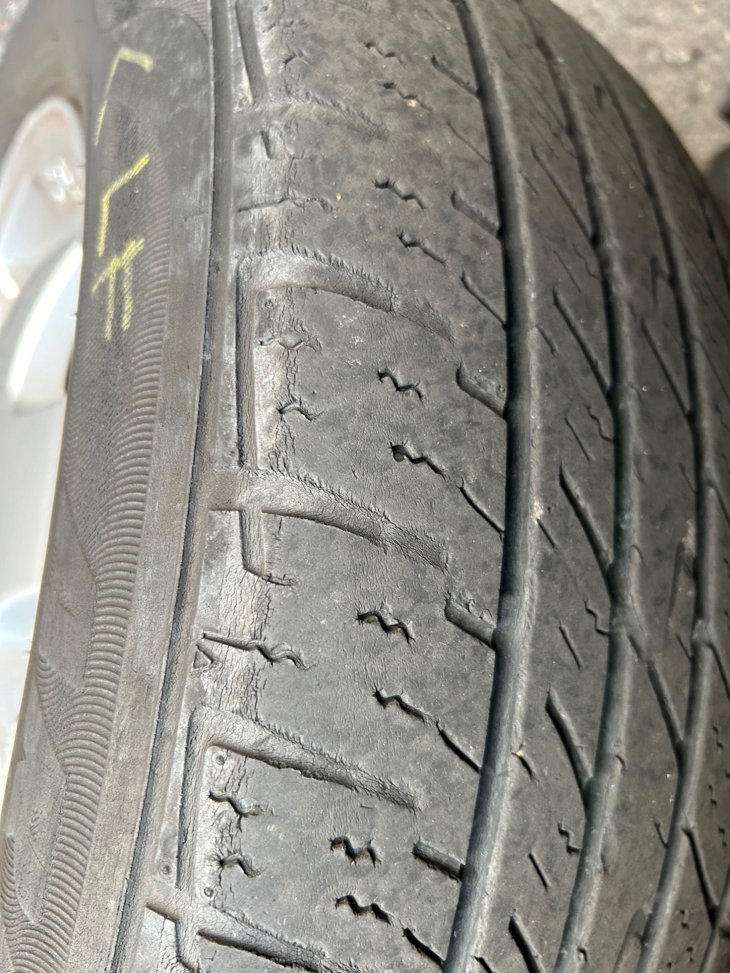

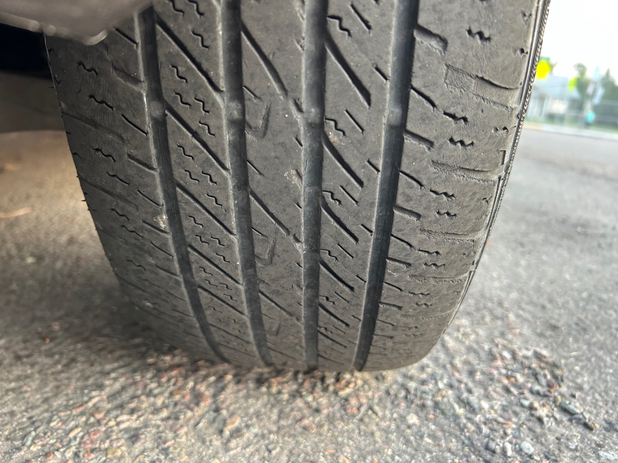

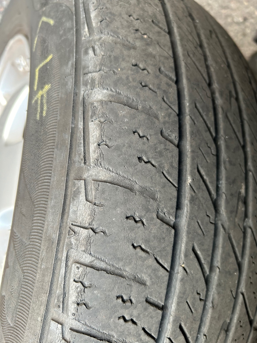

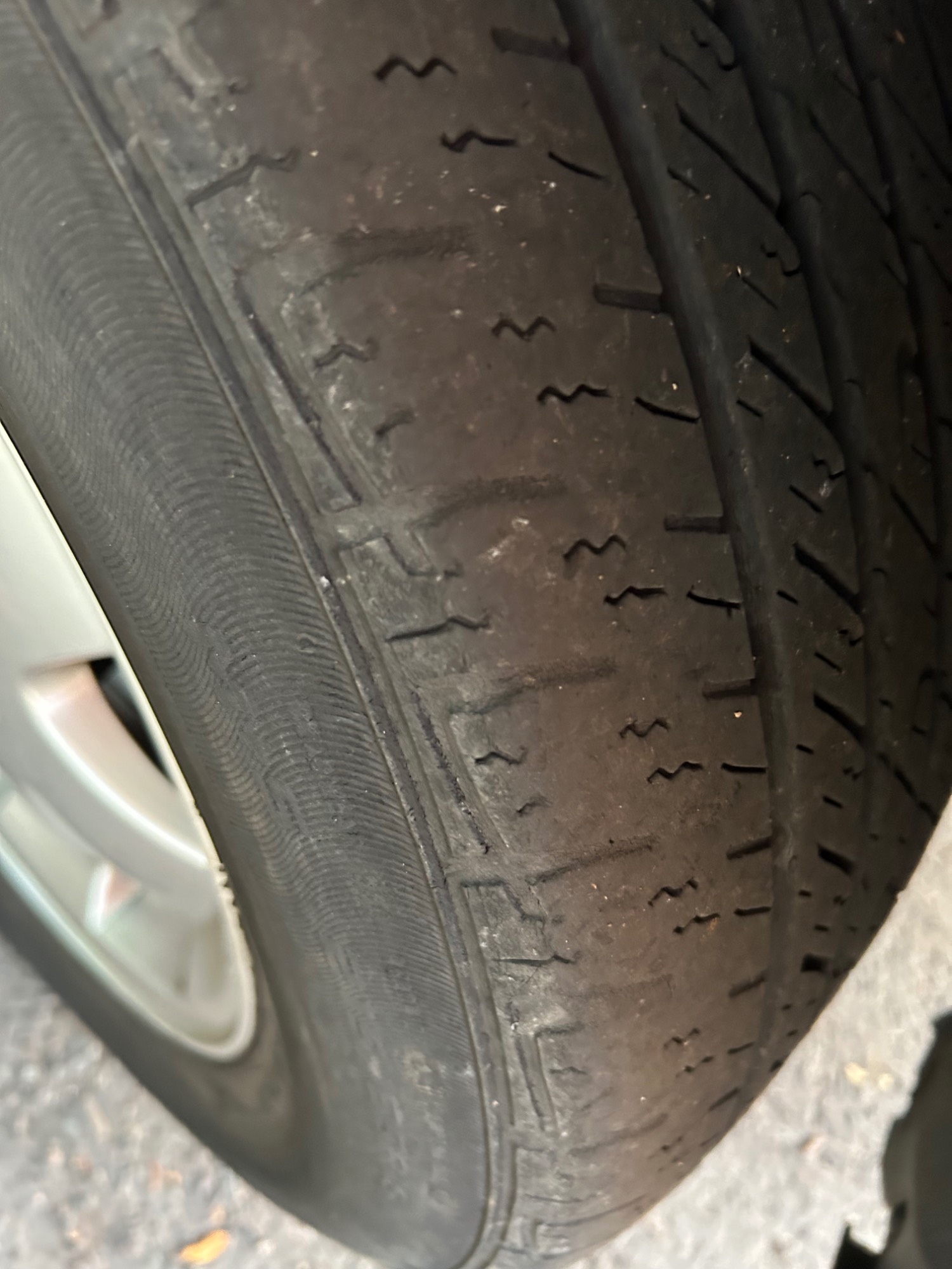

LF tire.
Note that the fronts are getting close to the bars - I’m swapping these to the back and using them up until putting the snows on.
I can see maybe some underinflation and wear at both edges?
RF - which is where I think most scrubbing occurs with u-turns, etc.

I’d agree with scot850, looks like a positive camber issue, you can check real quick with a carpenter’s level. There’s a small amount of camber adjustment on the strut mounts that can be achieved easily with the two bolts 18mm head and 21 mm nut. I usually push the wheel top as far in as it will go, resulting in about 1/2 degree negative camber, this is a good baseline or you can get an alignment shop to get it exact. This should also clear up the scrubbing. Are those tires the correct size? I had a worn out set of winter tires that were about an inch shorter than spec that caused the scrubbing effect that you describe that was resolved with a correct height new set of tires.

How old are those tires? They look as bad as the 13 year old ones on the 02 I am working on! They look to have cracks appearing between the treads in your 2nd last picture.
