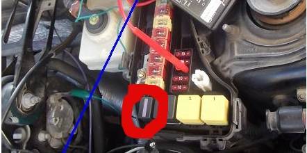

Probably leaked out from evaporator.
Remove a connector close to a firewall and jump the pins on the connector side while engine is running... blower and ac turned on.
Jump only for a few seconds.
If clutch engages that way...the system is empty.

My mistake Misha. The evaporator remained the same, but it was flushed with air conditioning cleaner until clean.misha wrote: 09 Sep 2024, 13:25 You didn't mentioned that evaporator was replaced in 1st post...only compressor,dryer and radiator(condenser).
Are you referring to jump in the air conditioning relay socket - black-purple ? (red circle)
