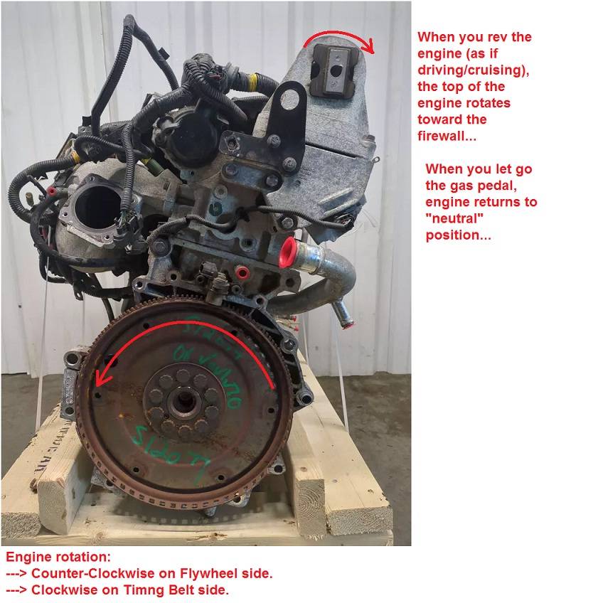

Mounts #4 and #5 are not really a mount, rather they are "shock absorber" as you rev the engine, the
top of the engine rocks back and forth (toward and away from the firewall) a bit, maybe 2-3 mm or so.
As a test, remove the 18-mm center bolt on the top mount, rev the engine a bit to see how it moves.
Also, by removing this center bolt, you have an idea of how much vibration you have at idle.
Sit in the car with engine at idle and this bolt removed, the amount of vibration you feel comes
from only #1, #2, #3 and #4, as #5 is now disconnected.

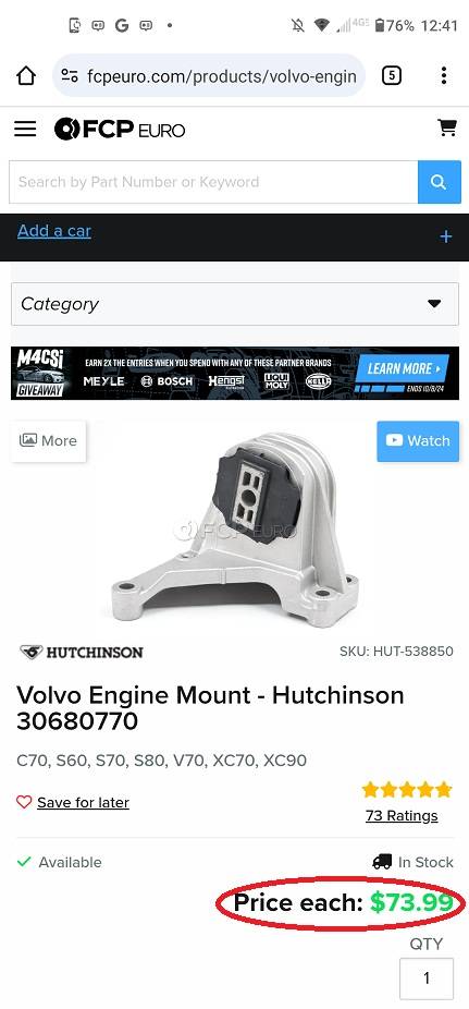

Anyway, I have found that buying #4 and #5 is a waste of money bc I now rebuild them using FI hose. FYI:
- Hutchinson brand (Poland) is now $74.
- Lemforder (China) is now ~ $44.
The metal part (the aluminum component) does not break. You basically pay big bucks for a piece of rubber!
