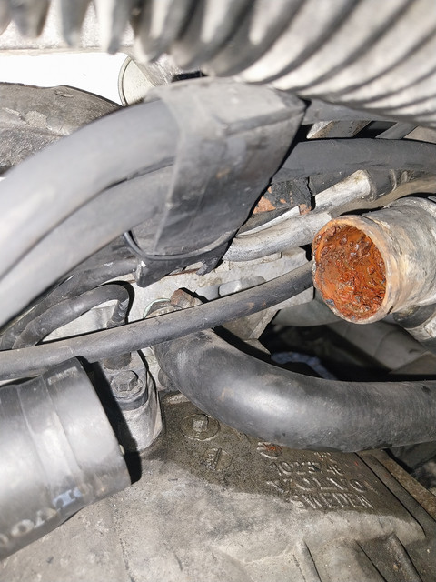

You mean the metal pipe that goes around the engine? I am considering replacing it, considering the levels of rust I have found in it - see below.kcodyjr wrote: 10 Sep 2024, 14:28
You're having strange cooling issues. The pump, and the piping near it, is the next thing I'd look at. While doing the radiator. Since you'll have it open for the pump, do the crank and cam seals too if there's even the slightest oil dripping from them.
I would do the kind of flush where you put something into it and run it, to scrub out the insides, before taking it apart. With the thermostat removed.
As for the flush, I dumped the cleaning product into the reservoir, drove for around 30 minutes, dumped out the gunk, waited for it to cool, then ran water from a garden hose through everythjng I could disconnect: heater hoses, thermostat housing (still the old design), radiator hoses, and expansion tank.
Only stopped when the water came out crystal clear about an hour later. This system had unseen levels of crap (curse people running tap water for years), but I'm still disappointed that something was left behind go clog stuff.

Yeah, replace what you can see is rusted.
Did you open the drain on the block, remove the thermostat and reassemble the housing, then force water through the engine while it's free-flowing? If not, you may have cleaned everything BUT the coolant channels in the block.
With the sight of that rust I'm doubly suspicious of the pump.
