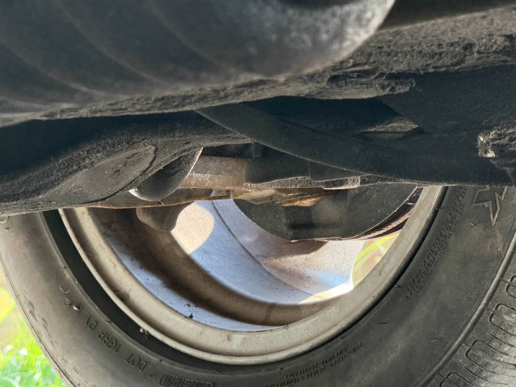

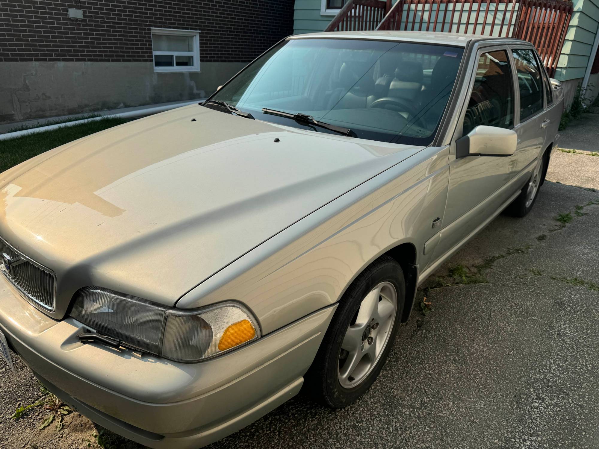

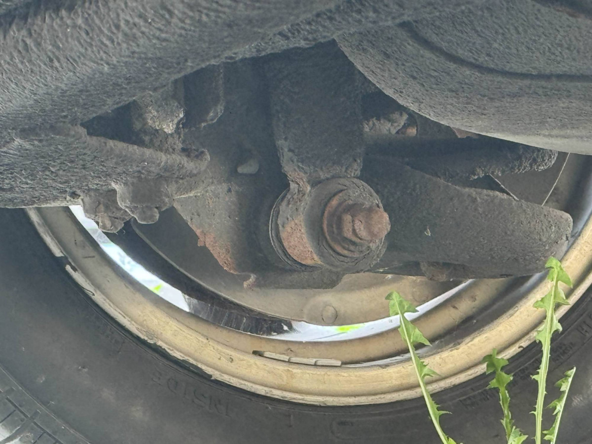

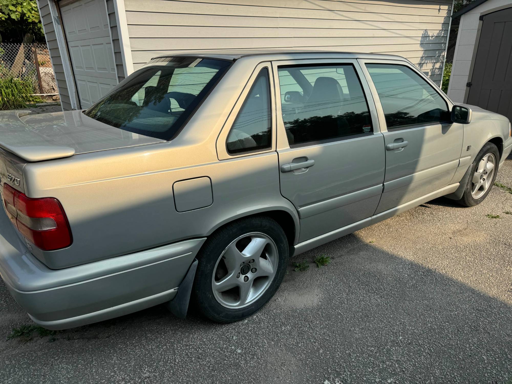

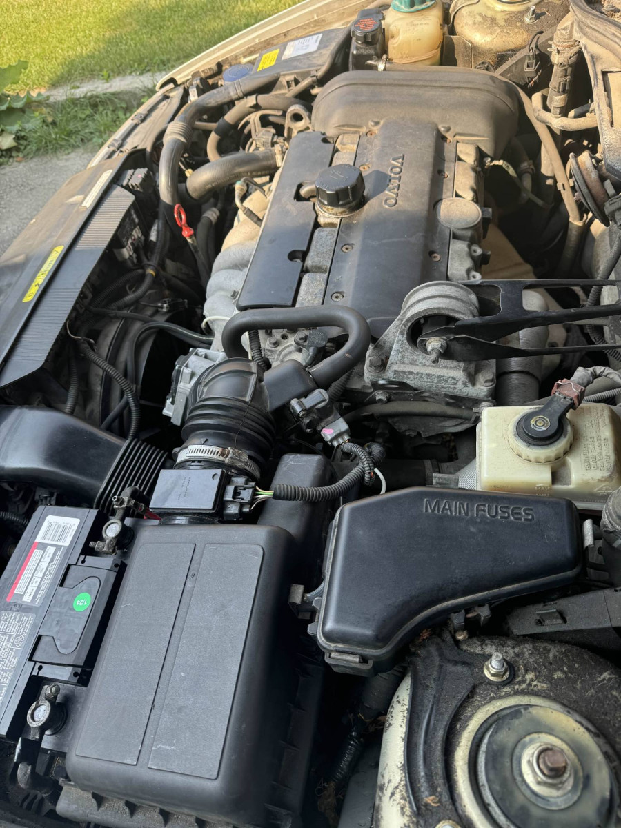

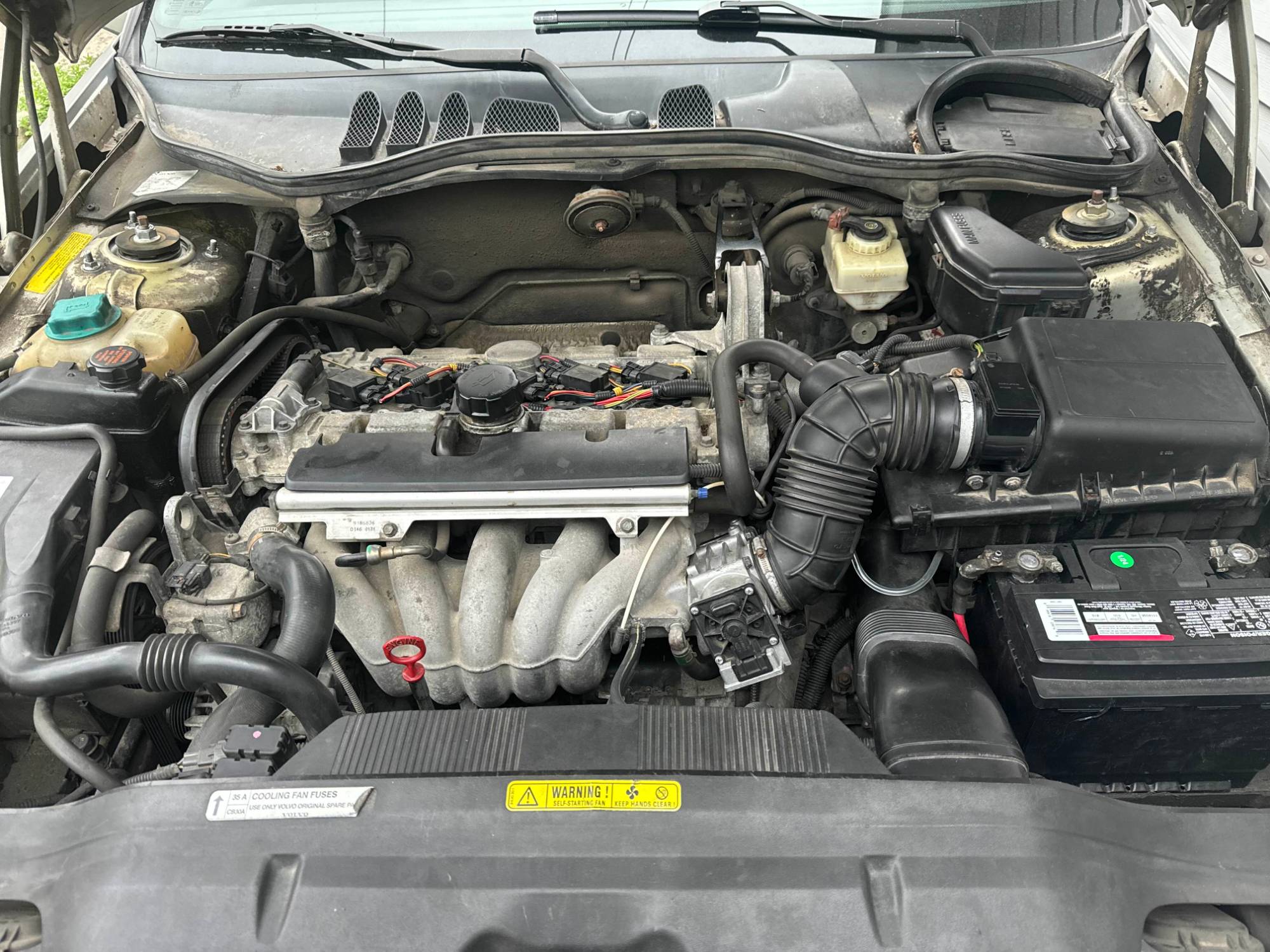

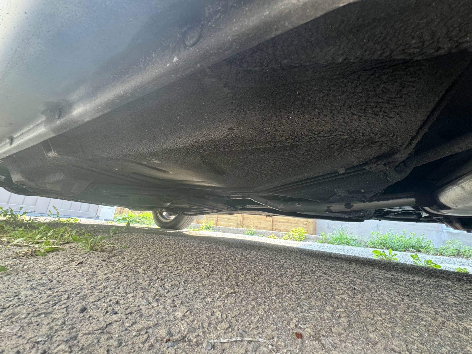

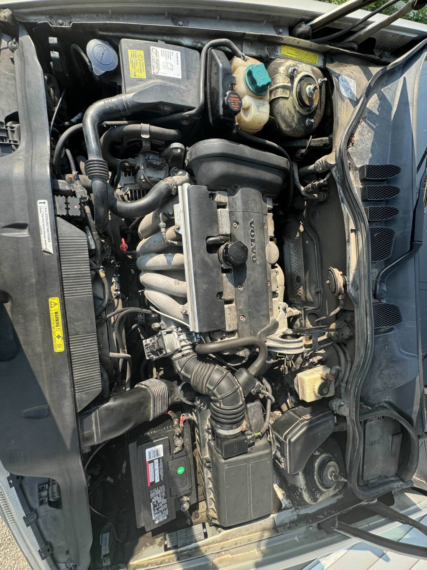

I also took a couple of photos, so if theres an effective way for me to upload it i'd love to share what she looks like.
Thank you for your time!

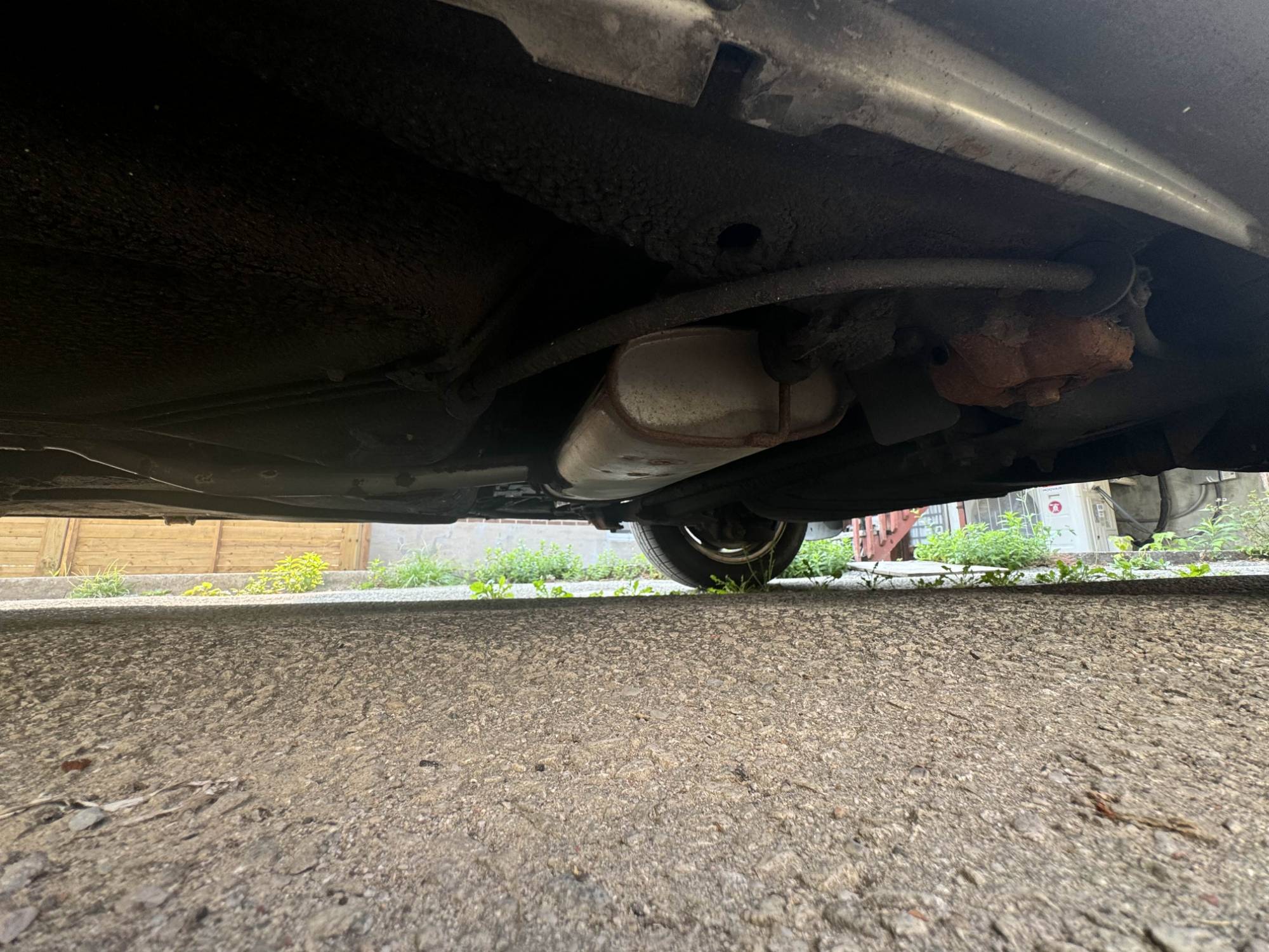

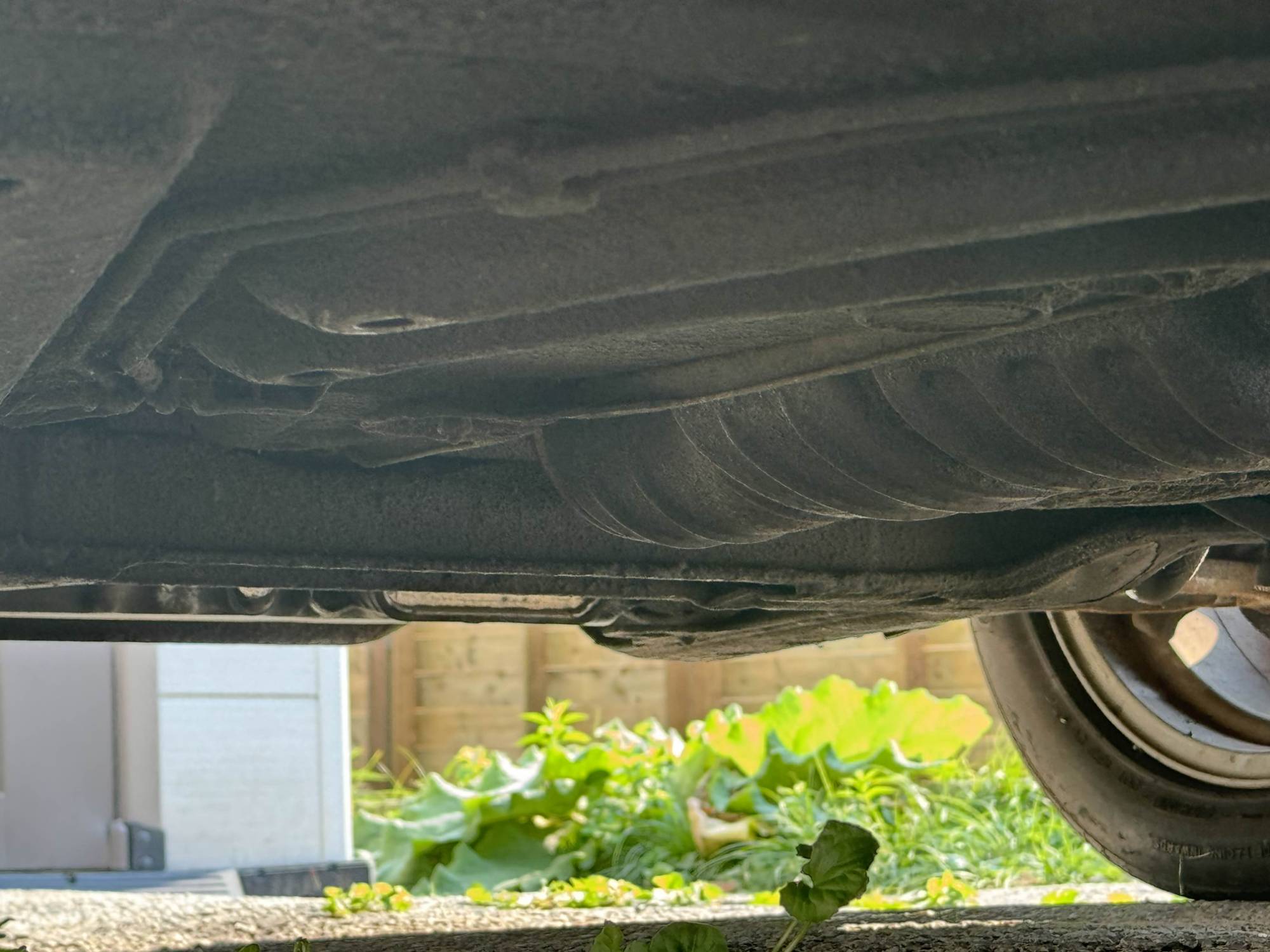

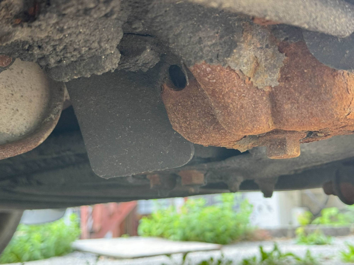

Car looks in really good shape for an Eastern car. A few small areas of surface rust that are easily treatable underneath but really good.
I like the NA engined 2000 cars. Many will warn you about the 5-speed auto is a bad trans. My buddies I worked on still has the original and his car has about 335,000km on it. The similar 02 XC70 I am working on has 385,000km on it.
I know there was a place that parted out Volvos and other cars in the Toronto area. Worth also joining the P80 group which has a lot on members over in Ontario who may have parts or leads on what you need used.
