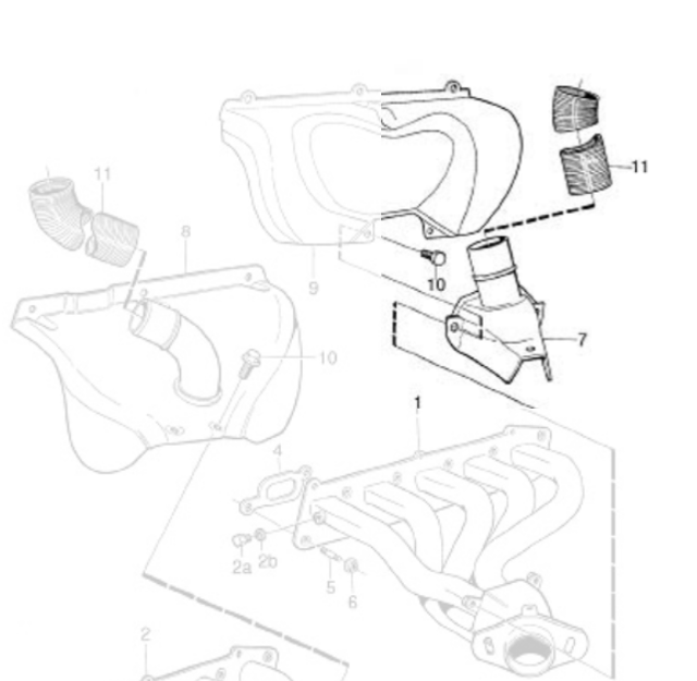

Hy guys,
i hope you're all fine...
I have a question about a steel hose on the cover over the manifold. My car is from july 1995. I don't really understand what this part is for; May someone could tell me ? Do i need this on my egine, and if, where does the aluminum/paper hose plug into ?
Thanks a lot.
Manov
850 exhaust.png (157.31 KiB) Viewed 286 times

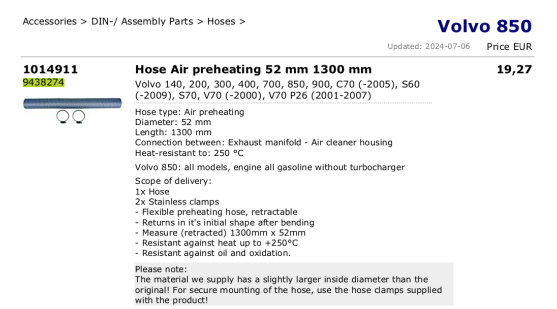

Found.
Capture d’écran 2024-09-15 à 18.15.55.png (140.55 KiB) Viewed 283 times

Manov, hello 👋 friend. Glad you found this. Just curious if there are French parts diagrams and you posted the English screenshot for our benefit? Or are French language diagrams not available?

Salut Matt !
I've taken boards as i've found them. Generaly, i use US ones (Volvopartswebsite.com)...
I hope all my MVS Friends are fine !
