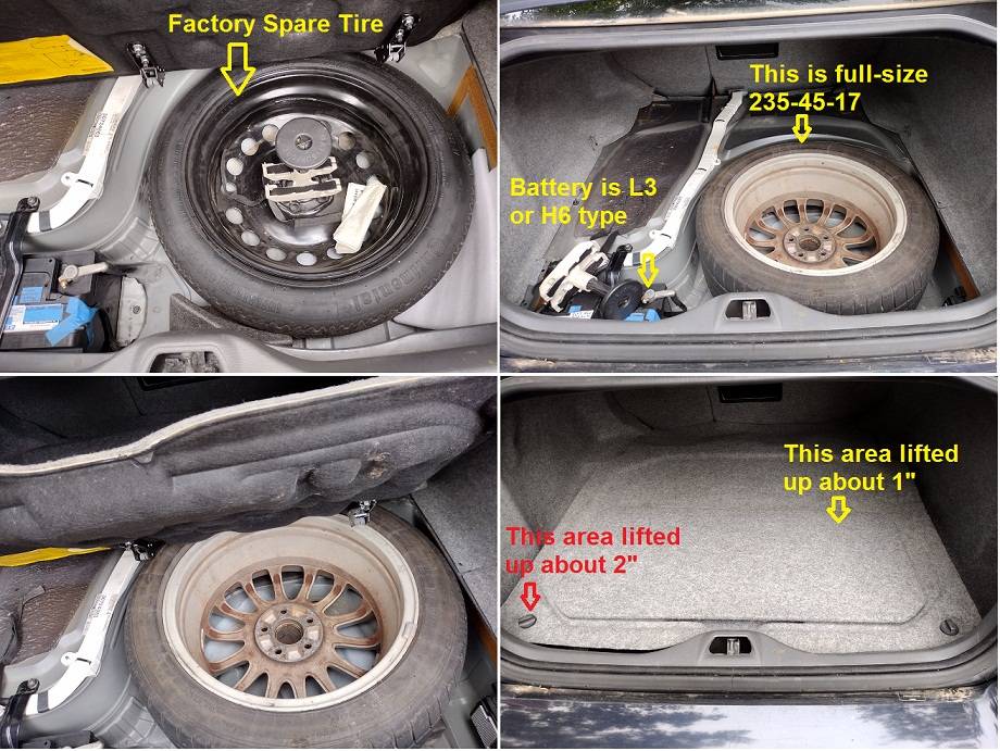

Update,
I had a little time today so the 2007 S60 with 235-45-17 tires and L3 (H6) battery was the guinea pig...
Attached is the photo of the factory spare tire vs full-size tire 235-45-17.
The 235-45-17 fits in terms of diameter but the thickness (the width) of the tire pushes the trunk
plywood floor piece upwards as shown.
So, if you truly wants FS tire, then you may have to live with the lifted floor issue.
Removing the foam piece under the tire may help with the lifted floor issue (I have not tried this yet bc I put
the spare tire back in the trunk).
HTH.

I have a full size spare 215-65-r16 in a 2004 XC70.
After taking out the foam piece under the spare and the storage bin the floor closes without issue.
It's hard to take out with an H8 battery. With an H6 probably better.

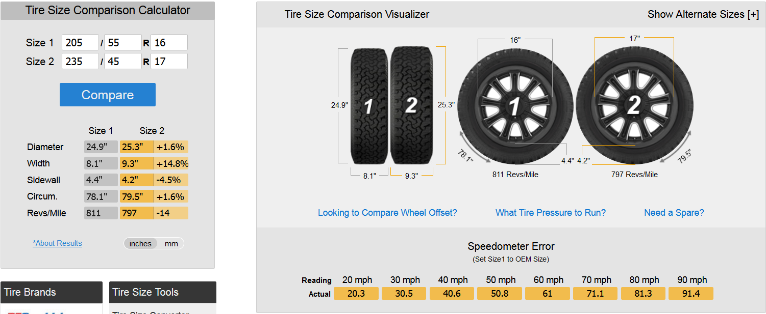

Our 2007 S60 2.5T came with 205/55ZR16. The 235/45/17 came from another S60, was told it was a T5 model but forgot what year. Both those were factory sizing for the 2007 S60 2.5T. The 16" would fit better in the trunk and could be used with the 17" for short duration if not an AWD car.
https://www.wheel-size.com/size/volvo/s ... m-25t--207
https://tiresize.com/comparison/

The tire sizes listed for most P2 S60 cars are:
- 235-45-17...Profile = 235 x 0.45 = 105.75 mm
- 205-55-16...Profile = 205 x 0.55 = 112.75 mm
- 215-55-16...Profile = 215 x 0.55 = 118.25 mm
P2 V70 is mostly 235-45-17, XC70 is mostly 215-65-16 and 215-60-17 per Tirerack.com.
So, if you want FS tire, then you should look at what you currently have in the 4 tires and debate yourself:
- Exactly the same tire profile vs
- "205" tire so the floor does not lift up too much, but you may have to deal with rolling diameter differences if you ever use the spare tire.
For now, I just live with the donut spare tire...
