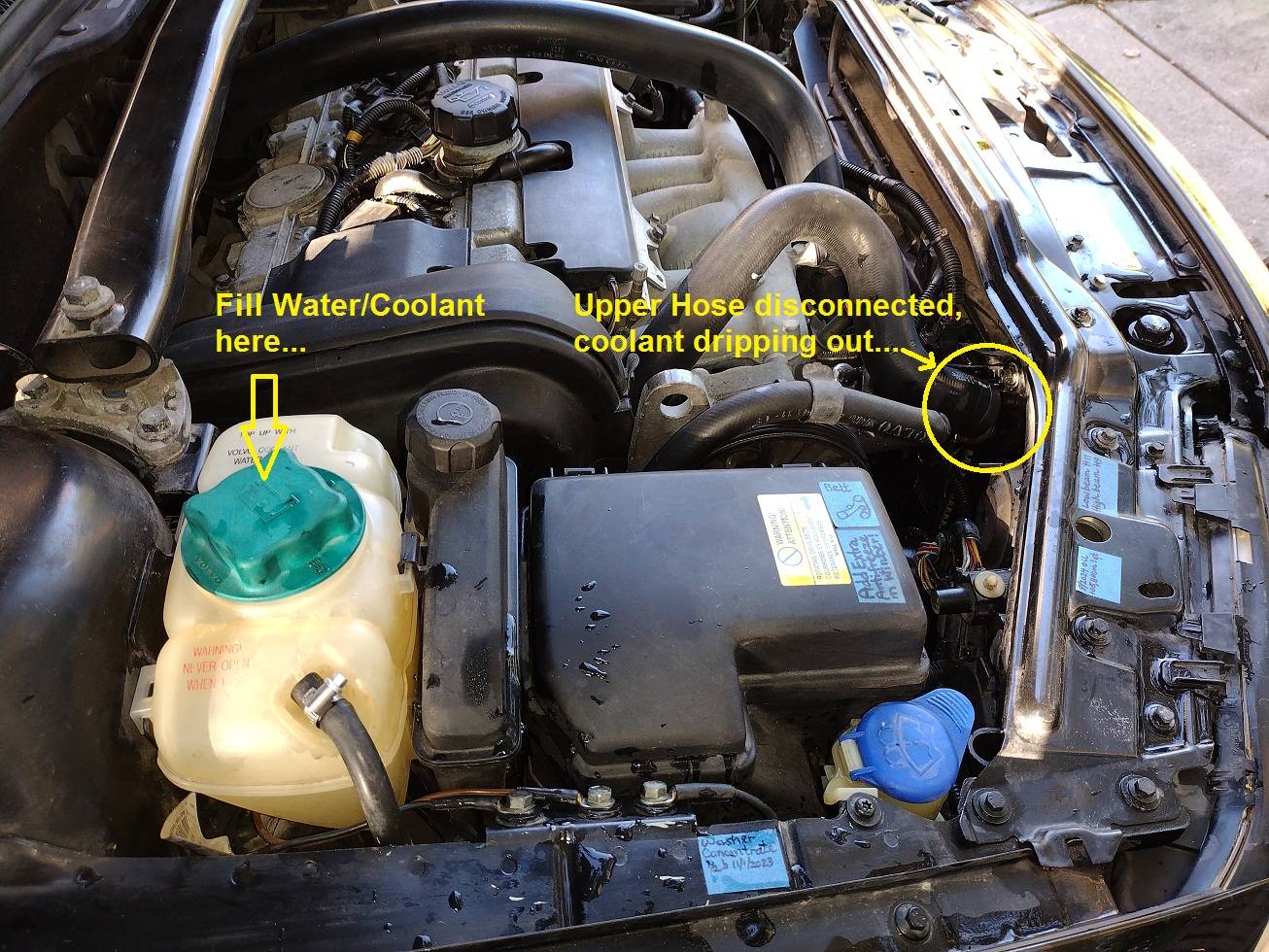

OK,
I have done this on multiple Volvos over the years by disconnecting the LOWER rad hose.
I am getting older and hate dealing with the LOWER rad hose.
This is the DIY via UPPER rad hose, which you can do in your Tuxedo lol...
Tools/parts:
- Definitely need the 7-mm socket for the hose clamp bc it is in awkward location.
- Distilled water (Walmart, Target etc.): 2 gallons; about $1.50/each gallon.
- Prestone Green concentrated coolant (do not use the premix 50-50): 2 gallons; $10.50/gallon @ Walmart.
Per the thread below, cooling system capacity is 8.8L / 9.3qt:
viewtopic.php?t=97040
- Take this opportunity to remove the coolant reservoir to clean it (optional).

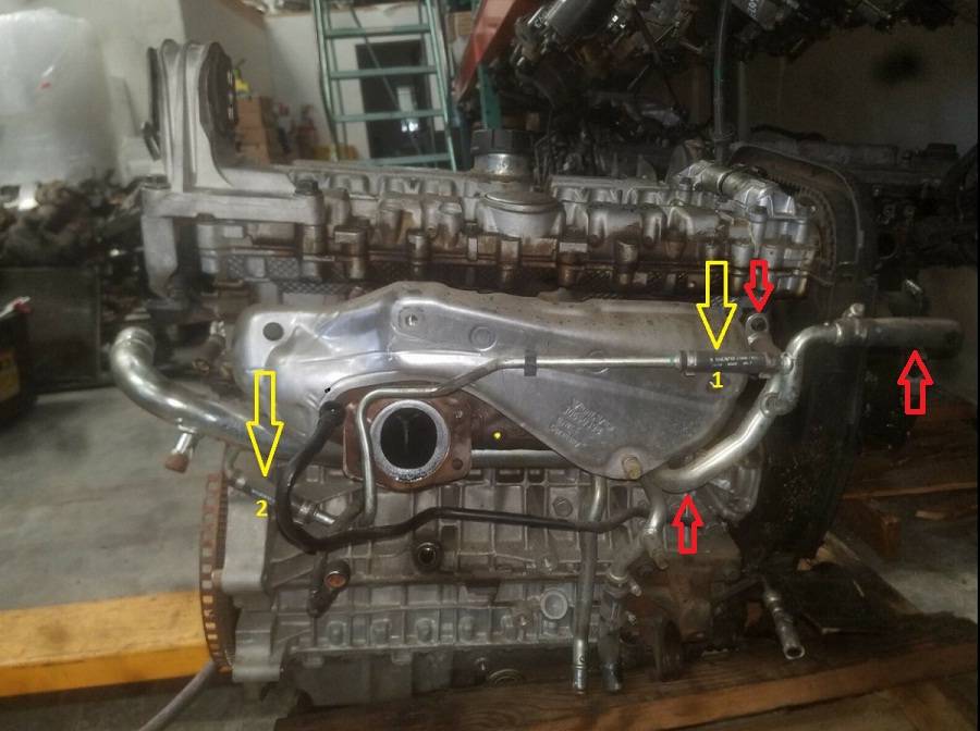

- Anyway, once the UPPER rad hose is d/c'd, pour distilled water into the reservoir.
- Distilled water will flow from reservoir ---> bottom hose ---> engine block (RED arrows).
- Some distilled water will flow via the small round hose (YELLOW arrows).
- After one gallon of distilled water, you should see clear water flowing out of the upper rad neck.
- I added another 1/2 gallon of distilled water, so total about 1.5 gallons.
You can use the entire 2 gallons too. But I saved 1/2 gallon for later use.
- Now, the block contains mostly distilled water.
- For the typical 50-50 mix, you need to use ~ 4.5 qts at factory. This is not factory, so I improvise.
- After 1 gallon of pure concentrated antifreeze, you will start to see the green color coming out of
the upper rad neck. Then I pour another 1/2 gallon pure concentrated antifreeze, so now I have
used 6 qts, some of which will continue to flow out of the upper rad neck. When the level in the reservoir
is just above Max, I reconnected the UPPER rad hose and tighten the clamp.
- Test drive around the blocks near your house, wait for engine to cool, then if necessary, add more coolant.
- The reservoir now contains pure concentrated antifreeze, but no worry, after some hundreds of
miles of driving, it will be mixed.
- Best is to do it before winter, such as now (Sept-Oct) bc in a few months, it will be nicely mixed.
- Then after a few months, check the coolant strength.
- This is kind of "cheating" but it works for me, it is much better than fooling around with the LOWER rad hose.
- Sure this is not a perfect science but it works for me.
HTH...

Some comments:
- I agree, accessing the lower rad pipe is a hassle especially with the splash guard in the way. It's practically as hard as changing the oil.
- Draining 3-4 gallons out the top radiator pipe will make a big sticky mess in the engine bay and on the ground underneath. Presumably you cleaned up with hose water or something?
- Similarly, please take a few minutes to cover/protect the alternator if you're going to try this method.
- I don't use green coolant, I use Zerex G05 or Volvo coolant which are the same formulation. Either of those is about $20/gallon for concentrated.
- This method will increase the coolant to above 50:50 mix (more coolant, less water) which should work out just fine but I don't like the idea of not knowing what's actually in there.
For me, I'll keep accessing the lower rad pipe, flushing the system completely, then refilling to known 50:50. But this method may be preferable for some, I can see that.

- Actually I did it slow with plastic container to collect the coolant/water that flows out the upper rad neck.
The flow is actually very slow like a trickle, so no spill to alternator.
- Even with the lower rad hose technique, there is also uncertainty regarding mixture %.
- I have done it this way a few times and 2 months and thousands of miles later, the coolant tester checked it out to be ~ 55% coolant and 45% water. Good enough for me.
