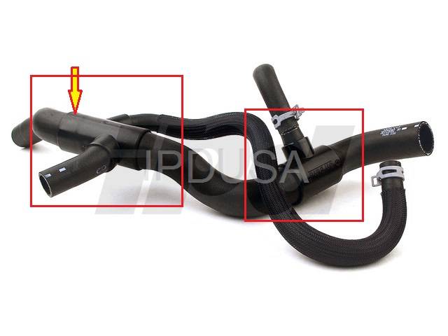

We had those cracks on our 08 C30 T5 and replaced both the Tank & Cap at the same time. Another problem area is the Octopus coolant hose where Volvo used glue for a split plastic coupler to squeeze the hose for clamping. The glue areas begin to crack and you won't see the leak as it's buried in the middle of the engine. The leaks are also very very small and progressive so the problem can go for sometime.
We cut the hose for ease of removal then examined the construction after the fact. Discovered could have just removed the pressure fit coupler and added 3 hose clamps as the hoses were still good. Arrow on glued seam.
Upper Radiator Hose Auto Transmission - P1 S40 V50 C30 C70
