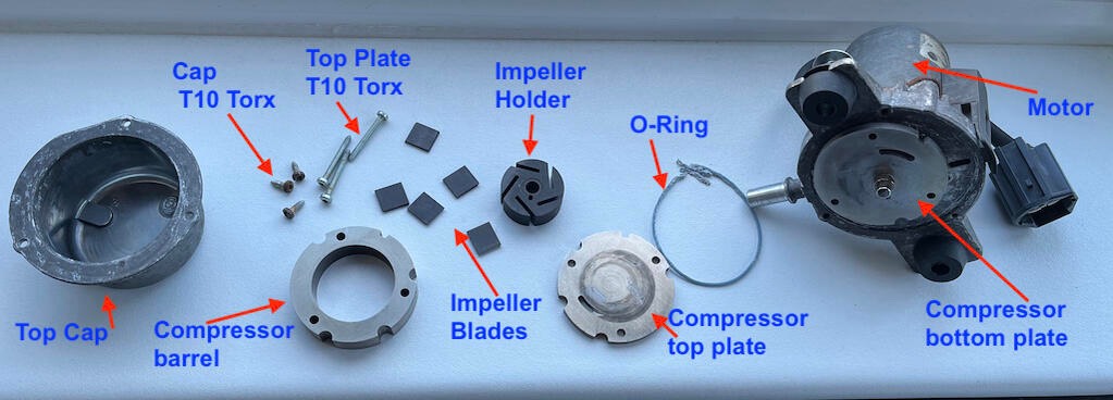

Just a shot in the dark in case anyone has ever seen or heard of them.
I tested the brake booster pump (OE 009428081) on my car and it didn't spin. Curious, I opened it up and the fan vanes are all busted, otherwise the motor and everything else seems fine.
If I could just buy the vane it would appear an easy fix....
Edit: I should have written impeller blades but I guess everyone understood what I meant.
It's actually the impeller blade holder that disintegrated. It seems to be made of bakelite or some carbon-type material.
I found a good used one as I didn't want to wait a week or so for a new one to arrive. I'm working in my driveway and between looming rainclouds and soon-to-be-here cold weather, I need to get the car back in order and on the road asap.

How did the vanes manage to get busted? They are made from a heavy metal and look indestructible to me

those blades appear to be carbon filled nylon.
it wouldn't be hard to make your own from carbon sheet and epoxy.

The blades are metal
