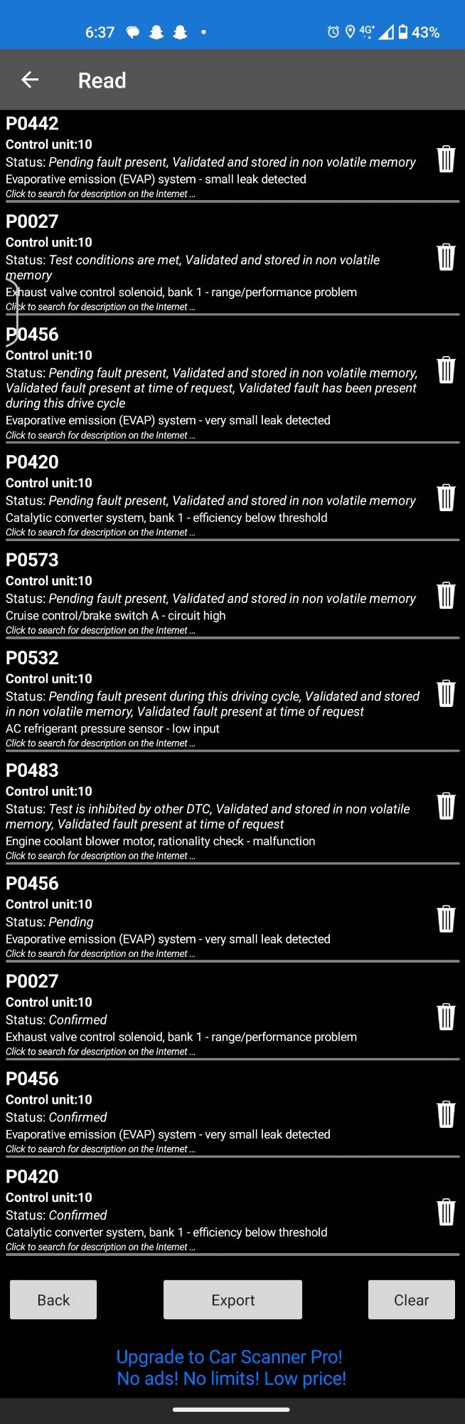

I bought a 2007 XC70 with 227k (yikes) miles on it for $800. The car struggles to find it's pep, but doesn't stall and starts everytime (knock on wood). It also had some check engine codes that we cleared before driving it home. I've attached the codes in a picture.
The car needed to be driven ~40 miles home, and it made it with no check engine lights back on (later I drove it another 5 and still nothing).

I don't see any bug read flags in the codes. Exhaust leaks and vacuum line leaks could account for most of them, but most importantly is probably see which ones come back.
