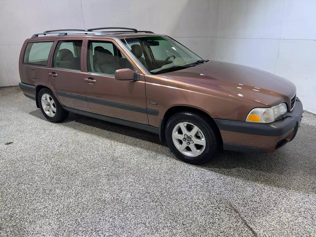

I'm new here, looking for advice on a car. I found a 1998 V70 XC with 68,000 miles, clean carfax, seems to look good. I've never owned a Volvo, but I'm very interested in it. What are things I should look at or ask the dealership about the vehicle? Any pros/cons to this year of car? It's a few hours away from me, so I haven't had time to look at it in person. Claimes to have replaced brakes, steering rack, and 4 new tires plus oil change. I'm worried about rubber/hoses because of aging, anything else that might need replaced?

Tough call. I wouldn’t spend more than $2500 on that, though
The 1998 was the first model for the viscous coupling AWD and most of the rear suspension parts and AWD PARTS are not available new, junkyard parts only.
Fuel pump replacement calls for dropping the entire rear subframe which can crack or be a real fight due to seized bolts.
I fought through my 99 AWD in a thread here called the Resurrection of Ekaterina

$2,500? That seems really low considering everything else I'm finding online is $3,000+ with double or triple the mileage. I'm sure I can't talk them down that much. There really aren't any aftermarket rear end suspension parts available? That seems insane to me...
Aside from that stuff, are the rest of these cars pretty solid?

I have owned this exact same car, although with higher miles. It cost me a fortune to keep the AWD alive, and like Abscate says, at this point parts availability is a real problem.
This car looks very well taken care of, maybe it was even garaged all it's life. But at some point the steel fuel lines on top of the gas tanks will corrode, at which point you need to drop the rear sub frame. Same thing for fuel pump replacement, but again you might be good for a while given the low miles.
Not trying to scare you, but these first gen AWD Volvo's are not for the faint hearted. You need some deep pockets and gain a lot of knowledge here.
It's a very pretty car though, I can see the temptation.

The AWD cars are a challenge. Abscate had a few challenges with his AWD mostly due to lack of parts availability.
I had to pull the whole rear end out of the car to replace a corroded and cracked aluminum sub-frame on my 2000 V70R. Lots of pictures and notes in there. Fuel system and bushes are the worst issues as none of the fuel lines, rubber hoses, several bushes or fuel pump are available from Volvo any more. Even things like the brake back-plates that the parking brake mounts to has been NLA for about 10 years. So lots of junkyard searching. The other option is if issues fail at the rear, then you could do what on member did and remove the whole rear end and install the FWD car rear suspension.
I had a 98 and it was a good car once I got it sorted and good to drive, and great in bad snow. However, if you don't do your own repairs, I would advise against it. I guess if it is cheap enough, then run it till it breaks and you are maybe ok for a few years. Rubber hoses and fuel pipes are the largest concern, as is unrealistic owners wanting a high price for a low mileage car.

Any vehicle this old you need to look at the years and ignore the miles. The seller may want to jack the price because of the low miles, but I think it's a suckers bet. A car from the north east is likely to have corrosion and you are right about rubber parts needing replacement. Rubber pasts include suspension bushings, gaskets and window seals as well as hoses (including brake hoses).
I would also question why miles are so low. Did it set for many years (bad for rings and valves)? Did it get all short trips (bad for parts that do not get warmed to operating temperature)? Try to get service records and Carfax.
If you get it, plan to change all fluids and filters, including fuel.

It could be a flood car, and with low miles it may have changed hands at dealer auctions for years to finally find a home at this dealer. A sucker looking for a sucker. Pure speculation, but a possibility.
