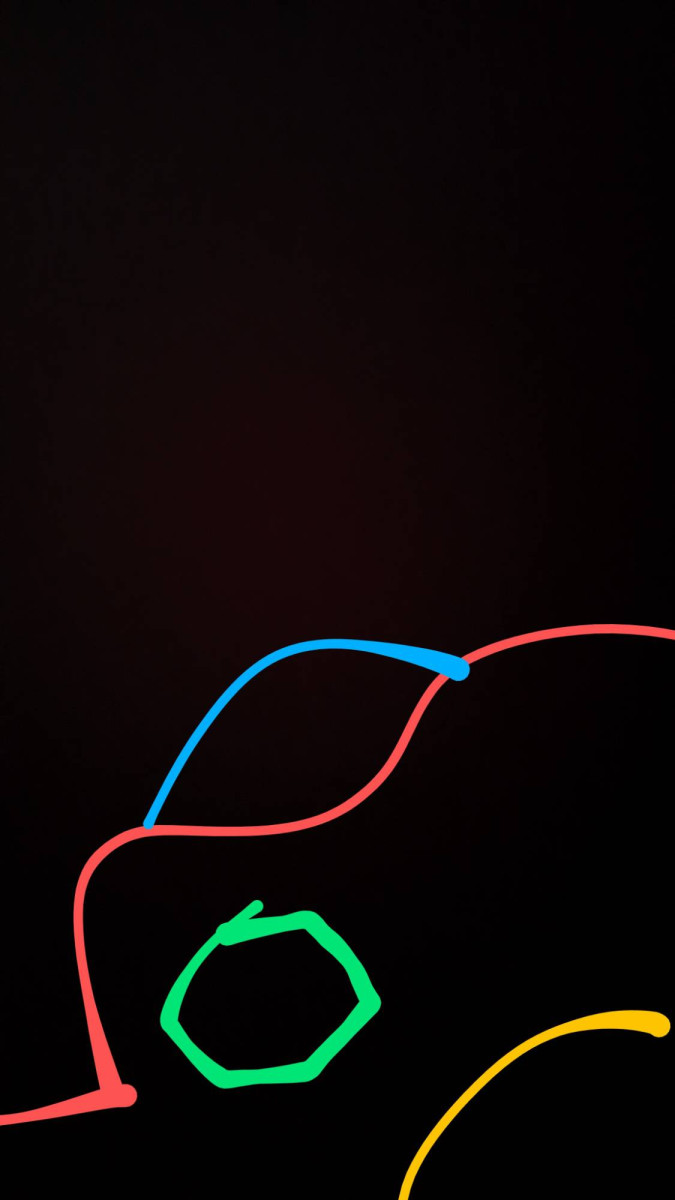

BlackBart wrote: 04 Oct 2024, 15:50 Are you describing something like a half-moon gap in the block above the pan flange?
Yes, what your describing sounds right. I'm attaching a drawing of what I remember it being. The red is the pan, blue the gap, green the nut and yellow the filter. Your idea of what it looks like is probably better than mine lol

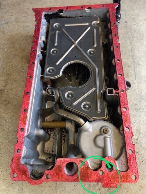

Show me on this picture where that gap you describe is.
2003 XC 70 (sold)
cmayo1
Posts: 83
Joined: 28 Sep 2024, 14:15
Year and Model: 2007 XC70
Location: New Hampshire
Has thanked: 51 times
Been thanked: 9 times
Post by cmayo1 »
Here it is:

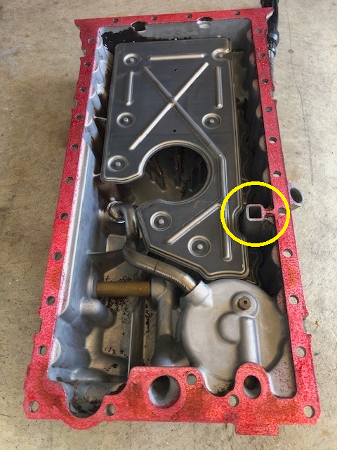

Post by MoVolvos »
Is this square the PCV return?
(EDIT: Is it critical to get the red material on the entirety of the square?)

MoVolvos wrote: 04 Oct 2024, 16:54 .
Yes to both. Start your own thread if you have more questions :D
