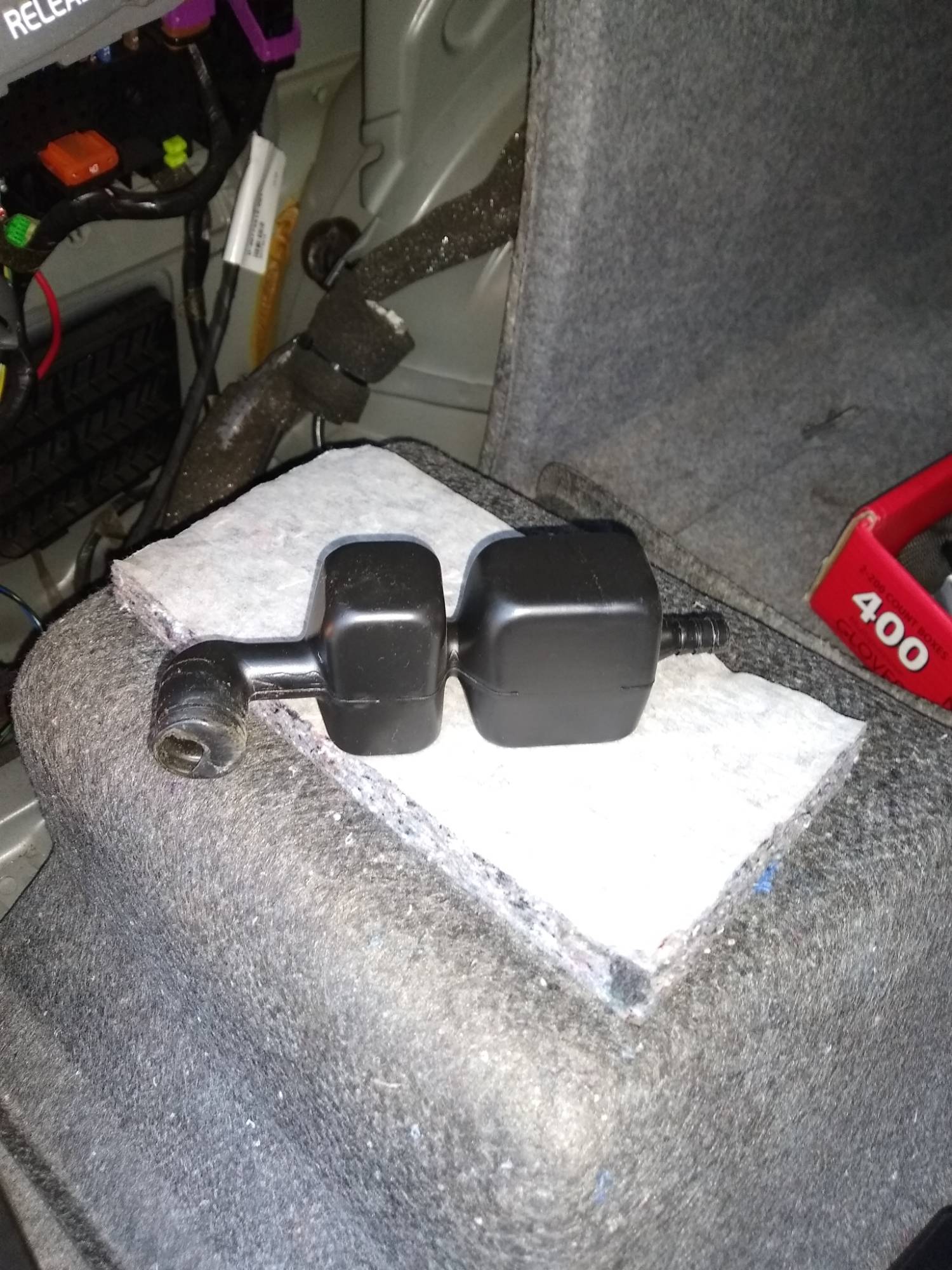

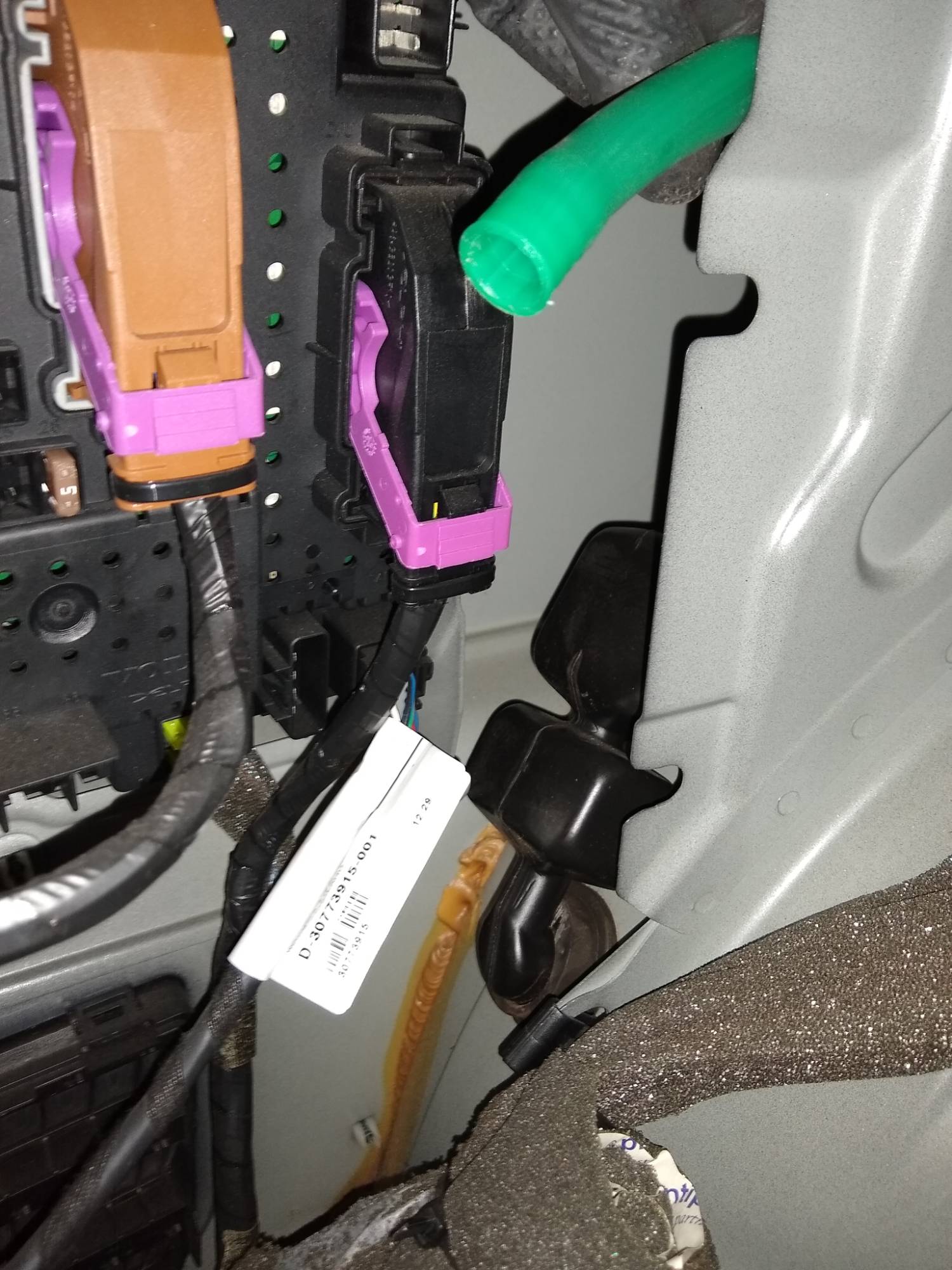

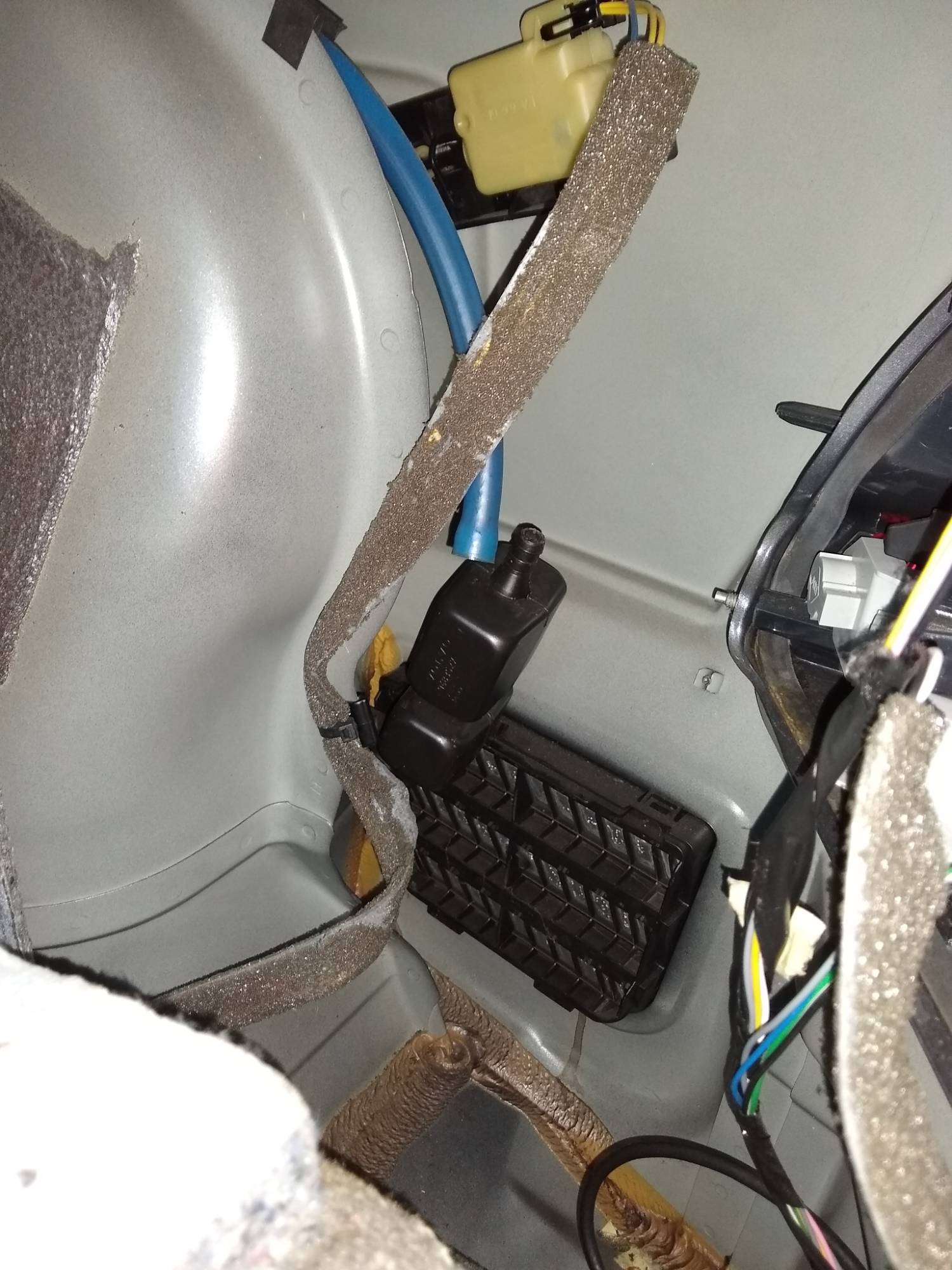

It was the blue passenger side back sun roof drain that was clogged. Some compress air or curtain wire pushed in from the bottom should clear it. Careful not to push too hard so it doesn't detach the tube at the top or else the headliner has to come out.

Passenger side.
Driver's side.

Passenger side.
Driver's side.
