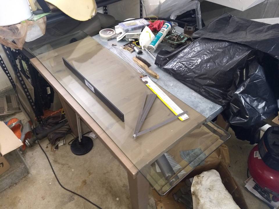

You are doing it wrong. First off, this is a Swedish car, right? So you MUST use IKEA kitchen table!

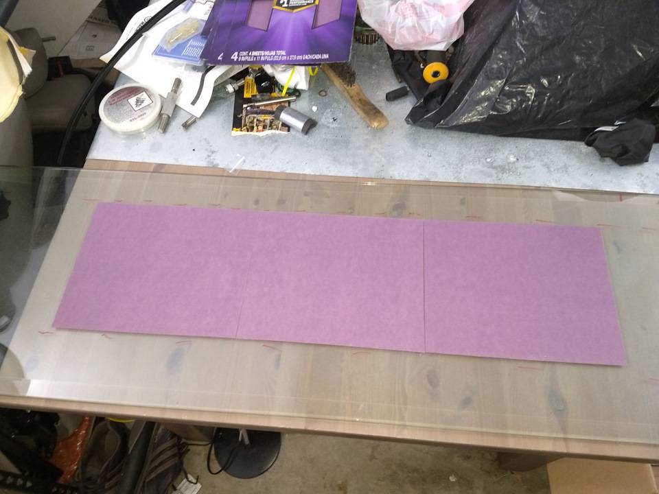

Also a polished 3/8" or thicker glass on top of it, and let it sit for a few days to relax and straighten. My setup was under 0.05 mm (0.002") flat in the work area.
Grit 320 sandpaper. WD-40 is must, IMO.

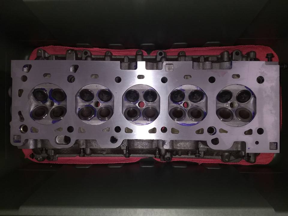

Also Dykem Blue is good to control the results.
You want to remove all dark spots (depressions in metal) between fire ring and cooling channels. This is where gaskets fail. Also no dings in fire ring area at all.
End result.
You head seems to be warped a lot, or maybe sanding setup is not flat enough.

@MoVolvos @matthew1 @vtl Here's where I finished. Still one small black spot between the middle cylinder and exhaust sided coolant passage.
https://1drv.ms/i/c/7045d4cf7fedc911/Ee ... Q?e=pjKIhf
I guess I could keep going, but it seems like I'm getting close to taking too much material off the head and the remaining divot is ~ 0.004 inch deep, which seems within acceptable spec per Volvo Manual.

Yea, keep sanding. You want a flat head between cooling passages and fire ring, or coolant will erode the head/gasket. I see another low area left to the next cylinder.
