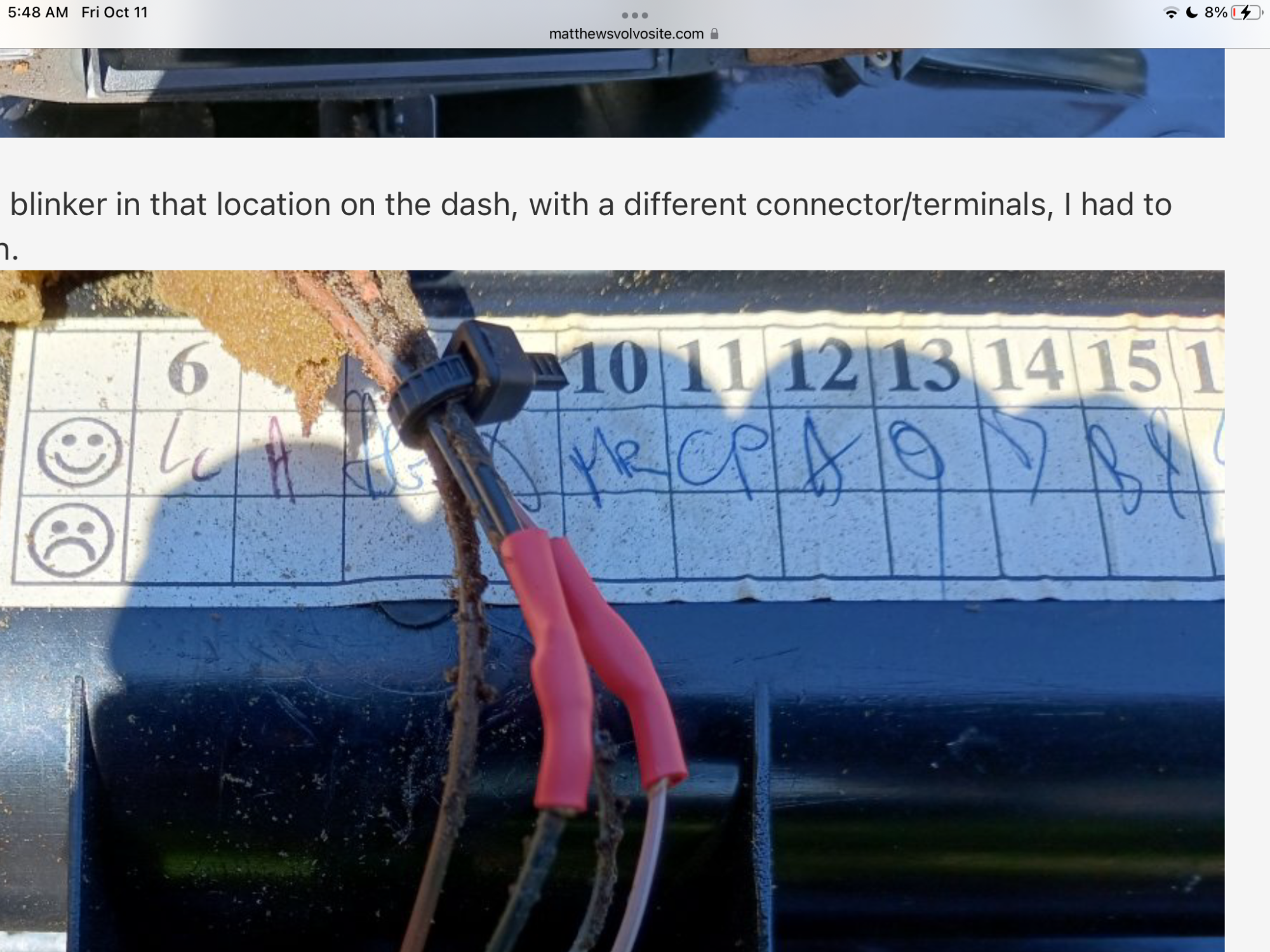

That third plug (The "C" connector) only has 4 wires going to it. 2 are from the duct sensors and 2 are from the "solar sensor" located up on the dash. That solar sensor shares the location with the anti-theft indicator.
This is basically all of the wiring for that "C" connector.
Which was easy enough to install.
Since the old harness just had the blinker in that location on the dash, with a different connector/terminals, I had to swap the sensor from the old dash.
I just spliced the wires for the anti-theft light, as it wasn't worth pulling them out all the way back to their source on both harnesses.
After that, I was able to properly wrap up the dash installation.
