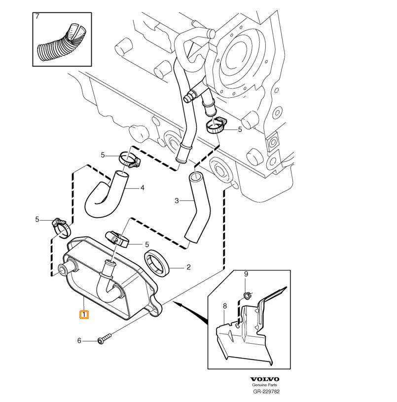

Don't bypass the coolant tank. As coolant heats, it expands. Tank has air at top which is compressible but without that, the fluid will blow off a hose at best. Pressure also raises the boiling point. You can't run the car at normal engine temps with impaired cooling.
I see you are referring to an oil cooler. Not sure what that is. My s60 has a coolant radiator, and a transmission fluid radiator. The oil is cooled by coolant cooling the engine and thereby the engine oil.
So what's an oil cooler?

Post by lrock »
EngineeringBloke wrote: 06 Nov 2024, 14:07 Don't bypass the coolant tank. As coolant heats, it expands. Tank has air at top which is compressible but without that, the fluid will blow off a hose at best. Pressure also raises the boiling point. You can't run the car at normal engine temps with impaired cooling.
#1 in the diagram, rear of the engine, lower right. attached to oil pan
