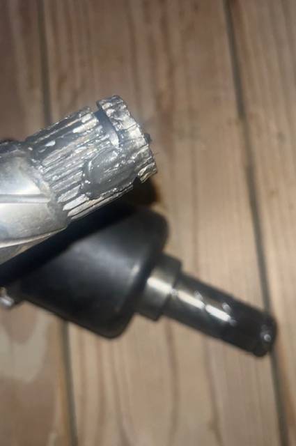

The very tip of that CV got shredded because I'm assuming I didn't jam it in all the way like I thought I had. Now I'm worried I've fucked up the splines of my transmission as well. So I wanted to test that with a different CV axle that didn't have stripped splines. That one won't go in either. It's also been a struggle to take out so I'm not sure if it is stripped transmission threads or just a PITA.

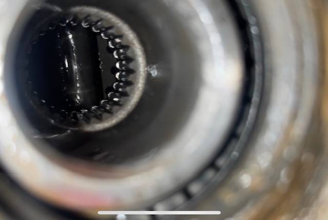

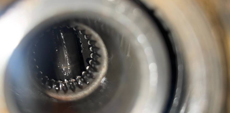

The transmission spines MIGHT be OK if they are harder steel than the axle spines. Get a bright light, good magnifier, get your head down there and do a close inspection of the transmission splines. If damaged it will only be the outer edge as this is where your axle ran.
Careful work with a file may get additional life from the transmission splines. Just dress them enough to get another axle started.

A couple screen grabs from a video I took seem to say that my transmission splines are okay. Nothing flaky or shredded.volvolugnut wrote: 04 Nov 2024, 18:25 The transmission spines MIGHT be OK if they are harder steel than the axle spines. Get a bright light, good magnifier, get your head down there and do a close inspection of the transmission splines. If damaged it will only be the outer edge as this is where your axle ran.
I removed the cup part from a bad axle and have been testing with that, and it'll lock into the splines. I think I'm now just bumping into issues with that damn circlip. I just cant push it past that first row of splines so it refuses to go in... What's the strategy for getting that into the slot?

While you are inserting the axle, try making sure the circlip has its "C" opening facing down, so that gravity drops the circlip fully into the axle slot.
Aftermarket CV axles are notoriously crappy on these cars. Sometimes the circlip is also just so poorly made that it is a bear to get the axle in or out.
The used, 25 year old axles are almost always more functional if you can find them.
- Posts: 36149
The circlips are often improperly shaped on aftermarket axles. Replace it with one from an OEM or GKN axle
There is another trick , use heavy grease to center the circlip on the axle when you push it in. You need to hear the click as it engages or it is not seated. The transmission splines are designed of hard steel so thst the axle gets borked , not the transmission.
