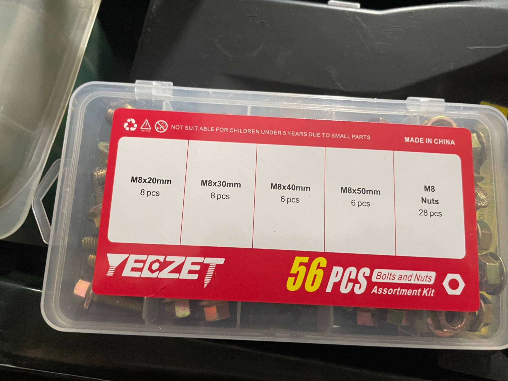

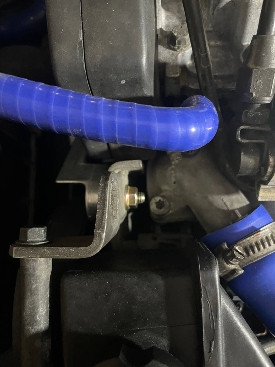

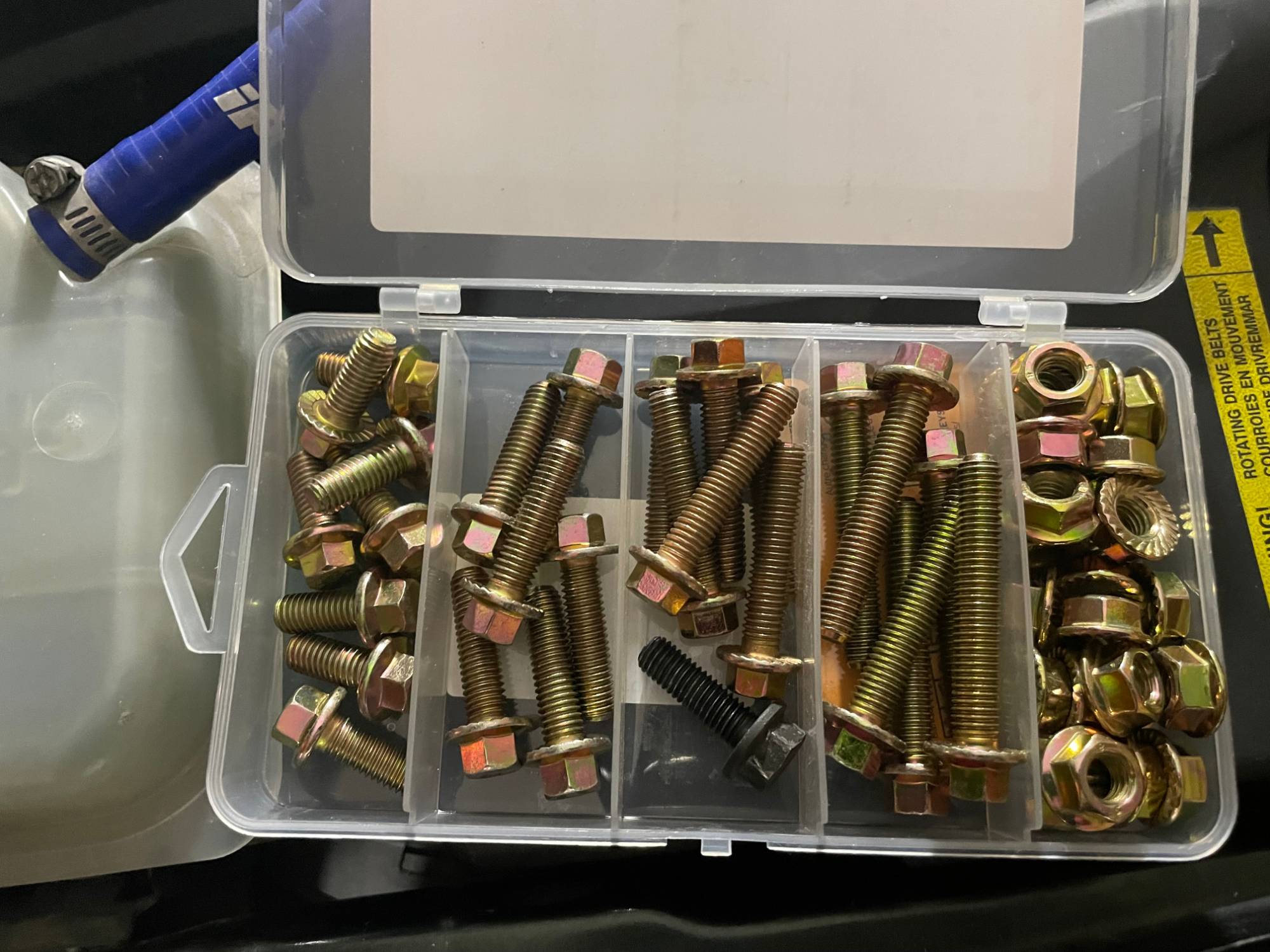

found these and they are the correct size bolts M8 i used the 30mm and put a nut on the back of it to secure it down better.
